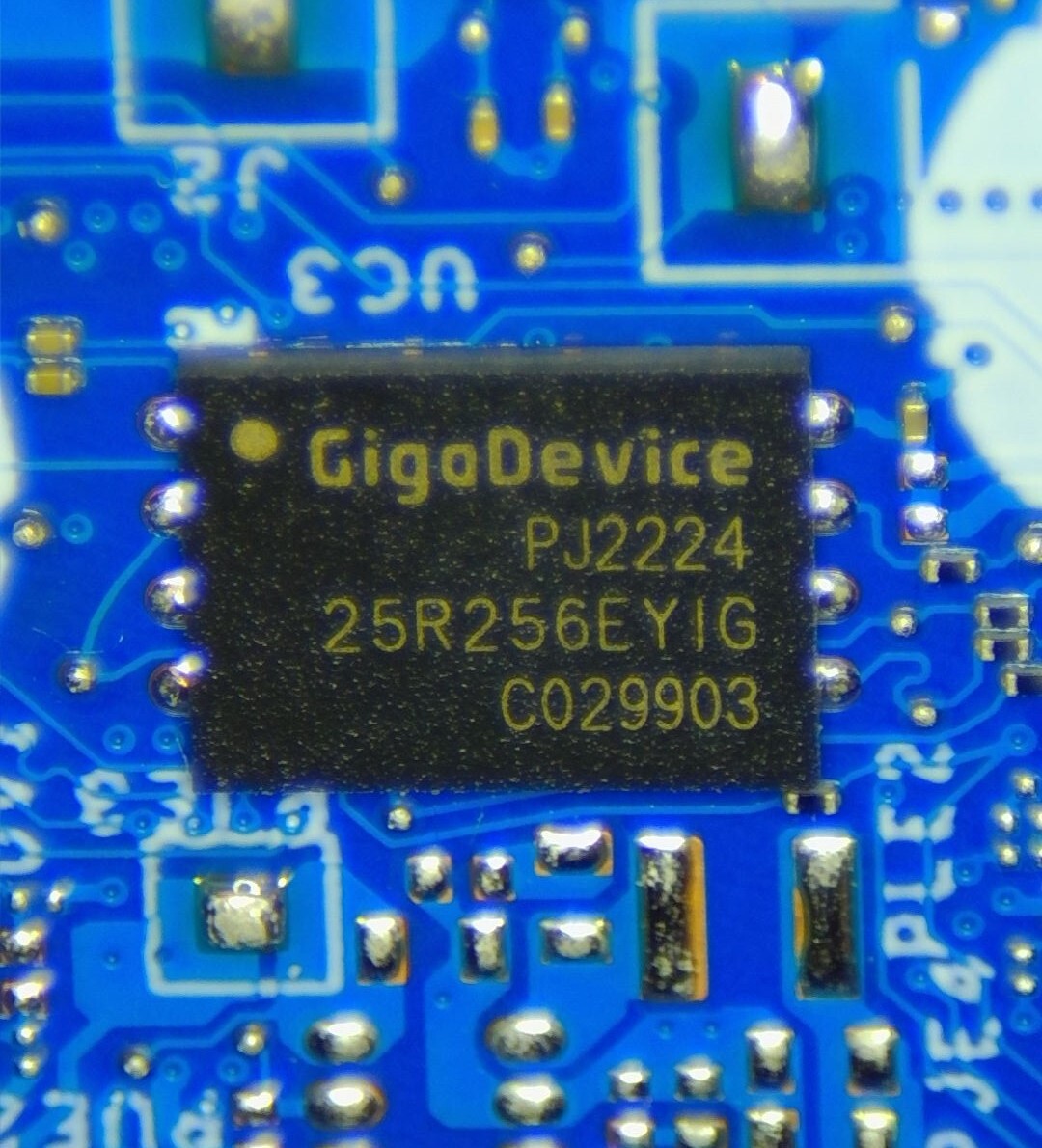

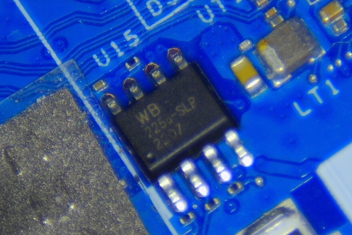

                    • Sofian75
                      • Aug 2023
                      • 85
                      • France
                      Originally posted by SMDFlea
                      Thats the thunderbolt firmware chip.Find the bios ,its hiding somewhere
                      Sorry I didn't find any schematic or boardview for this mb.
                      I attached the only 2 other SPI chips I have located, any which one it could be?
                      • hoaca388
                        Badcaps
                        • Jan 2022
                        • 11885
                        Here Click image for larger version  Name:	2024-07-03 17_16_13-thinkbook 15 g4 iap bios bin NEED - Badcaps.png Views:	0 Size:	586.7 KB ID:	3301511
                        • Sofian75
                          • Aug 2023
                          • 85
                          • France
                          Thanks, here it is:
                          • hoaca388
                            Badcaps
                            • Jan 2022
                            • 11885
                            Thanks, here it is:
                            ThinkBook 15 G4 IAP - Type 21DJ
