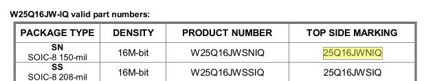

                Thats the wrong chip, its only 16 Mega bits (lower case b) . The 25Q16JWNIQ is 2MB , 2 MegaBytes
                https://cdn.badcaps-static.com/pdfs/...9fc6b7753f.pdf

                    Re: need BIOS for ASUS Zephyrus GA503RM
                    Originally posted by SMDFlea
                    Thats the wrong chip, its only 16 Mega bits (lower case b), not 16MB Mega Bytes (Upper case B)
                    That's the BIOS chip that the laptop has.
                      Is that not a BIOS chip?
                        • 22286
                        Originally posted by justme2023
                        That’s the BIOS chip that the laptop has.
                        Its not the only chip on the board.That one is 2MB, you can`t fit a 32MB bios into it. That chip is for firmware,could be for the vBios,USB4 firmware,thunderbolt or whatever, but it aint the bios chip .I hope you havn`t erased that 2MB chip,and if you did i hope you made a backup first or you`re in big doo-doo
                          Got it. Can't really find another chip that looks like that so I assumed it was the BIOS chip.

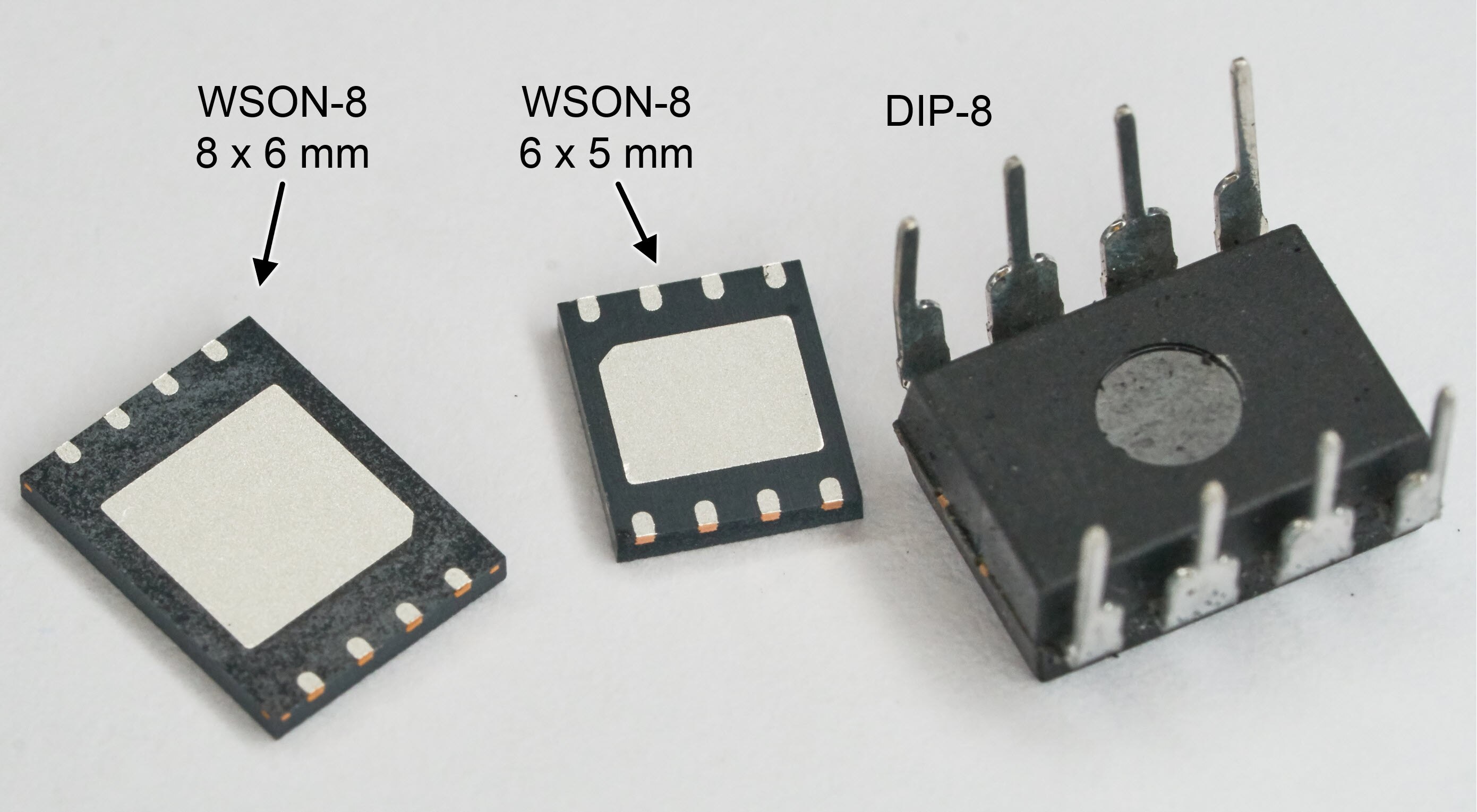

                            First of all tell us what the problem is with your laptop? Corrupted bios or it's just password locked and you are trying to remove the password by programming clean bios?
                            Maybe you didn't know but there's many different (visually too) SPI NOR flash memory chips, not only the traditional SOIC-8 type as in your picture, like SOIC-16, DIP-8, WSON-8 (8x6), WSON-8 (6x5) and so on.
                            Most probably the bios chip in your laptop is WSON-8 (8x6):
                            Edit: Yes, it's certainly WSON-8 (8x6):
