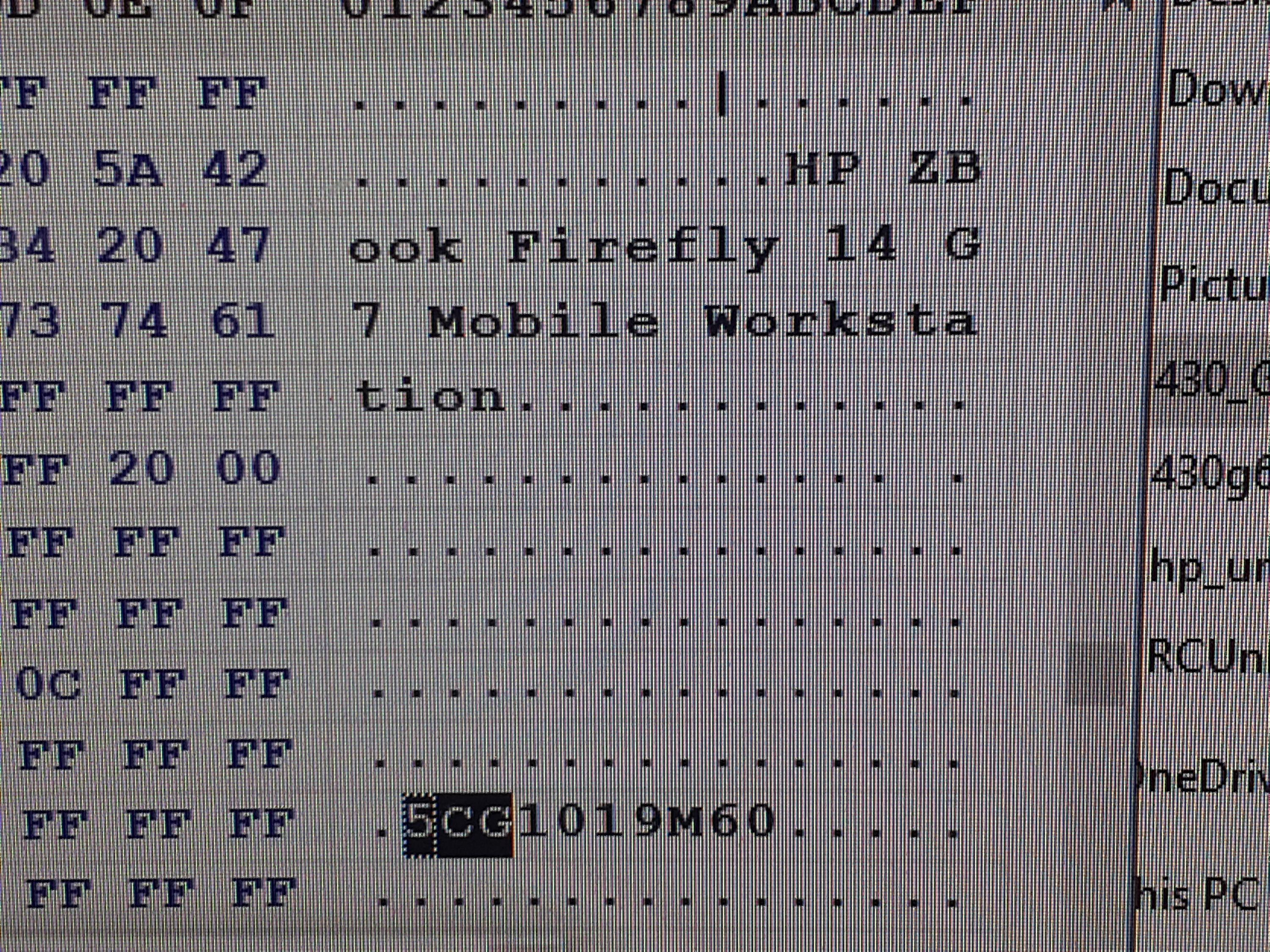

      • kudo623
        • Aug 2022
        • 56
        Re: HP hp zbook firefly 14 g7 25Q256 (32mb) Bios PW
        Please unlock this HP Firefly 14 G7 Bios Thank you!
        Please provide the system information as it looks like all my rear covers
        do not coincide with the motherboard serial number.

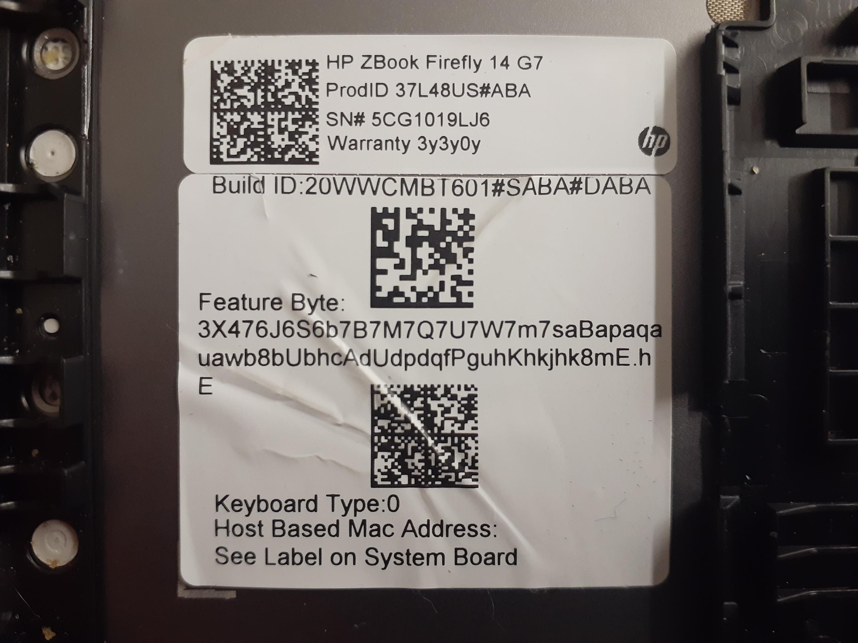

          Post photo with the label contains DMI. SN from bios is wrong. Can't find on HP site. you didn't even bother the change the name of the dump: firefly14_g8_SN5CG1416V3H-1.bin check if you didn't change covers between them from G7 and G8.
            Sorry we renamed file and included pic confirming BIOS SN as G7
              you have a way to complicate things, I asked for photo with label containing DMI and you show me something i already know. Try typing SN on hp driver site and see what is happening ... You asked for help but you don't help us with infos required in order to help YOU.
                Hi
                OK sorry here is the label enclosed
                  Hi
                  everything corresponds with DMI from label but serial.
                  At 1st boot press F10 and RESET BIOS to factory defaults, save, restart and password will go on. After that enter in bios setup and in Main tab you have "set machine unique data" and write there what it's written on the label inside the cover. Or extract DMI from your bios dump:
                  Feature Byte: 3X476J6S6b7B7M7Q7U7W7m7saBapaqauawb8bUbhcAdUdpdqfPguhKhkjhk8mE.hE (no spaces)
                  Serial: 5CG1019M60
                  SKU: 37L48US#ABA
                  Build ID: 20WWCMBT601#SABA#DABA
                  Board CT: PJSCT00WBEO2YK
                  Name: HP ZBook Firefly 14 G7
                  Save and use BCU to exit MPM mode or restart laptop/desktop how many times counter shows.
                  REMOVE CMOS BATTERY BEFORE WRITING BIOS!
