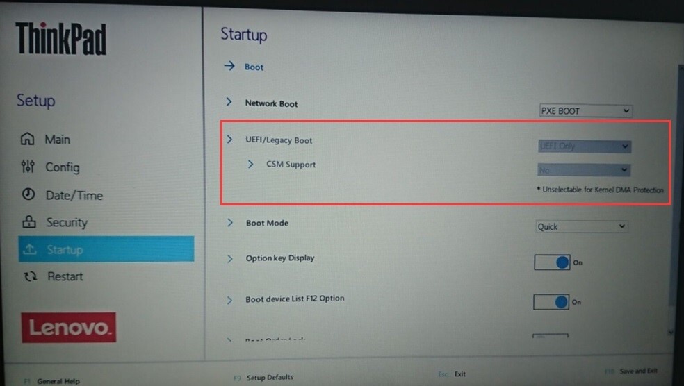

                          UEFI BIOS CAN'T CHANGE, SECURE BOOT ENABLE, i want to disable it, PASSWORD BIOS : 12345 (I put it because I thought that at that moment it would unlock my secure boot option)
                          SERIAL NUMBER : PF-3CYP2T
                          TYPE NUMBER : 20U4-S2QH00
                          if you can help me. thank you very much

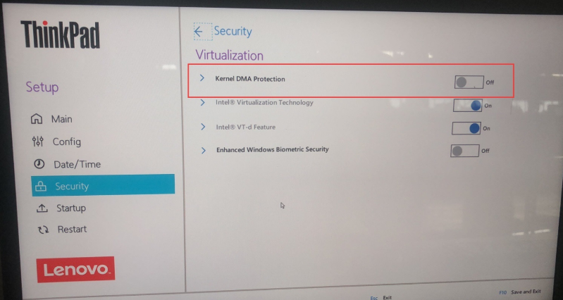

                              #34
                              maybe look for Kernel DMA if for change to UEFI/legacy boot settings
