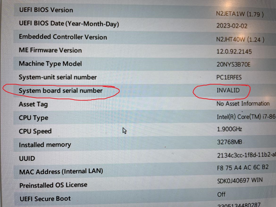

    Hi. Lenovo T490s. Need remove bios password. I removed it by erase mec, but now can not repair System board serial number. Can anybody say what lenght it must be? Serial number and modelr repair sucefull, but neet repair it, because show INVALID. Thnaks

      I do all this, i can not solve only board serial number.

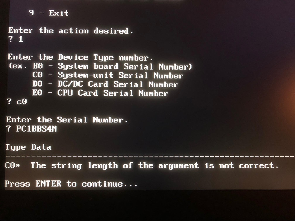

          Hello, I unlocked my first t490s with RT809H Programmer
          Now its unlocked but I am unable to edit anything back in to the bios setup
          I have tried ThinkPad Config Information Update Utility v1.11 - n1ctm07w(v1.11)
          and a few other apps I keep getting , The string length of the argument is not correct.
          I took a picture before unlocking I have all the right info to put back.
          Anyone know what I am doing wrong I have been at it all day trying to do this
          any help would be great thanks.​

          I have got it to work now, I am just having problems setting the system board serial number, got it down to 1 beep.
          • Maxpower3
            Maxpower3 commented
            Editing a comment
            you must put long number, not just serial
            You need to make a copy before unlocking. Make a photo or save it is better.

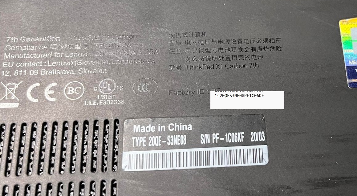

          Hello Maxpower3, where would I have found this long number or how do I make it up?
          I have looked in the 256mb main bios and the same number I have is in there too its no longer.
          I found how to do the other with the 1S and type 20NY then the S:N. I am struggling with this other one.
          Thanks.

            with barcode on bottom

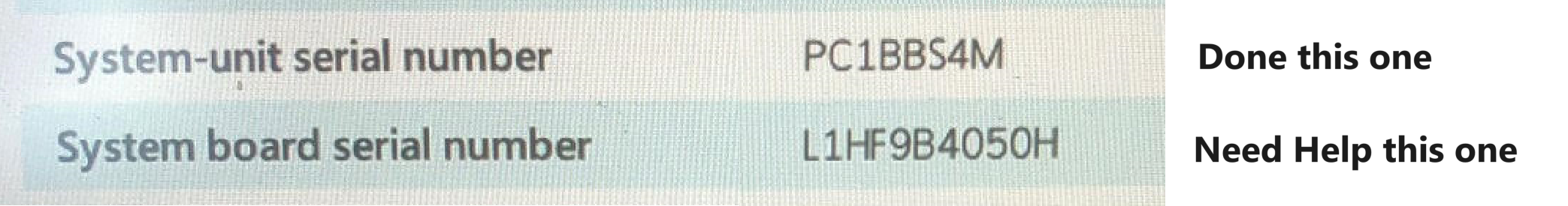

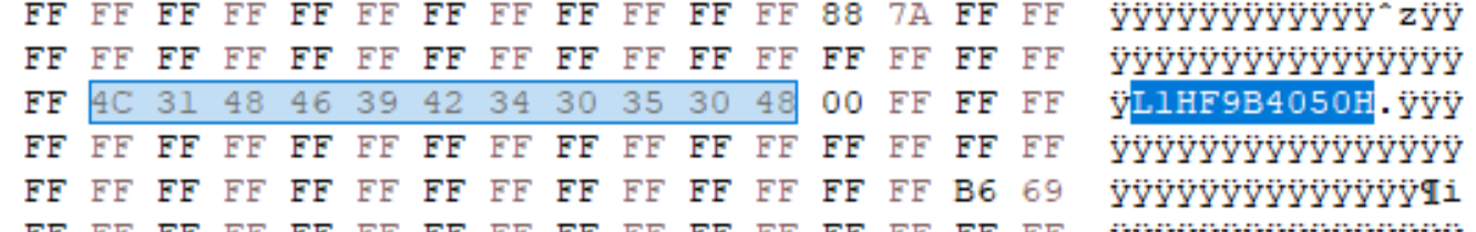

              Hello mate I don't think you been understanding me, its the system board serial number I need help with.
              how do I do that one mate. Thanks.
