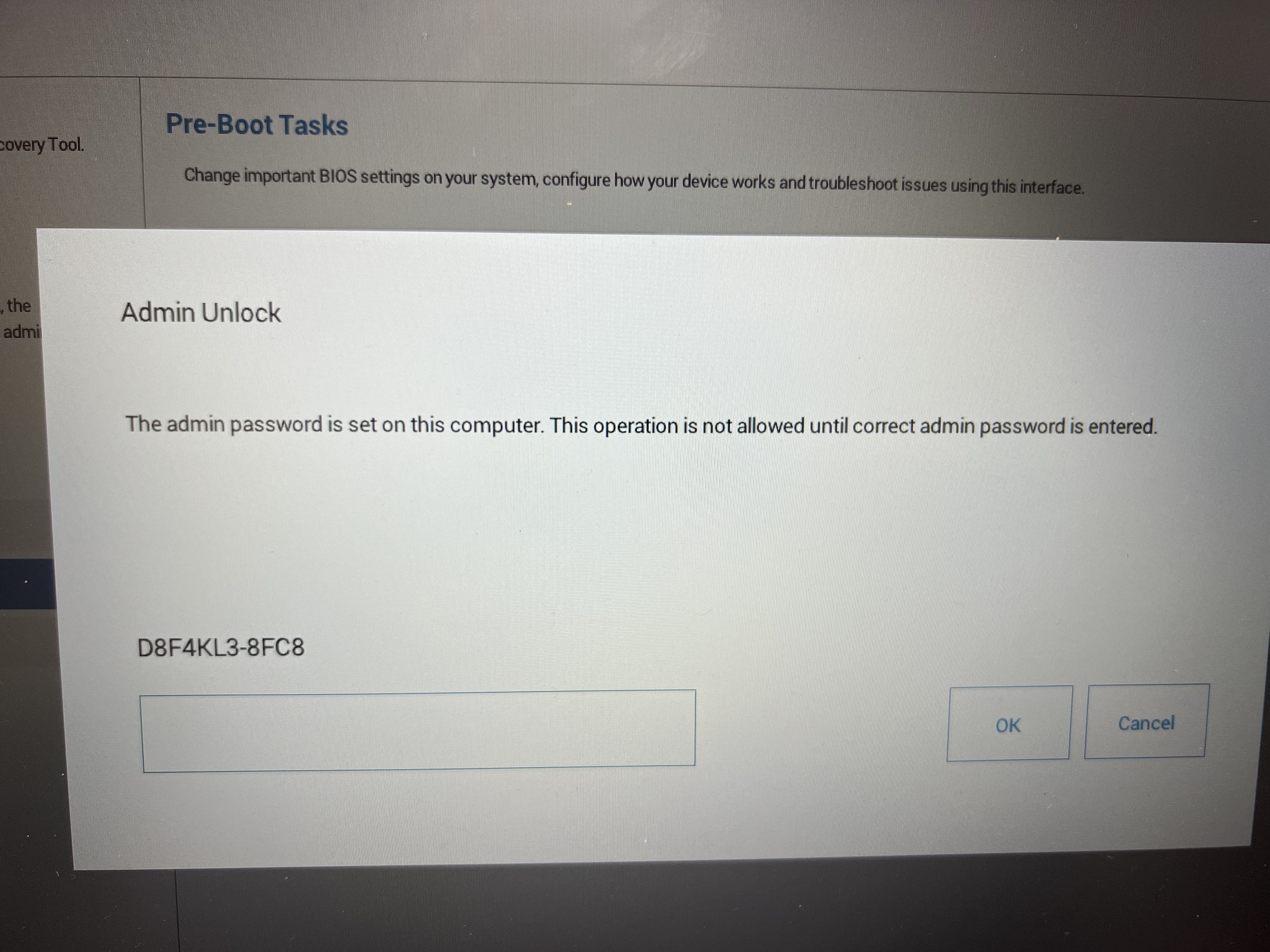

      Hi guys!
      I have a problem with password removal.
      Could somebody help me with it?
      SouthPeak 15 TGL MB 8L 19819-1
      SERVICE TAG: D8F4KL3
      Old rom in attachment

        #143
        Originally posted by wo5102586
        Hi guys!
        hi try

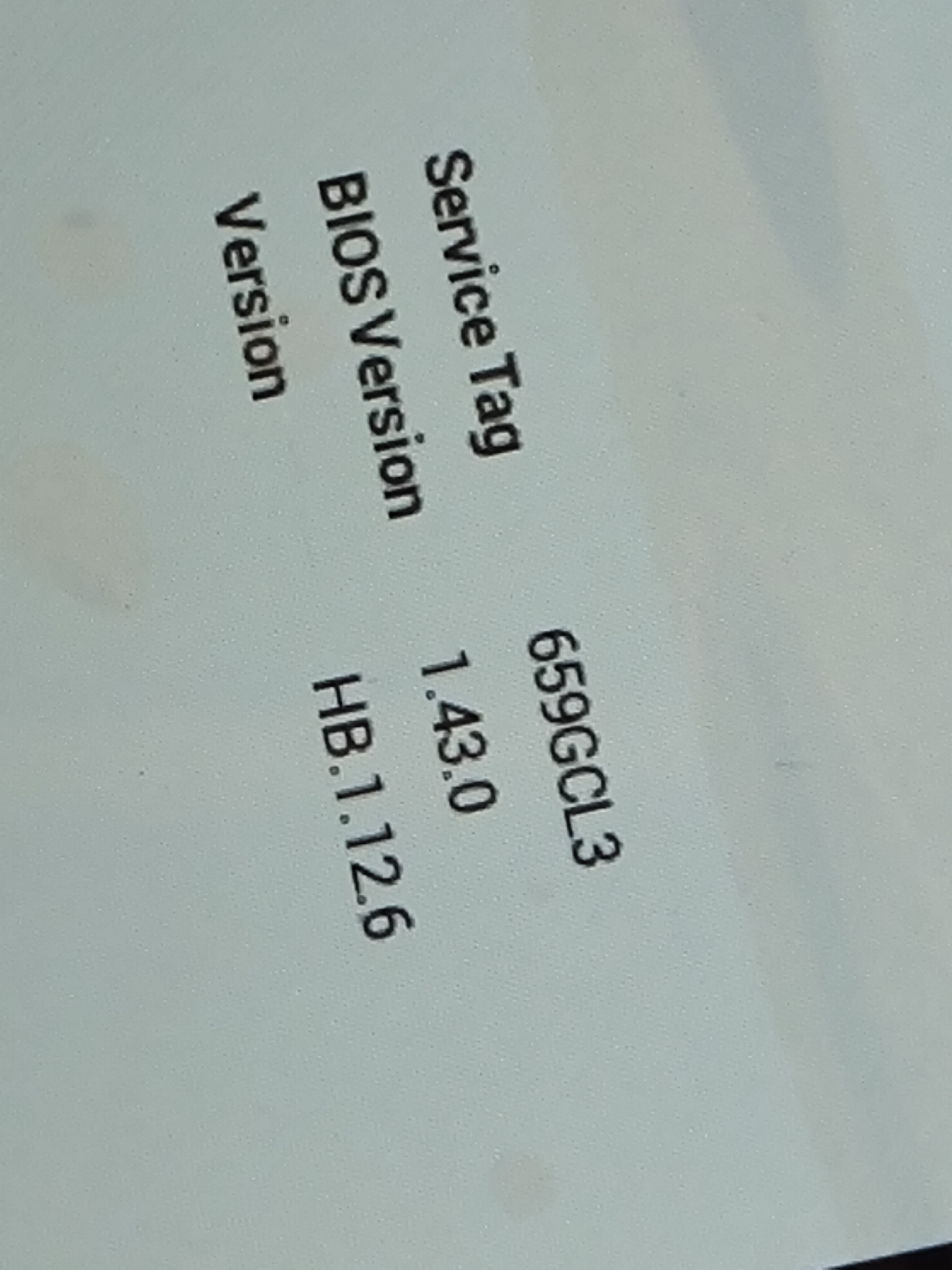

                      #150
                      Please help me find a clean me BIOS for this laptop. The original BIOS flash drive was physically damaged, with a broken pin. None of the BIOSes from this forum with a clean region worked, nor did the BIOSes from Telegram channels and other forums. With them, the laptop either does not display an image, the backlight is on, the LED flashes 3 orange and 6 white, or it displays an image and hangs on the BIOS logo and also LED flashes 3 orange and 6 white. I also tried to take a dump from another laptop that is exactly the same with a dirty ME region. Everything works on it, but it takes 40 seconds to start up. We tried cleaning the ME region with 1000 different versions of ME, a bunch of specialists, but the behavior is the same on them, either it doesn't turn on or it freezes on the BIOS logo and flashes the LED as described earlier.
                      Dell Latitude 5520
                      Service Tag: 7f7bsg3
                      Motherbord model: south peak 15 mb 213253-1 2twtt$ca
                      • peste
                        peste commented
                        Editing a comment
                        post merged...next time look for a thread with the name and model, motherboard model of the laptop, and post there, if you can't find it, then make a new thread..
                        Don't post pictures unless asked...write with the keyboard..
