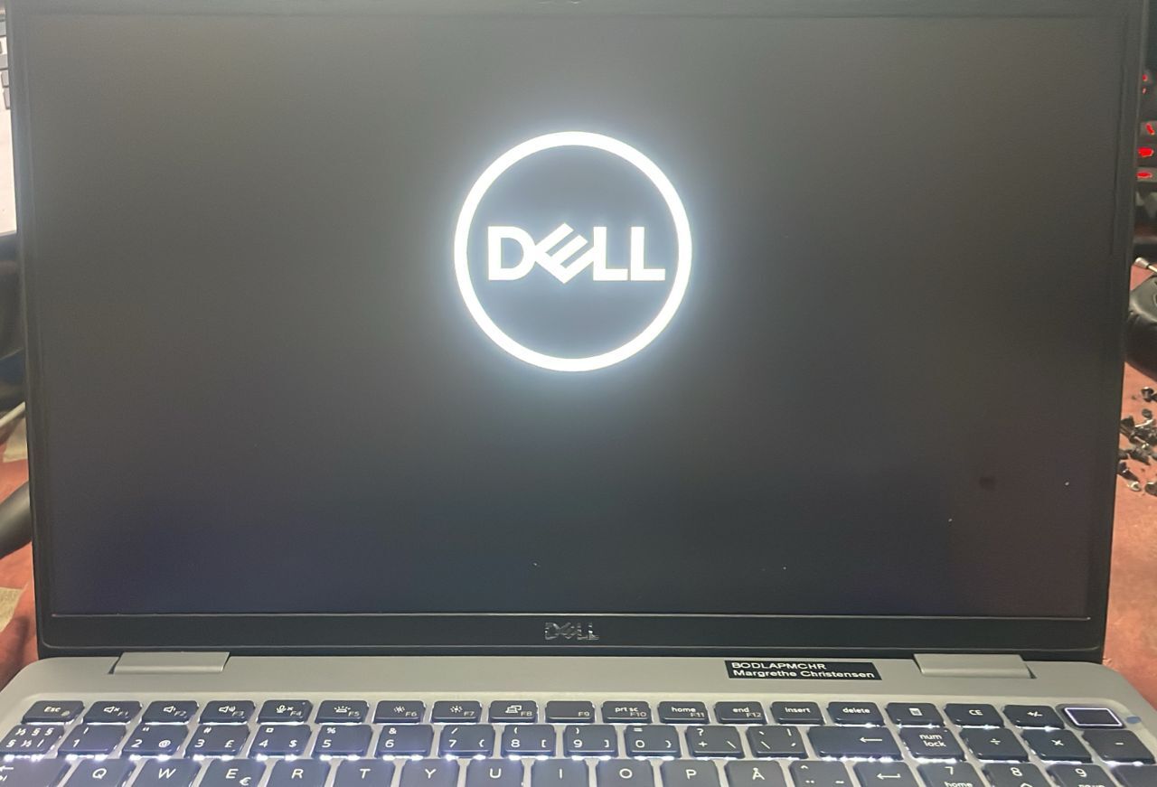

                  SouthPeak 15 TGL MB 8L 19819-1 82G7H$KA
                  SERVICE TAG: 99505B3
                  please need tthe dump for this motherboard mine displays and stops on the DELL logo
                  I tried with other bin but no display except its own bios
                  somebody help me please

                  • Pascal Komlassan
                    • Jan 2017
                    • 808
                    • TOGO
                    any help
                      upload your backup bios
                      • Pascal Komlassan
                        • Jan 2017
                        • 808
                        • TOGO
                        OKAY
                          OKAY
                          here try
                          Premium supporters get full download access and other benefits.
                          • Pascal Komlassan
                            • Jan 2017
                            • 808
                            • TOGO
                            Originally posted by rex98
                            here try
                            helo big chief
                            thank you for your valuable help but it's still the same thing
