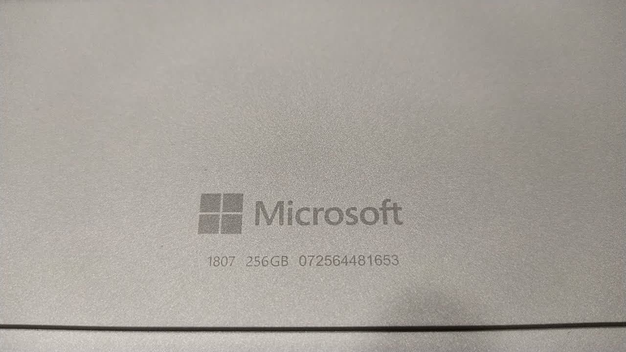

                          Surface Pro 5 Loop on logo
                          Hi
                          there is surface pro 5 (1807)
                          MB : M1011229-019 REV 4.3
                          when i power it on , display logo for 3 second and power off.
                          I know that the problem is with the BIOS file, because when I programmed this BIOS (https://www.badcaps.net/forum/showth...highlight=1807)
                          ,the problem was solved, but it does not boot and the touch does not work.
                          Can anyone fix the original bios I attached?
                          Thankful
                          .Today should be different from yesterday.
                            • 21948
                            Re: Surface Pro 5 Loop on logo
                            Originally posted by ahkh_72
                            Hi
                            Post the laptop serial number.
                            • ahkh_72
                              • Dec 2014
                              • 109
                              • Iran
                              Originally posted by smdflea
                              post the laptop serial number.
                              rules update for bios requests/offers *avoid banning, read before posting*
                              (1807 256gb 072564481653)
