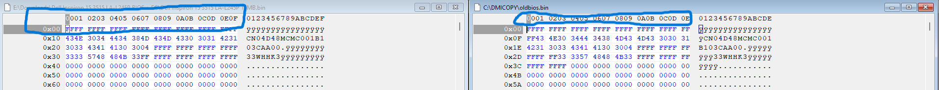

                            Your hex editor is tricking you by showing 15 columns instead of 16, check software settings
                            ST 33WHHK3
                            Try, BIOS from post 36, added service tag and win key

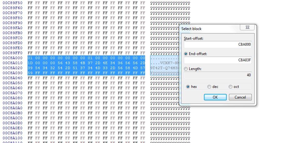

                              Hi M1ch43lmz, I'm trying again. Can you confirm that the address range for copying and pasting the service tag into the editor is: 0x00 - 0x4B? Thank you so much!
                              • m1ch43lzm
                                • Mar 2019
                                • 799
                                • Peru
                                #55
                                I copied 000-7FF and C8A000-C8A03F from your BIOS to the working BIOS
                                • norobert
                                  • May 2020
                                  • 10
                                  • argentina
                                  #56
                                  My problem was the address. Friend, thanks for your time!
