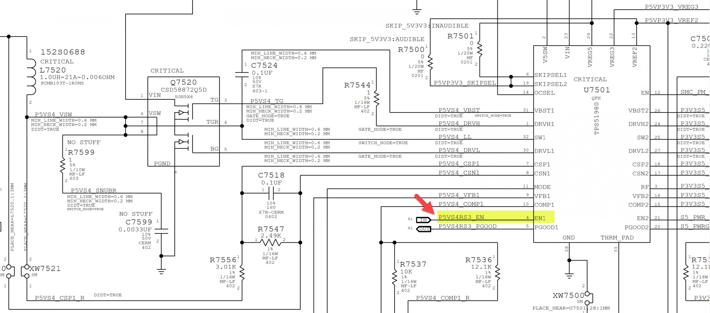

                  Re: Macbook Pro a1502 no power
                  I can see batteries are getting fat.
                  Not good - gases are expanding and will cause at least the casing to deform. Have seen it with clients in our shop. Also dangerous for the end user. This pack needs to be replaced.
                  See attached.
                  L7520 enables through voltage on pin #4 of U7501.
                  What is the voltage to ground of pin #4 on U7501 ?
                  • harshana
                    • Aug 2022
                    • 216
                    • Sri Lanka
                    See attached.
                    U7501 pin 4 -----> 0v

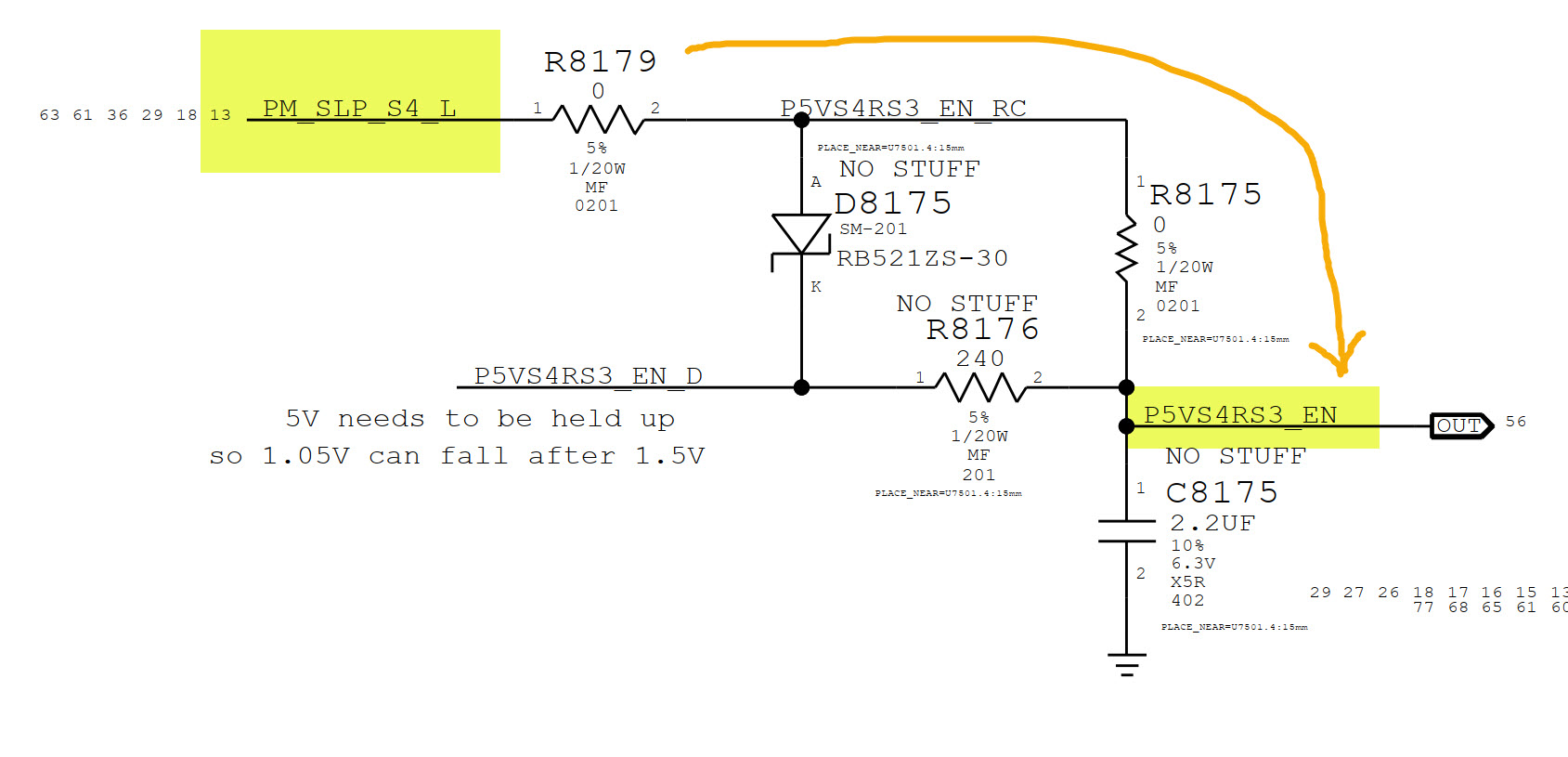

                    • mon2
                      • Dec 2019
                      • 14672
                      Review this webpage if PM_SLP_S4_L is LOW = 0v.
                      See case # 2 on this website.
                      https://www.it-tech.com.au/mac-q-a/pm-slp-s4-l-timing/
                      Do check the voltage to ground on both sides of R8179. Is it 0v on both sides?
                      Continue to update this thread.
                        both sides on R8179 is 0v. means PM_SLP_S4_L = 0v
                        PPVRTC_G3H = 3.34v
                        RTC_RESET_L = 3.34v
                        PCH_SRTCRST_L = 3.34v
                        PCH_INTVRMEN_L = was unable to find a testpoint to test Low signal(PCH_INTVRMEN = 3.24v)
                        PCH_DSWVRMEN_L = can't find a testpoint to test Low(PCH_DSWVRMEN = 3.24v)
                        SYSCLK_CLK32K_RTCX1 = don't have an oscilloscope.
                        PP3V3_S5 = 3.34v
                        PM_DSW_PWRGD = 3.44v
                        PP3V3_SUS = 3.35v
                        PM_BATLOW_L = 0.03v
                        PM_RSMRST_L = 3.31v
                        PM_PWRBTN_L = 3.43v (batteries not connected)
