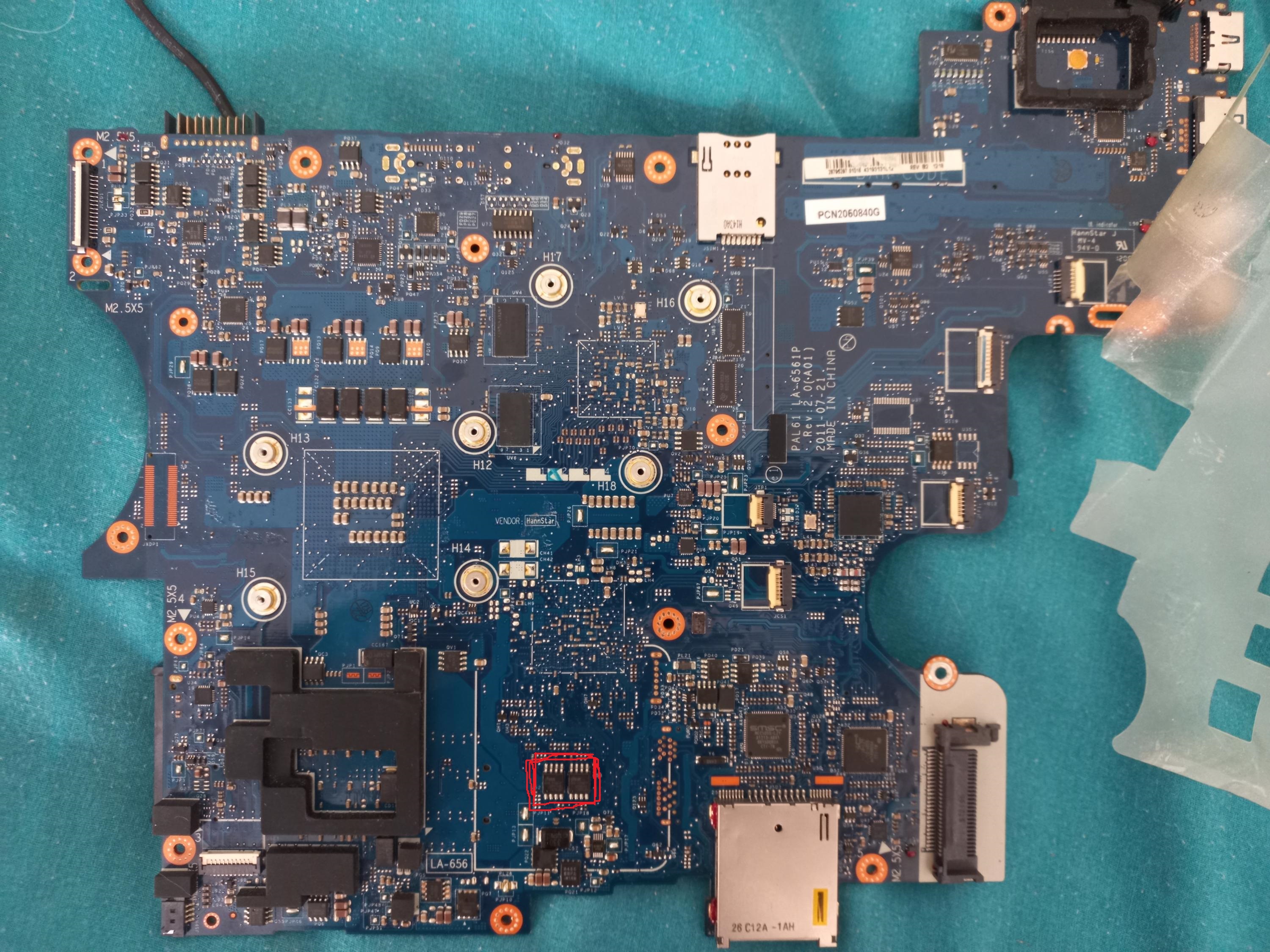

    Hi all i need the location of the bios for this board. ive searched the entire board and no luck so far.

    Marked with red, schematic is also available on forum...

      Thanks very much. you helped a lot. i guess its two bios chips one original and one backup.

        Re: Dell Latitude e6520 bios location
        no: main + me and ec bios
