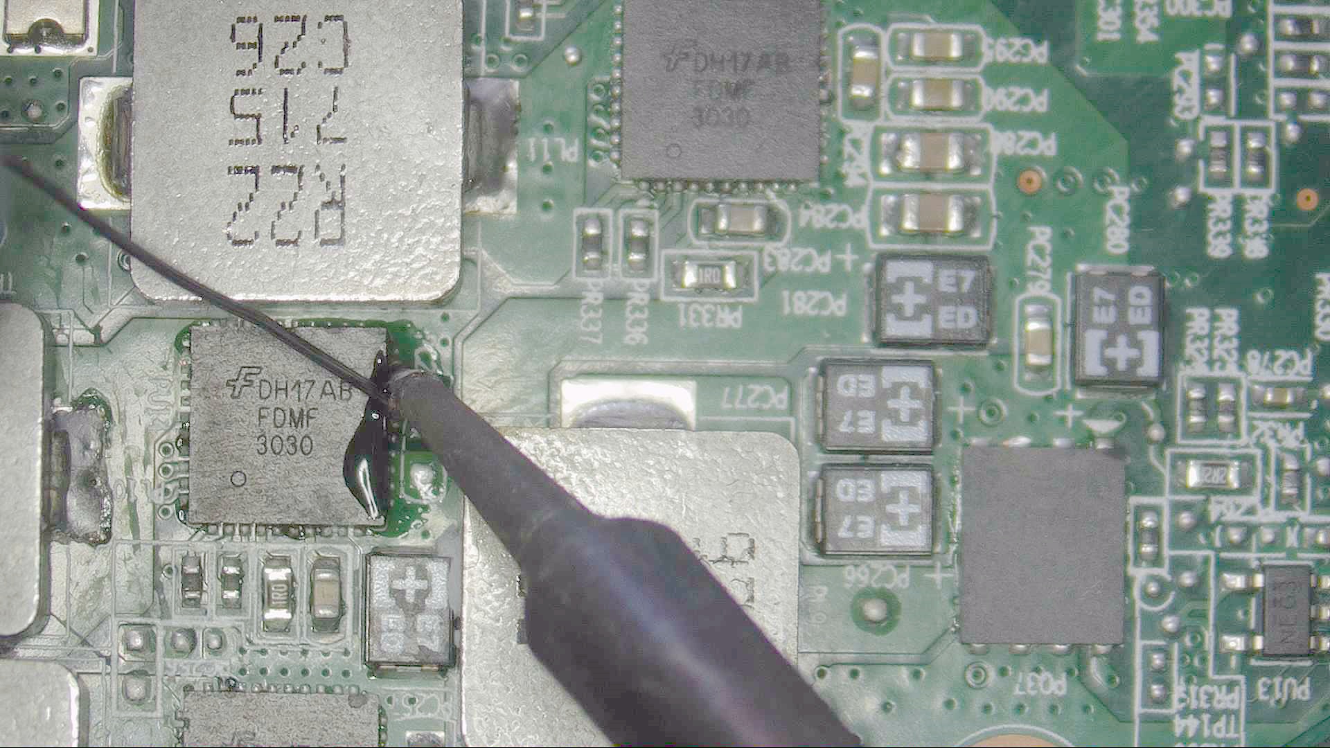

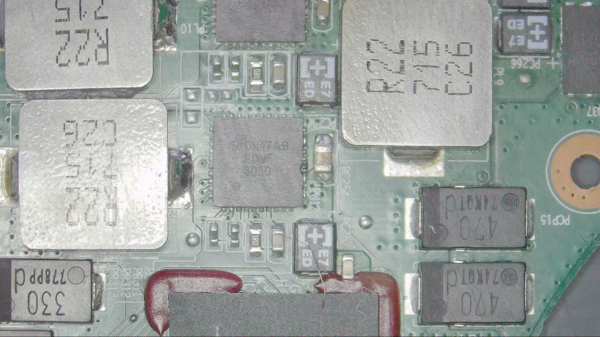

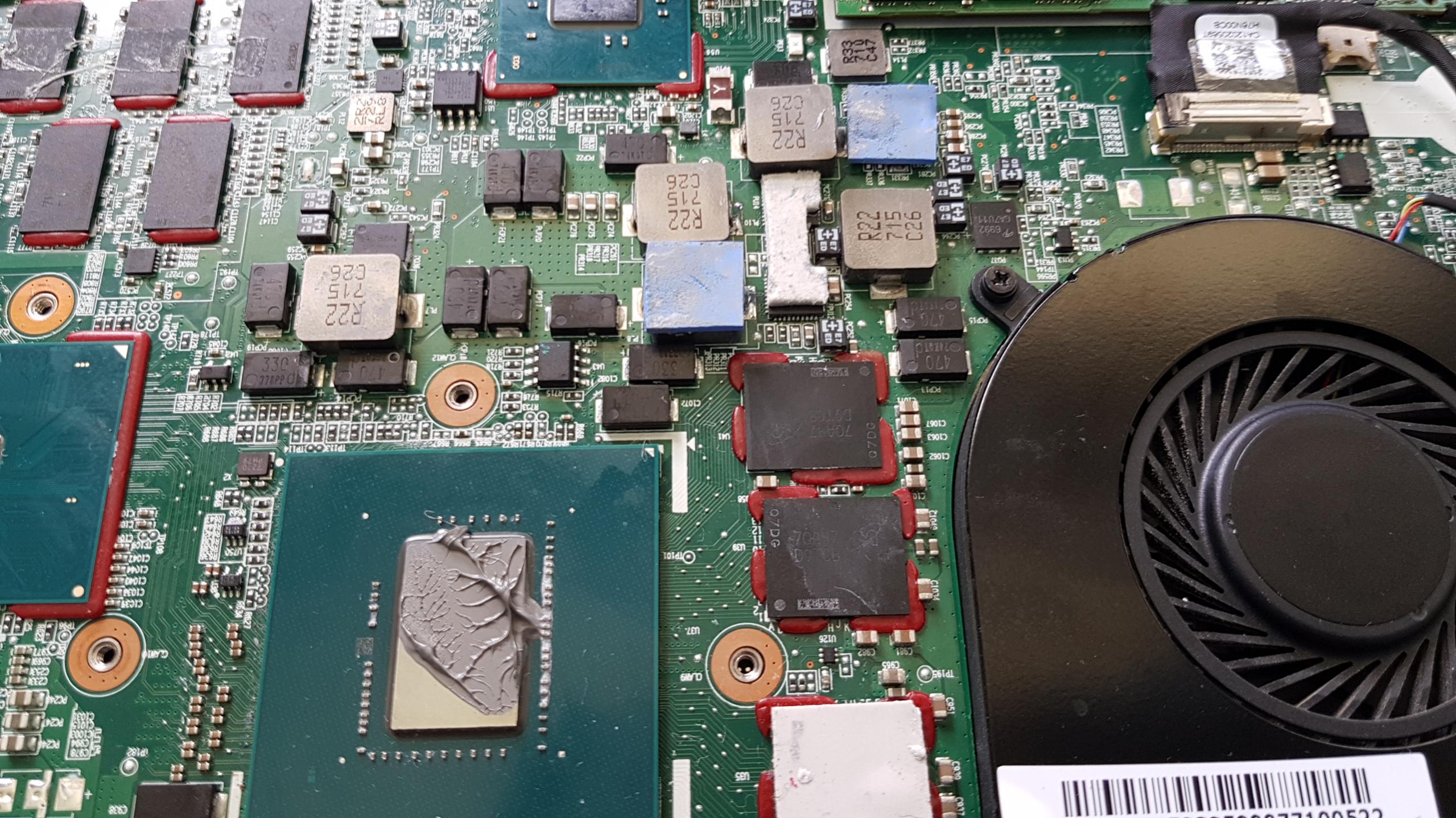

        Thanks for your reply. No short on the GPU core MOSFETs. Reflowed them just in case.
        The previous repair shops drowned Memory and MOSFET pads with thermal paste. Ultrasonic Cleaned the board just in case to prevent any short between Mosfet legs, not sure how elctro-conductive that thermal paste is.
        Still the same cut-off when under GPU load. I also noticed that it sometimes cuts off when even loading windows, after that heat treatment.
        Could it be a cold joint on the memory chips, which gapped up after the reheat? There is nothing much in that area.

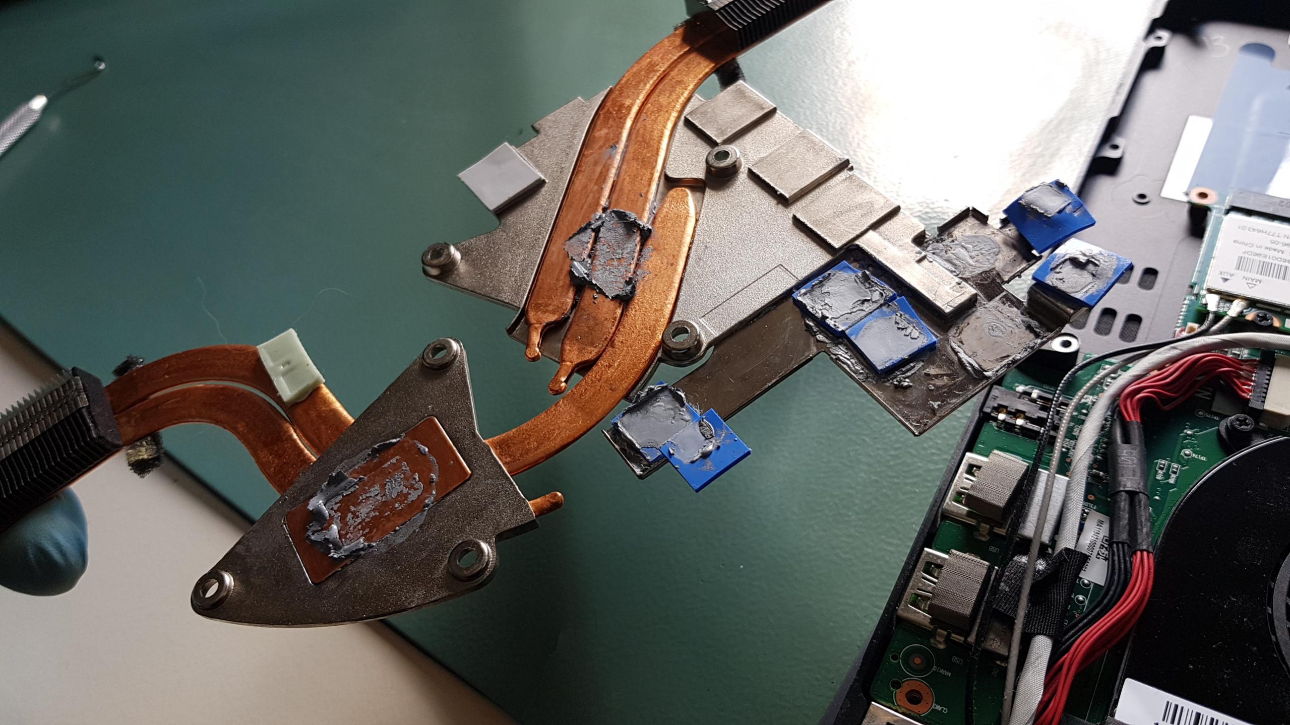

          the thermal paste looks like there was a bad hotspot on the gpu... or was it renewed? the thermal paste on the pads don't make sense though

            When I look at the GPU die I'd the heatsink doesn't make proper contact. Could be part of the issue.
            Also I'd even rule out the charger in case of it fails under load.
              Yeah thought the same, hence went and UCd the whole board to make sure nothing conductive is left.
              @Sephir0th, I feed it with 15A Bench PSU pulls 4A at max.Temps are in the 60*s range. When I fire up Heaven its stable on the loading part, but cuts off the minute game starts.
              I went and reflowed the GPU, to eliminate cold joint. But still same. Maybe RAM chips next - seems to be common thing with Desktop GPUs. But cant run MATS to confirm.
