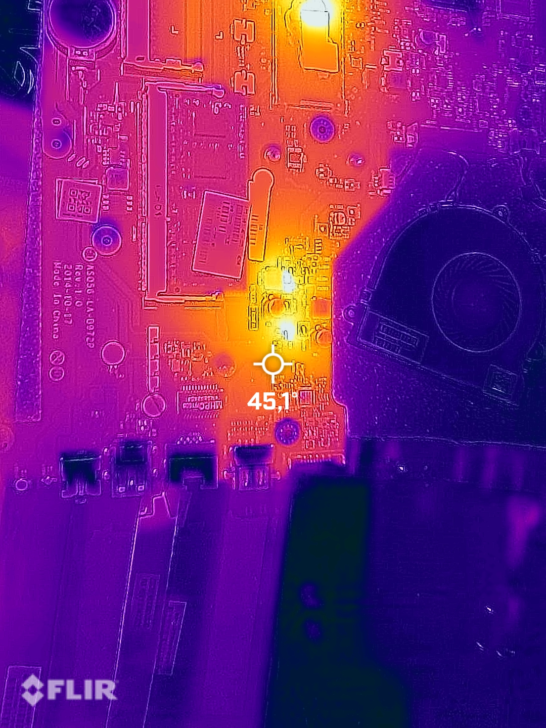

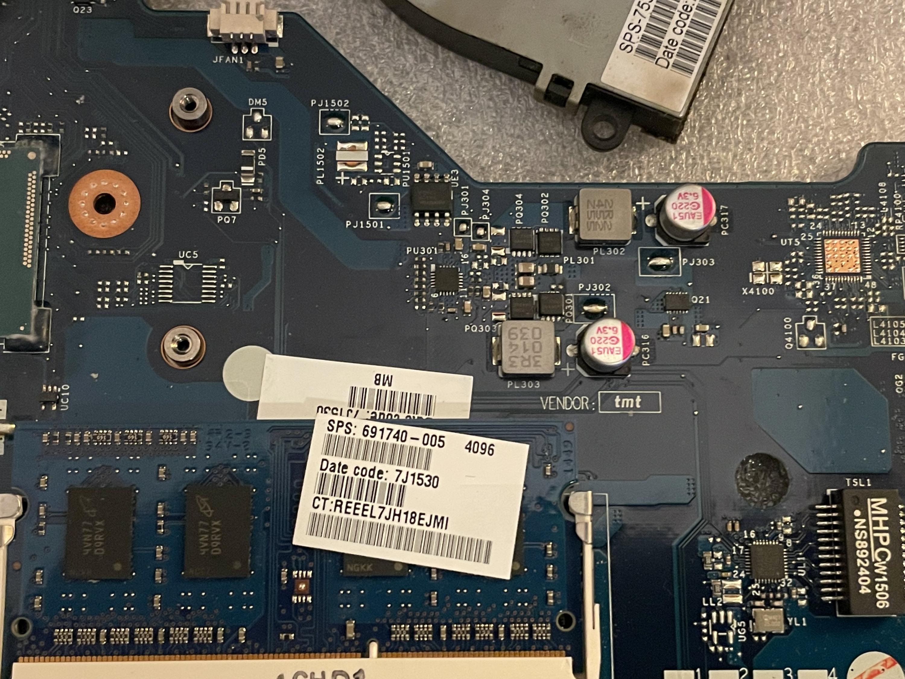

          Meanwhile, I analyzed the motherboard with a thermal imaging camera and noticed a temperature spike here when I turn on the PC
          • rediii
            h???, spurrrn
            • Mar 2018
            • 499
            • somewhere in europe
            Re: HP 15-r239nl LA-B972P 1 blink caps lock
            Originally posted by resistor83
            sorry but these days I had the flu.
            However, I am not very experienced at reading wiring diagrams so I need to know what measurements I should take.
            give us readings of all coils in ohms mode. they are marked as PLxxx

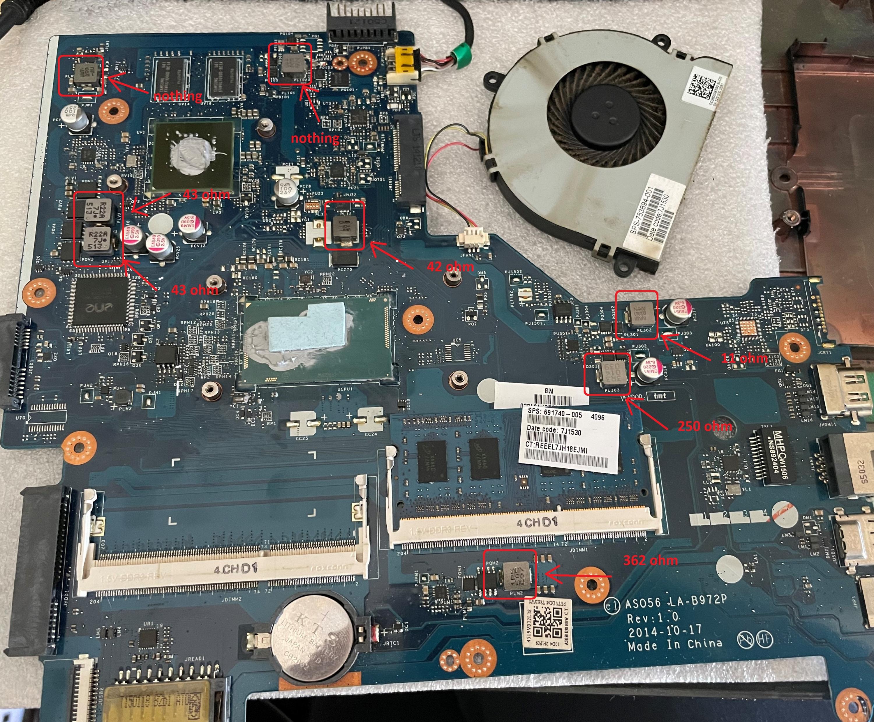

            • resistor83
              • Oct 2018
              • 127
              • Italy
              PL302 11ohm
              PL303 250ohm
              PL102 nothing
              PLW2 nothing
              PLM2 362ohm
              PLZ2 42ohm
              PLV2 43ohm
              PQV3 43ohm
