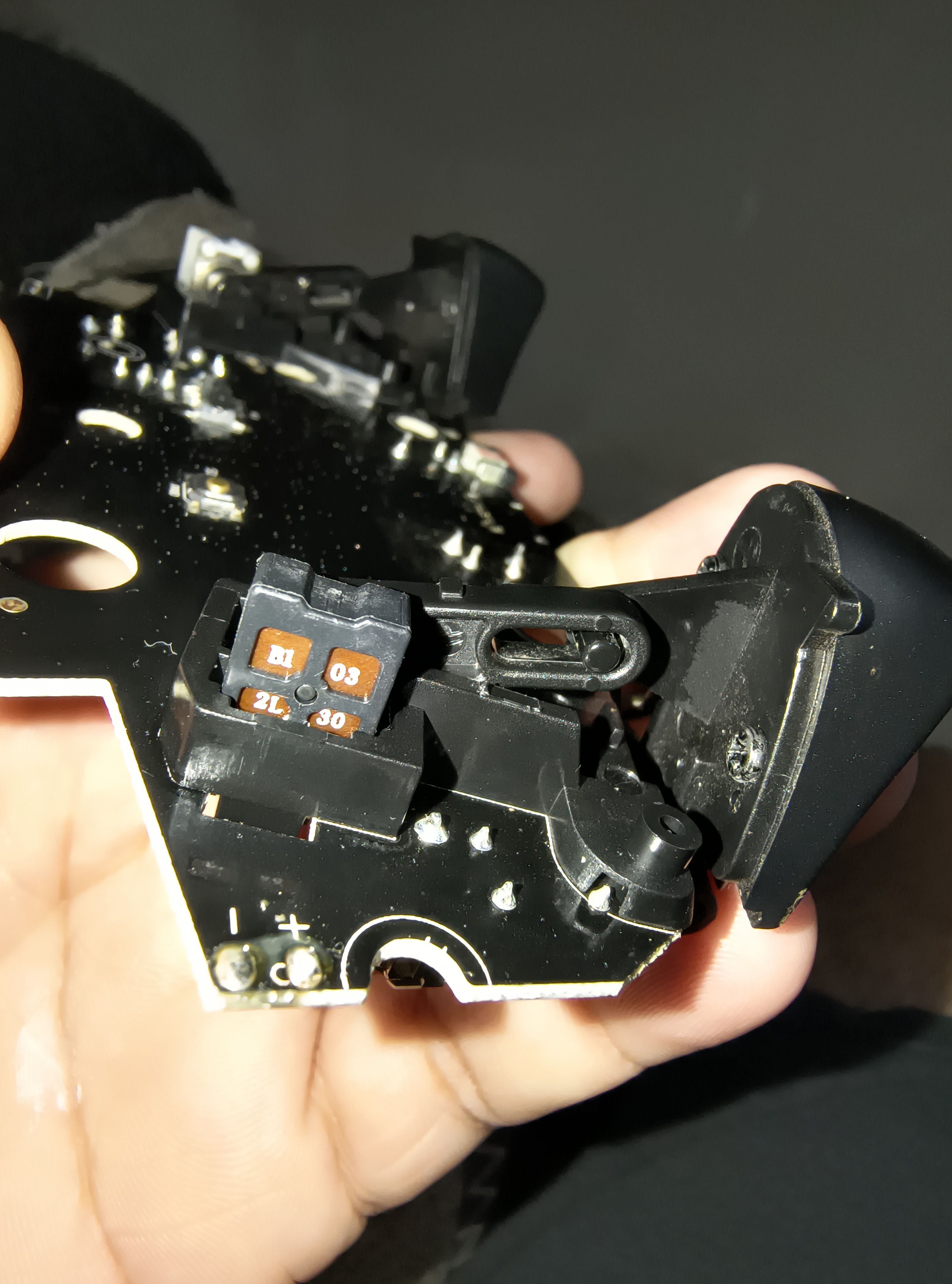

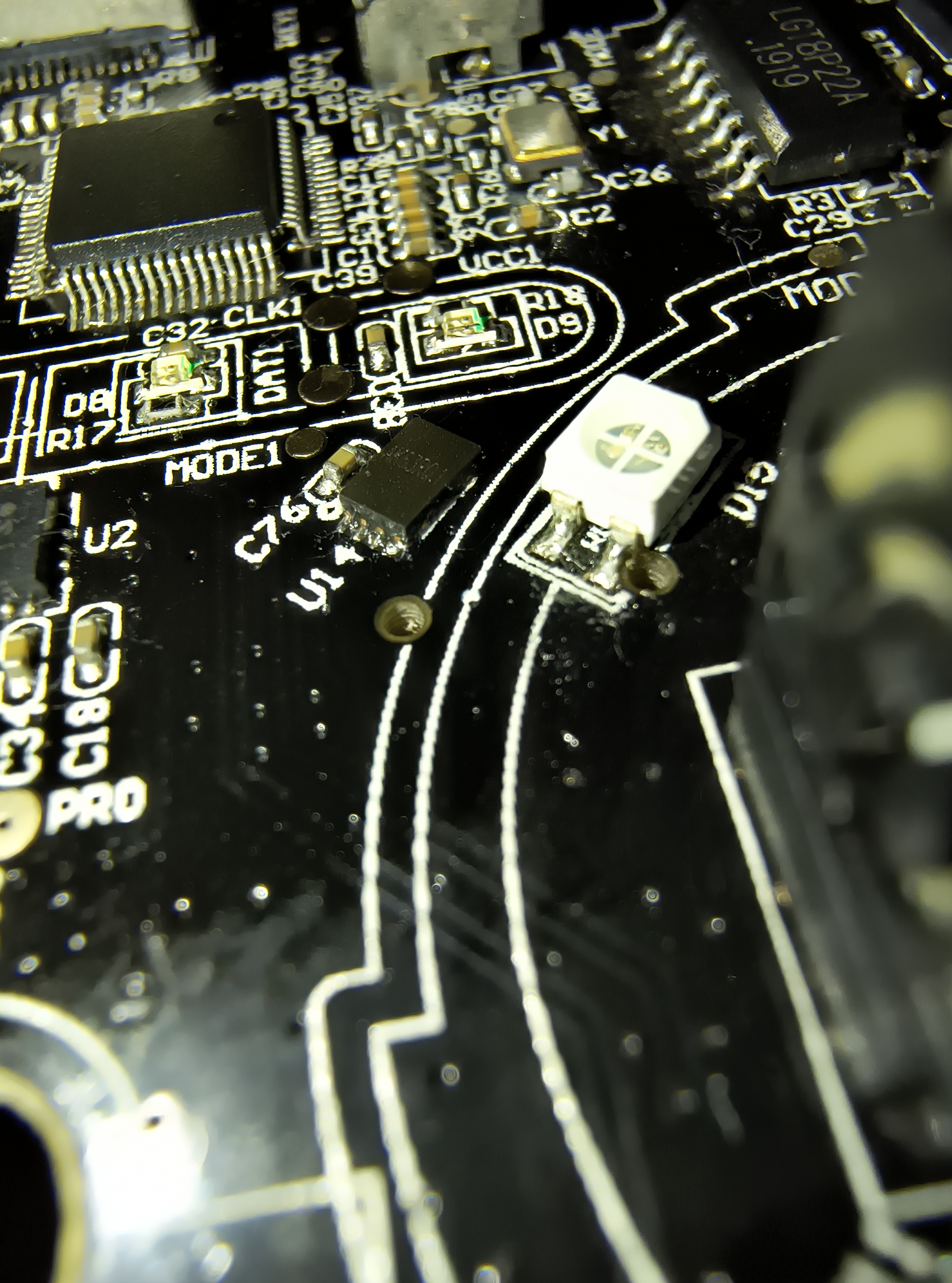

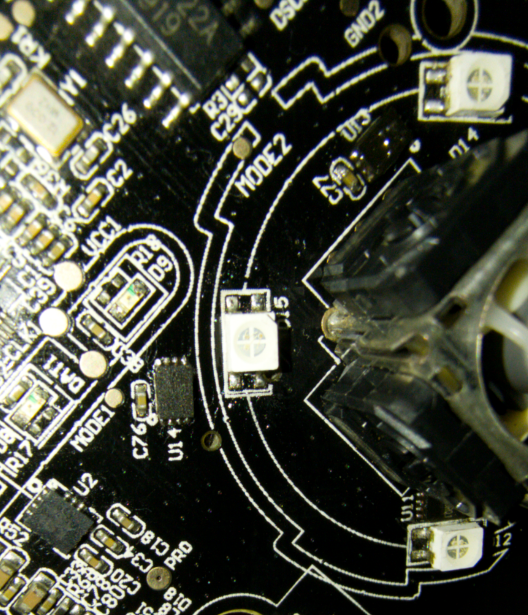

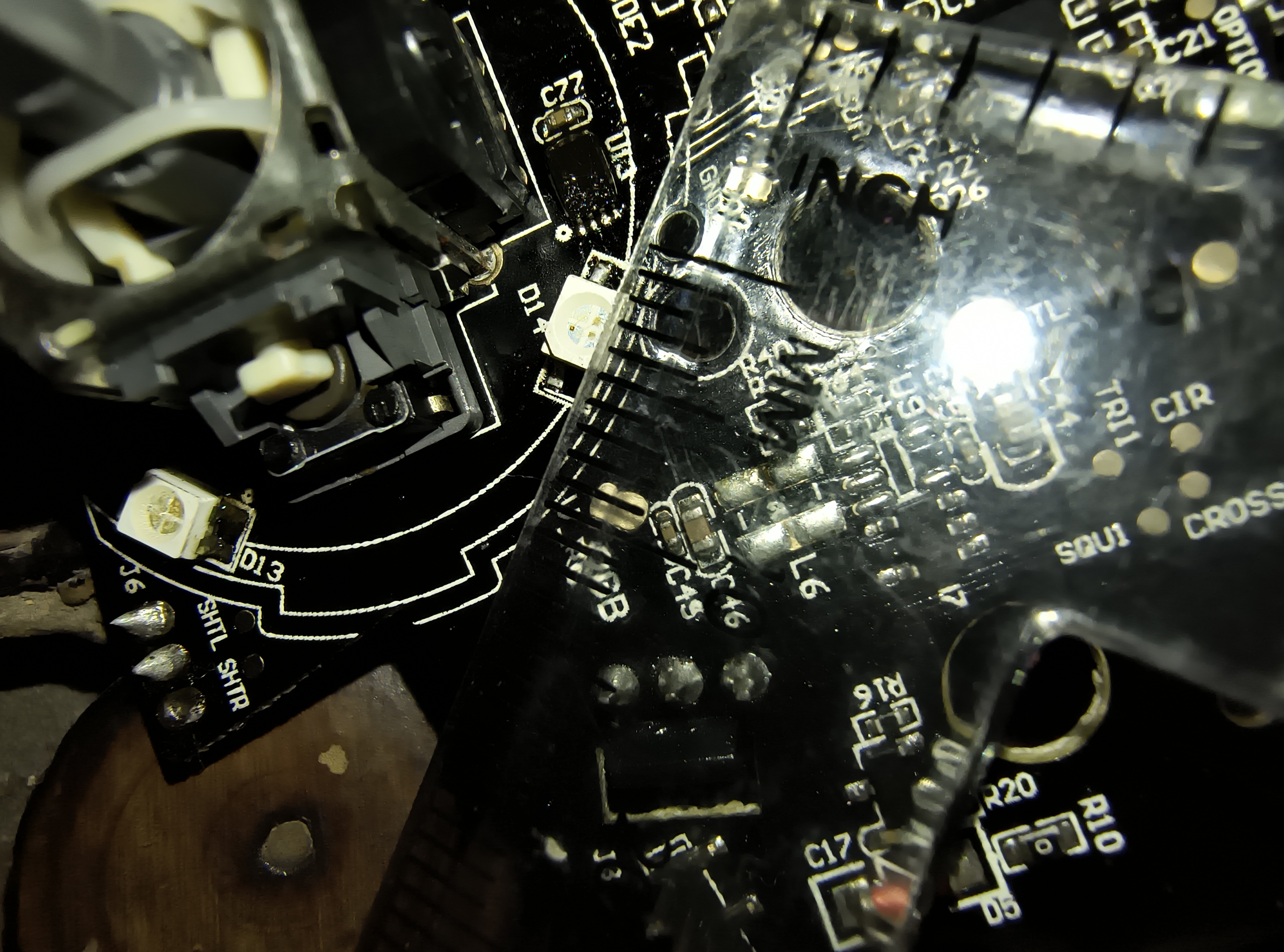

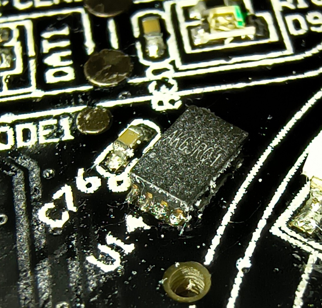

    I have a nacon controller which has some fancy RGB ring (4 RGB LEDs). 3 of 4 leds are not good and I am looking for a replacement. The size I measured is 3mm x 2.5mm and it seems a 3528 led would fit fine, and it's in common anode. But I am not sure what wattage it is. I have attached photos of led and driver ic (ak63rq1 I think).

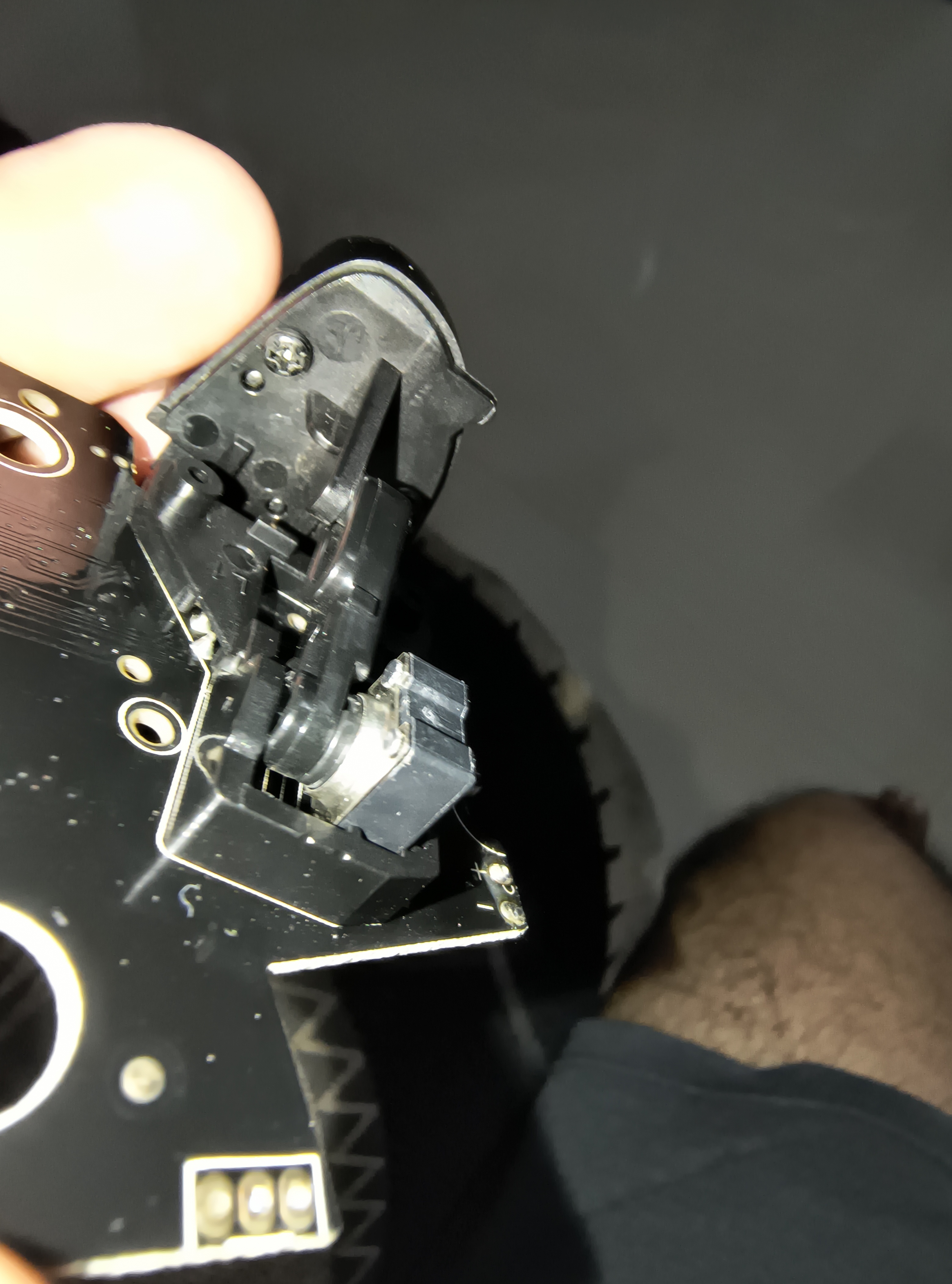

    Also one of the triggers is malfunctioning sometimes, I don't know what these pots are called. I measured across the 1st and last legs (in circuit) seems to be 1.1kohm pot. I found some xbox controllers have this but they are 10k. Any info?

    if the leds are bad you should change all of them because the remaining ones will fail soon
    as for the pot - maybe get some contact cleaner into it

      Yes I am planning to change all 4. Do you know what wattage it is?
        • 30956
        no idea - but it's gonna be tiny in that package.
        i doubt there are many options to choose anyway

          I ordered some 0.2W RGB 3528 package. I couldnt find anything else on local sites. Let's see

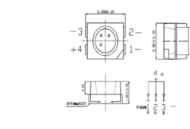

            I recieved the led but it's pinout is different. Size is exactly the same however I searched many brands, but all have the same pinout (as in attached picture). What this controller uses is 1+, 4 R-, 3 G-, 2 B- . It's like if I place it upside down the pinout matches. I don't know why the manufacturer didn't choose standard pinout. 😔
            Does anyone know such an LED?
              • 30956
              the drawing is common-anode, so the oposite would be common-cathode
                No it is common anode only (+ve is common). I put red probe on 1 and black on other 3 and the corresponding LED lights up
