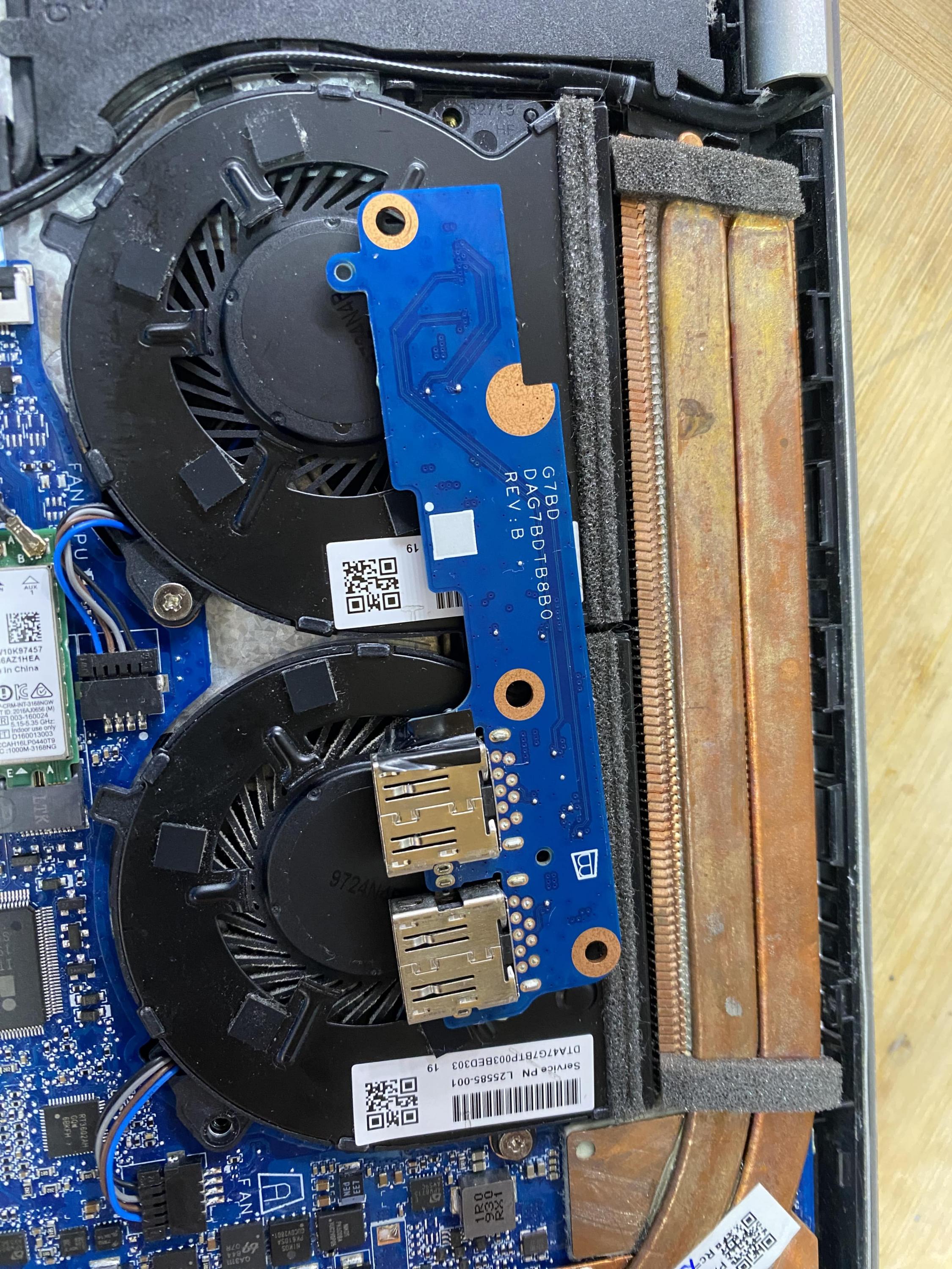

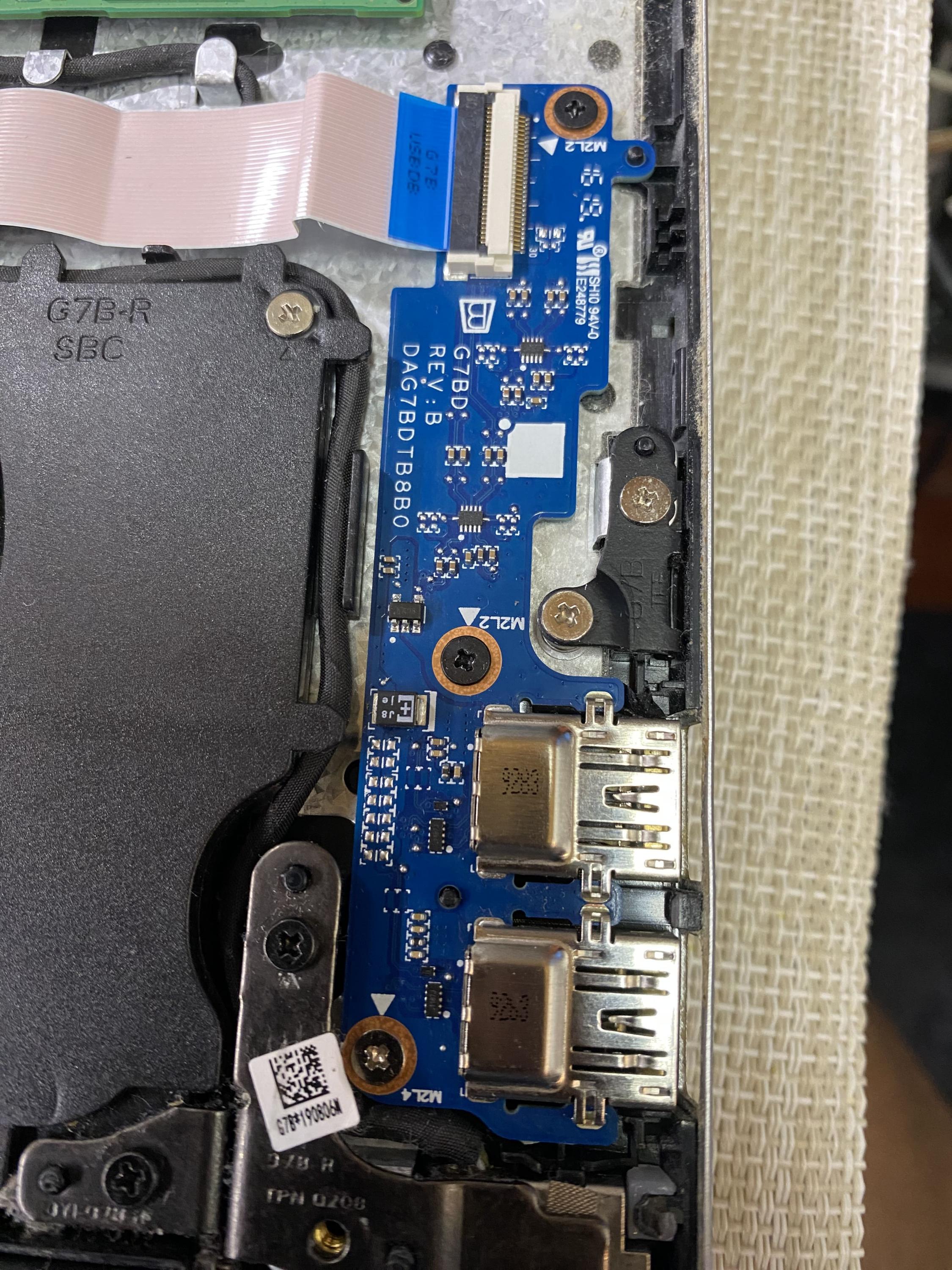

                        • 20974
                        Re: Hp 15-cs2023ca USB 2.0 not working
                        Originally posted by mferna14
                        I mentioned the meter reading for the Data lines, both are almost 400Khms, & the 5v is always present, the voltage is not fluctuating at all, stable as ever. I checked, but there does not seem to be any protection diode. After the coil, the circuit is directly going to the SOC, I am assuming this as I do not have the schematics for this model. I have a used another SSD with fresh Windows 10 on it & still gives "unknown usb device (device descriptor request failed)"
                        Is the card reader working. Post a picture of the USB board both sides
                          As well as webcam working or not??

                            • mferna14
                              • Jun 2018
                              • 1025
                              You guys are so right "SMDFlea" & "mcplslg123", USBs, Webcam & SD Card reader solt even is not working. I have attached the photos of tHe USB board, kindly look into it. Hopefully we can resolve this problem. Thanks
