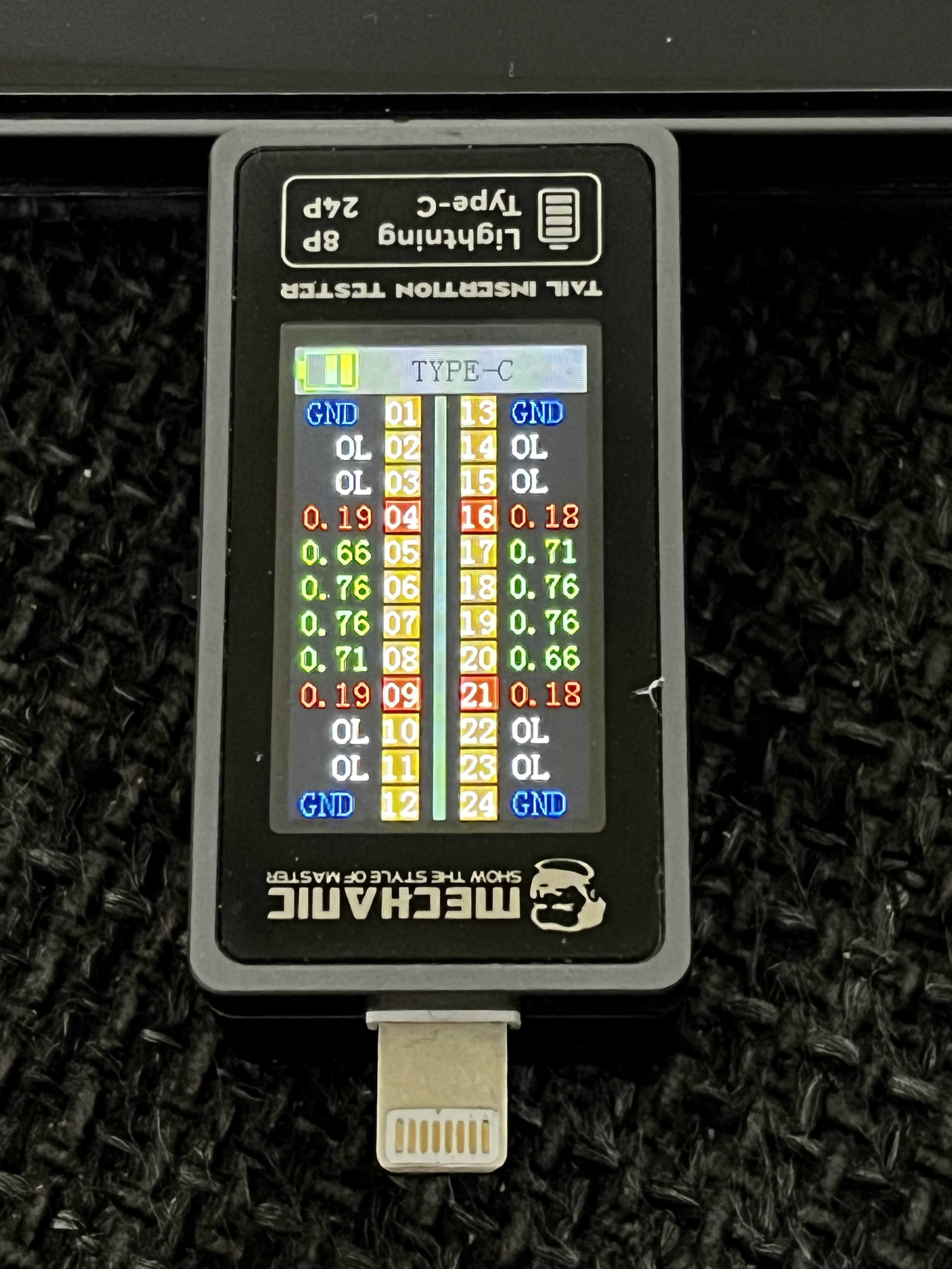

      Yes I have a "Mechanic" USB-C and lightning Tail insertion tester. After changing the usb dock it said some faults. After changing the usb chip CD3217B12A it says everything is ok. All values are normal and exactly same as an other iPad with usb-c. The current drwa if you plug in an USB-C cable from USB-C charger is 0,000A it only switches to 5V. From USB-A charger also 0,000A. I have also a breakout board, but all values are ok.

          Same as the USB-C checker. The USB-C checker give same result +/- 0,01V as same functional iPad on each pin

              I know exactly what you mean. I have tried 2 different usb connectors also tried not to install this in the iPad case because it is easier to connect it. But all this without result and the usb-c checker would not give me a good measurement. I can alsomeasure on the board some voltages with connected usb cable and disconnected battery.

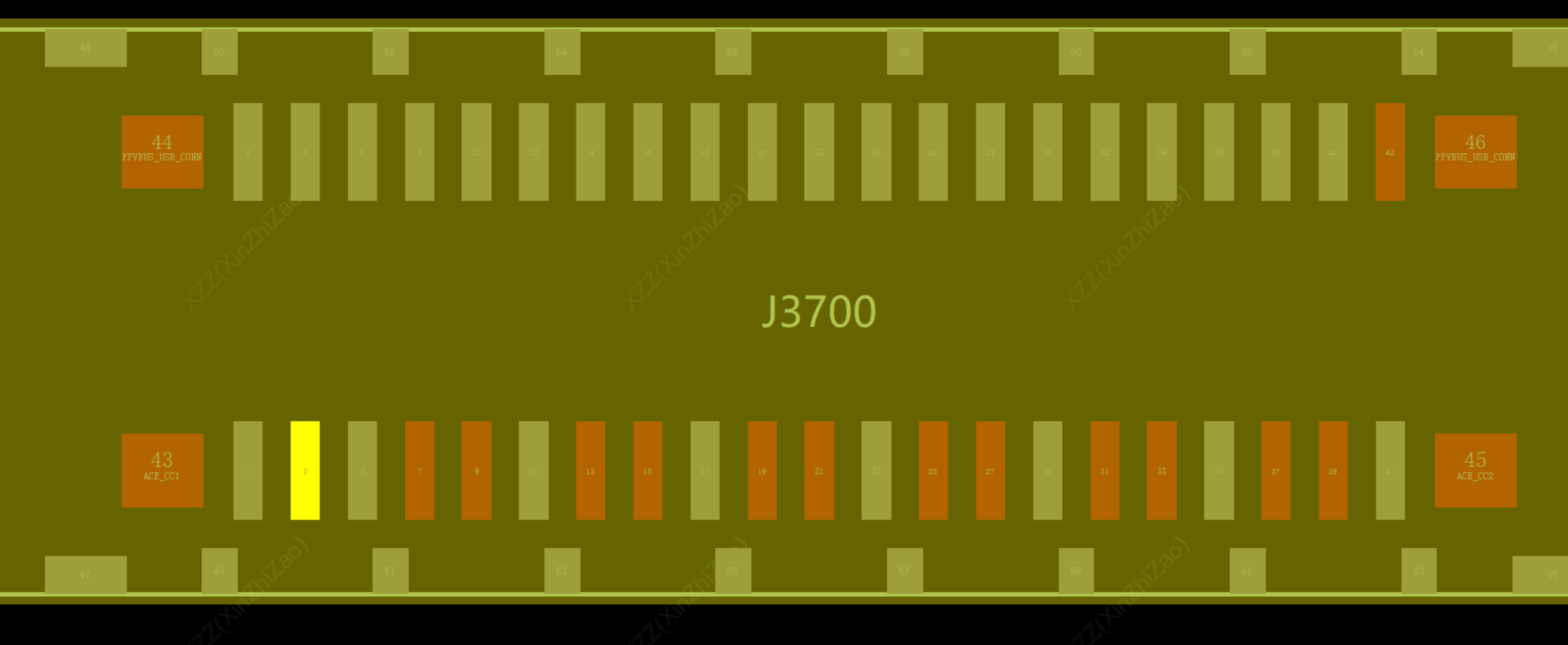

                Remove the USB connector paddle board / cable. Remove all power. Meter in DIODE mode.
                Carefully measure each pin in DIODE mode to confirm their values. Do not worry about the ground pin checking but interested in RED color pin. Your BV diagram will offer the locations of each non-ground pin.
                With no power -> meter in DIODE mode -> RED meter probe (yes RED) to ground & Black meter probe to the point to test.
                Post the table of values.
                Click image for larger version  Name:	J3700.png Views:	0 Size:	69.3 KB ID:	3263167
