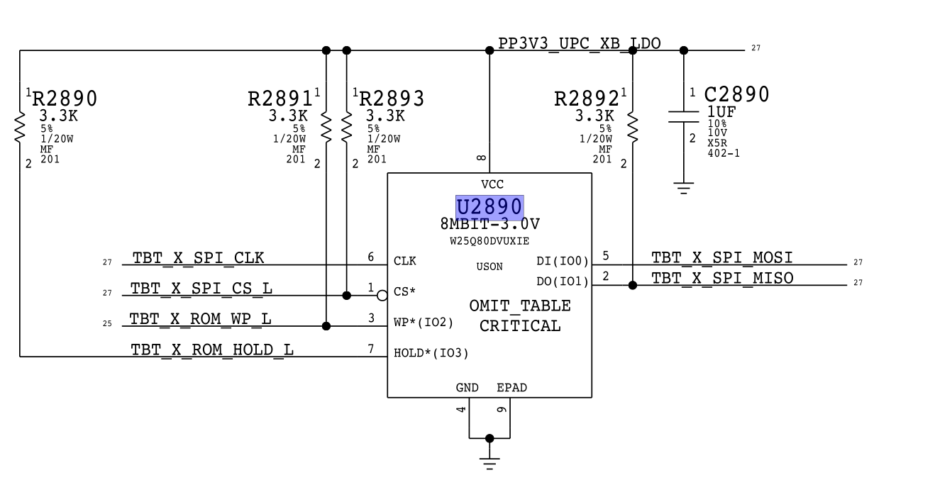

                                Reflash the T2 Rom (U2890; 3v3 device) using the dump from here:
                                https://www.badcaps.net/forum/showth...ight=rom+dumps
                                * backup your original flash before erasing the device
                                • piernov
                                  • Jan 2016
                                  • 4439
                                  • France
                                  #36
                                  Re: MBA A1932 820-01521-A no Post after few seconds it restarts
                                  U2890 is USB-C controller ROM, not T2.
                                    reflashed (was fun removing that cover...) same voltages

                                        #39
                                        My bad - all in the basket of Tx propreitary crapware. The TBT rom was only to confirm the image is stable to maintain the 20V power delivery contracts.
                                        Is the display attached ? Can you test without the display to see if the results are different ?
                                        Can you confirm the voltages for the SOC ROM ?
                                        Check the Vcc; MISO; MOSI pins. Suspecting some I2C / SMBUS / SPI widget is timing out and the boot process restarts / loops.

                                          #40
                                          Wait so I should have reflashed the T2 Rom chip not the U2890? I reflashed the U2890 NOT the T2 rom U4770
