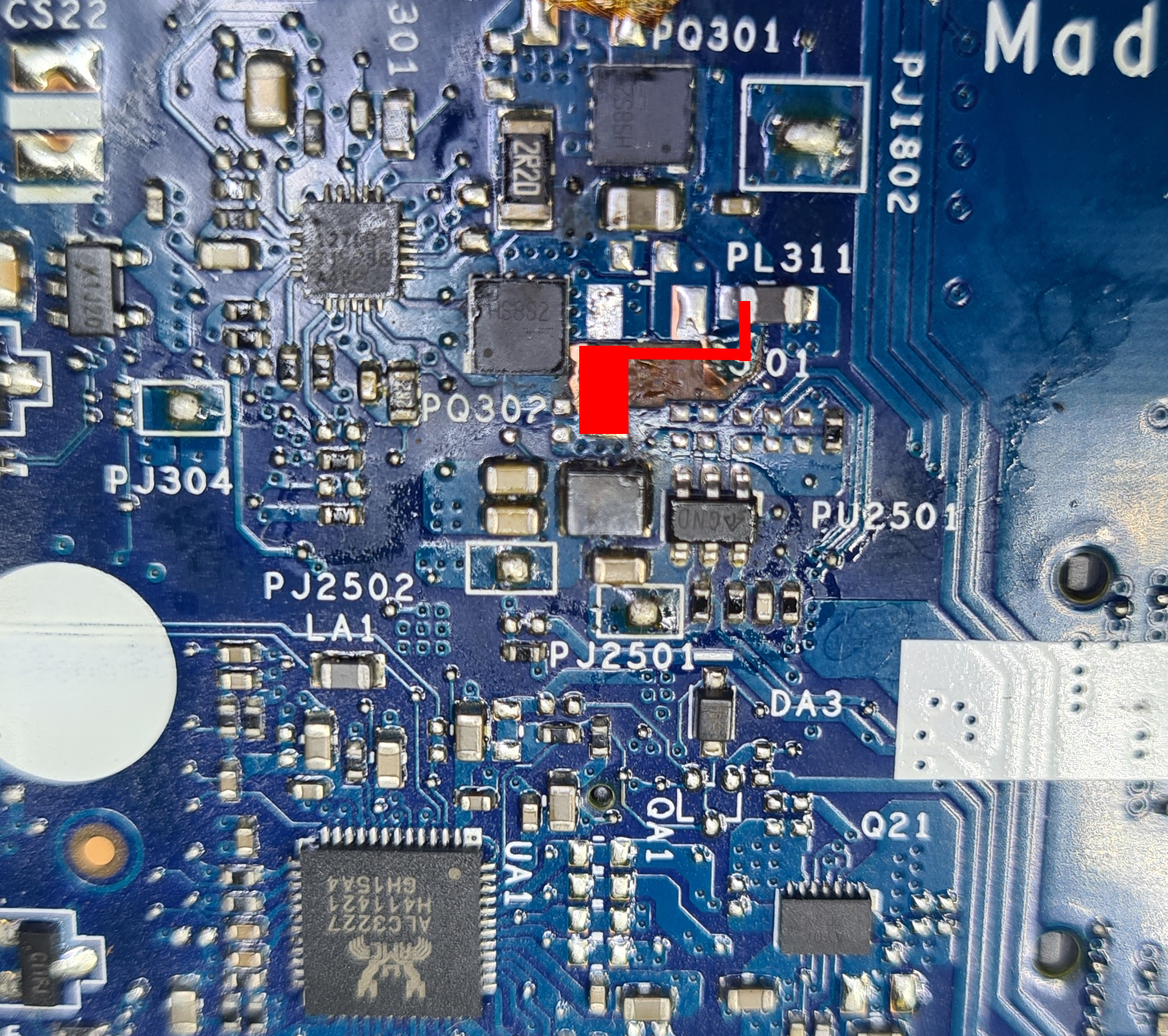

    The bad series continues... My HP laptop is out of service

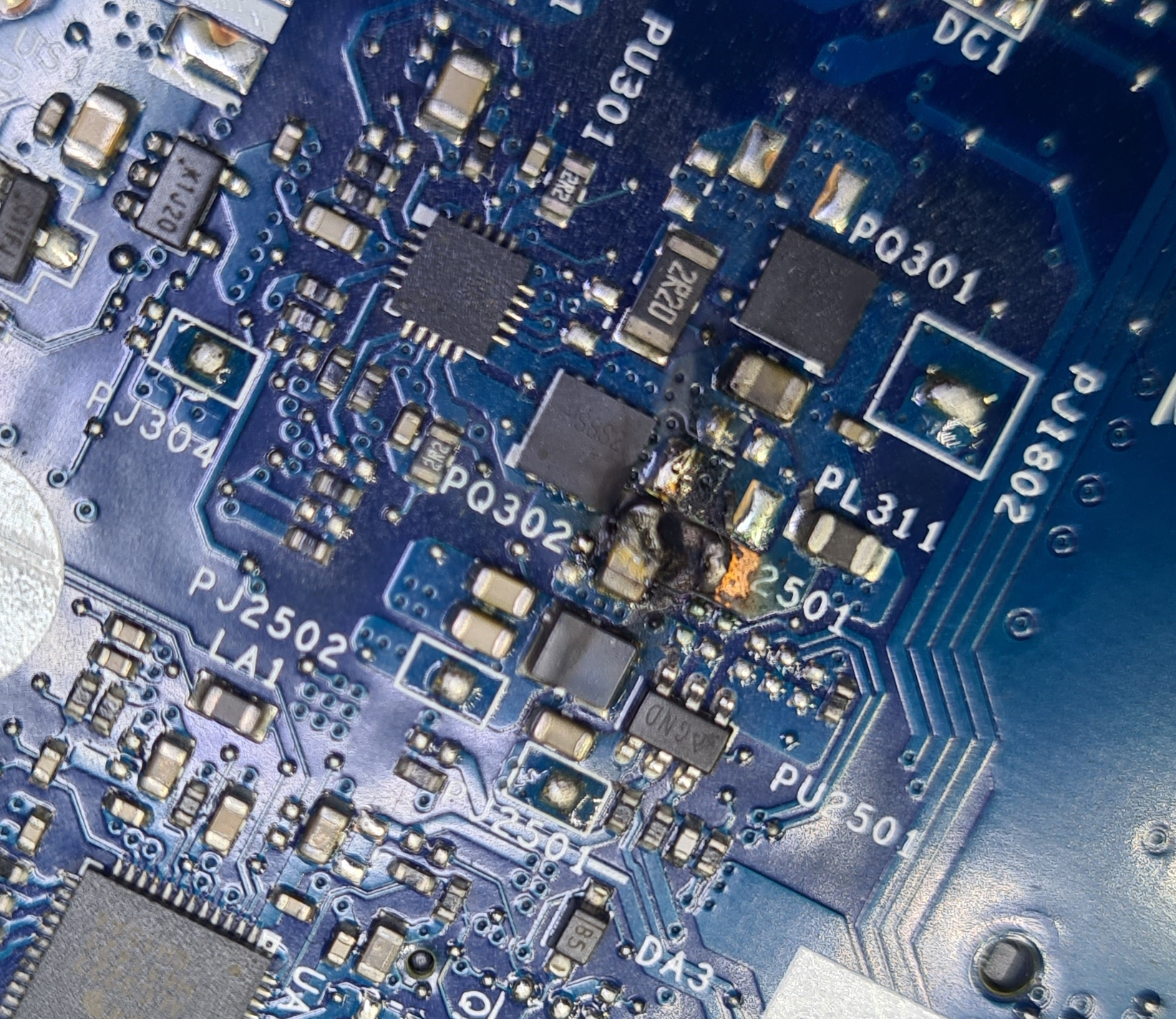

    I heard a "strange" noise and a suspicious smell... So I disassembled the machine and here I am with a capacitor that has completely exploded and the PCB burned.
    I desoldered and cleaned the mess, here is the result.
    My problem is that I can't find absolutely anything on this LA-E801P rev 2.0 motherboard, so does anyone have any idea which component broke please?
    I assume that the mosfet is responsible... I can change it but without knowing how the PCB is at the base, it will be complicated.
    Thank you very much in advance. I no longer have a Mac (awaiting repair following the great advice here) and therefore no more PC. Here I am with nothing!
    Thank you very much again.

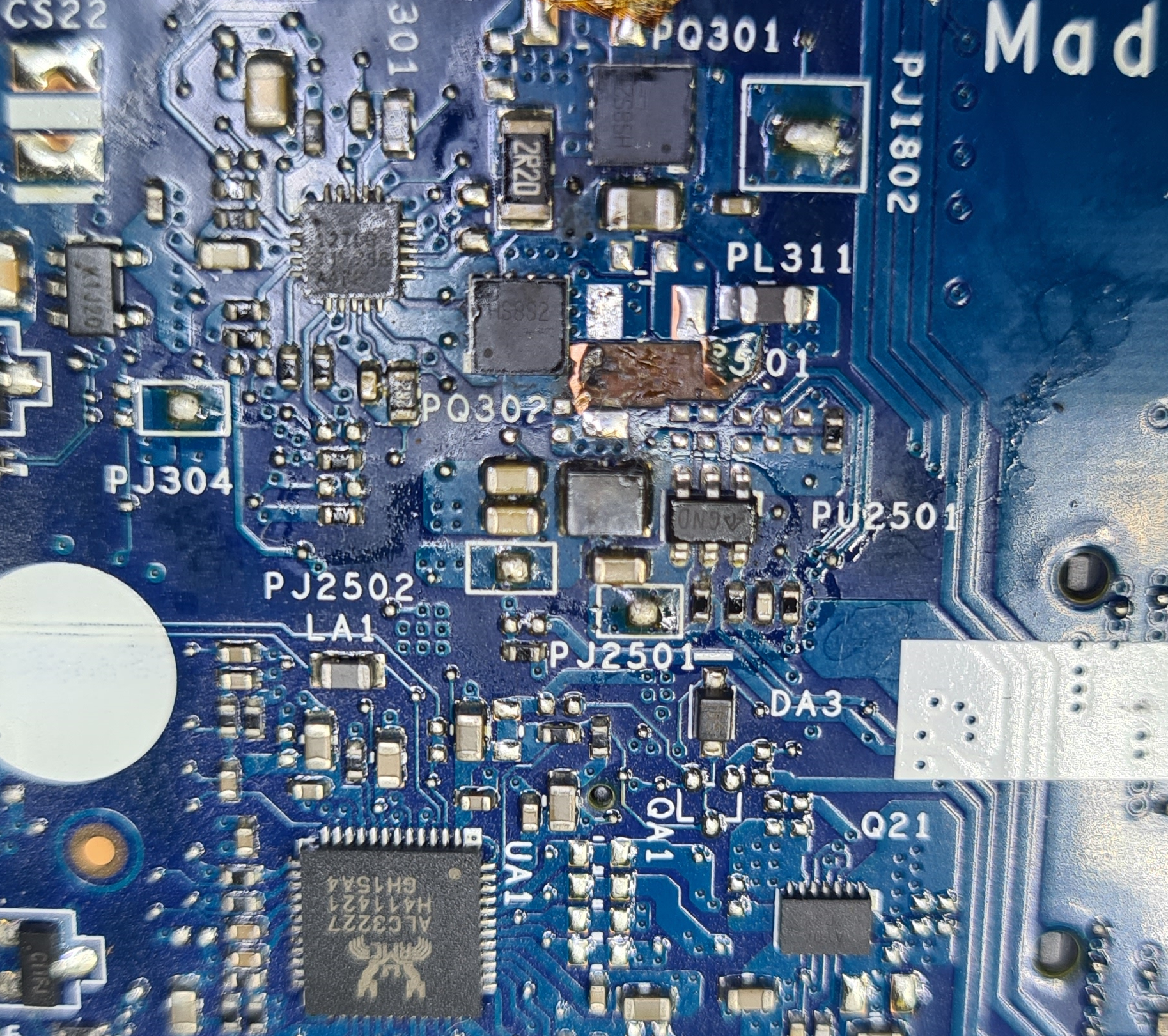

    I fix it
    I just add a new capacitor, rebuild trace and change the mosfet. It's working now

      Re: Bad serie... My HP crashed. Board damages
      make sure to isolate everything with solder mask.
        Yes, i do that. All is allright. Thank you
