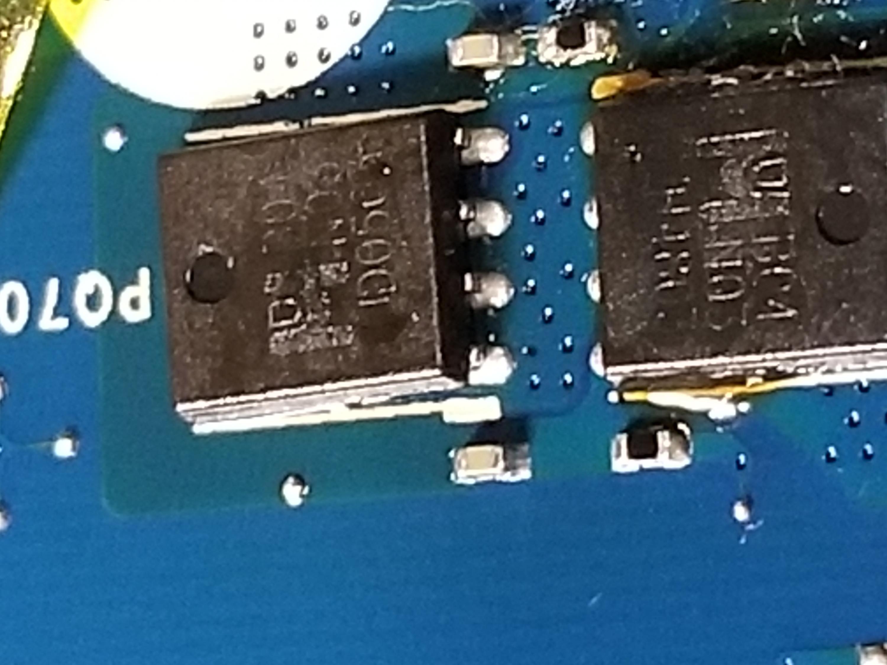

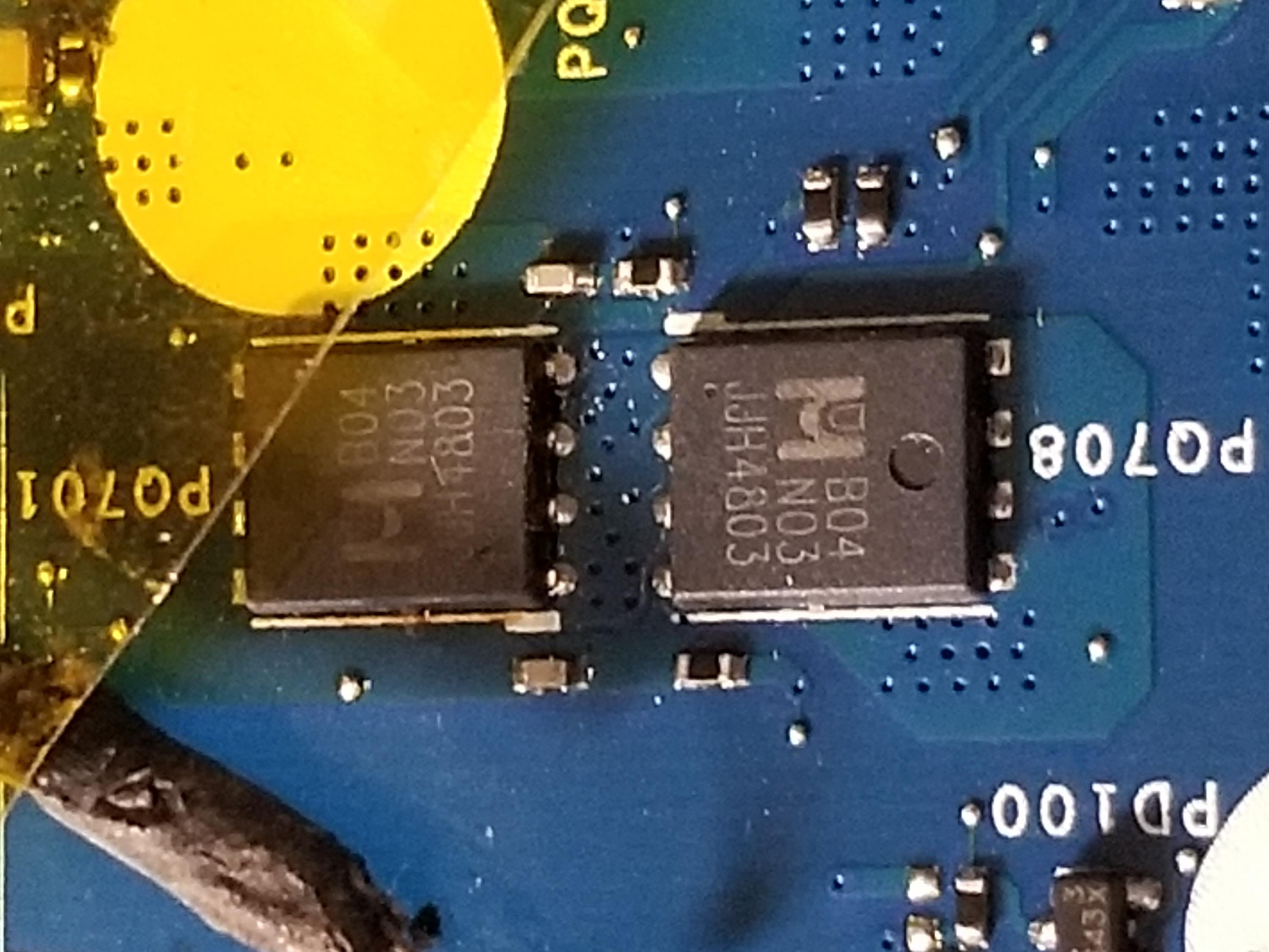

    This is what both the bottom ones are, maybe I'm not finding the right datasheet or something.. That's pq701 and pq708.
    And yeah I see the tiny dimple now that marks pin 1.. That's annoying lol, I was looking for anything else like that I guess I just missed it. My eyes certainly aren't what they used to be.

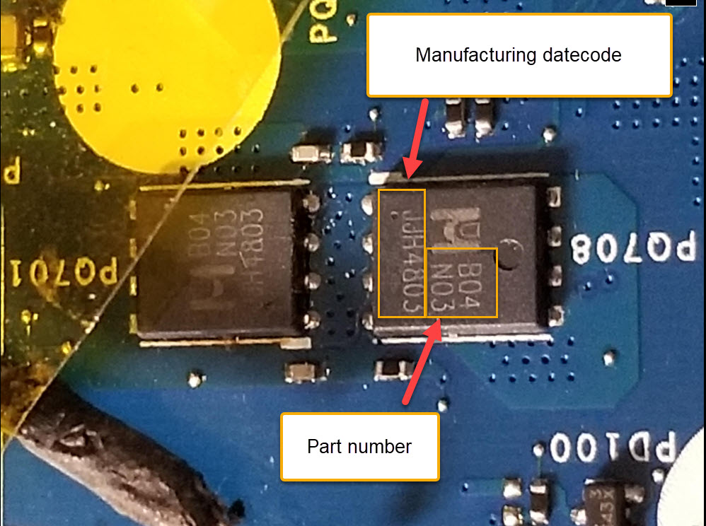

      See attached.
      The datasheet for these mosfets has been posted in the earlier post.

        Okay lol that helps.. I was searching for 4803 mosfet.. Sorry I'm still learning obviously..

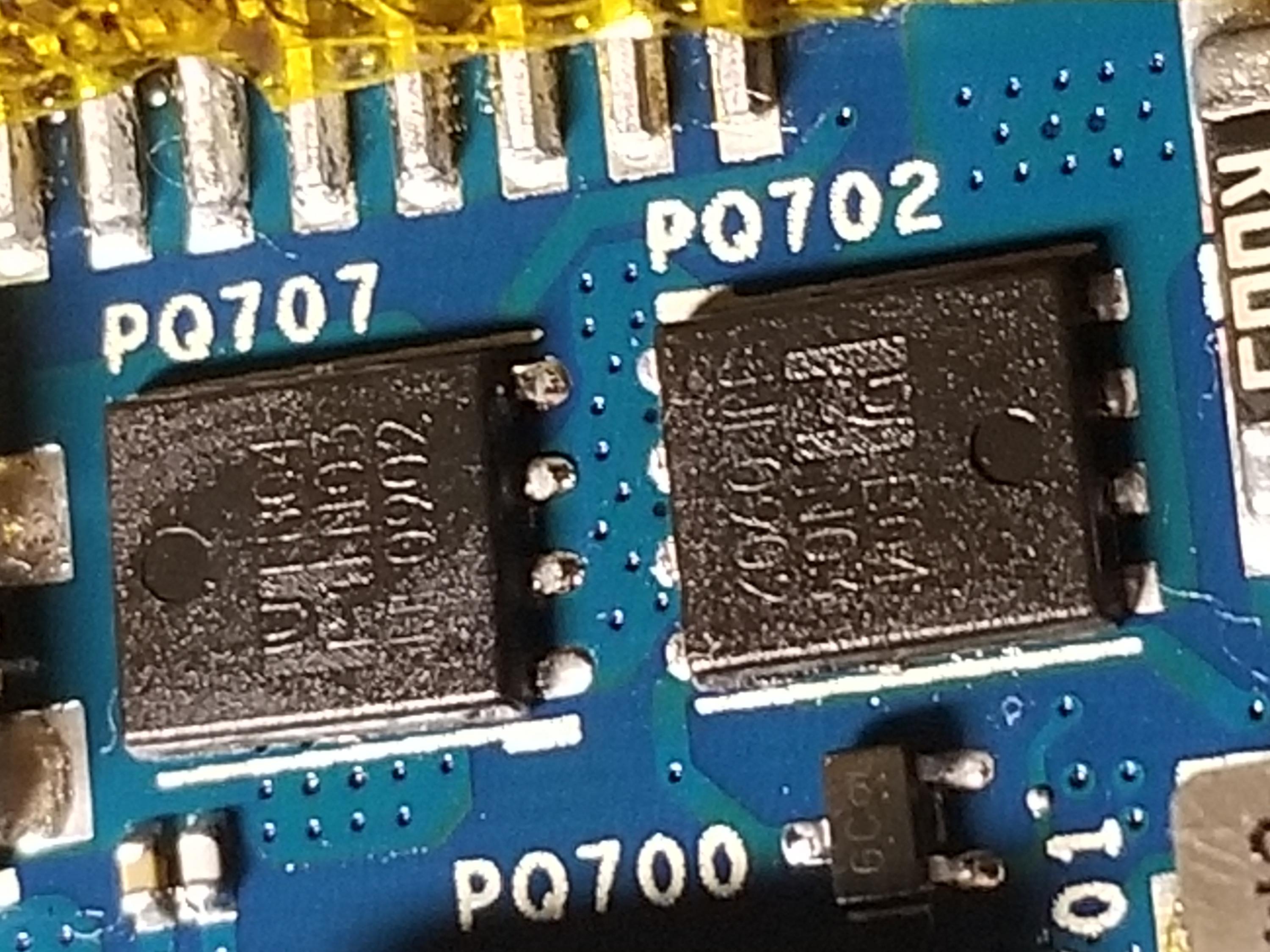

                Alright I pulled pq707, it tested good, so I pulled pq701 next and it tests 3-60 Ohms between source and gate.. And the remaining mosfet (pq708) tests 255K Ohms source to gate. So how difficult are these going to be to solder back if I don't have any paste solder?

                  I pulled one from the donor board from location pq707.. It tests 14M Ohms S - G..

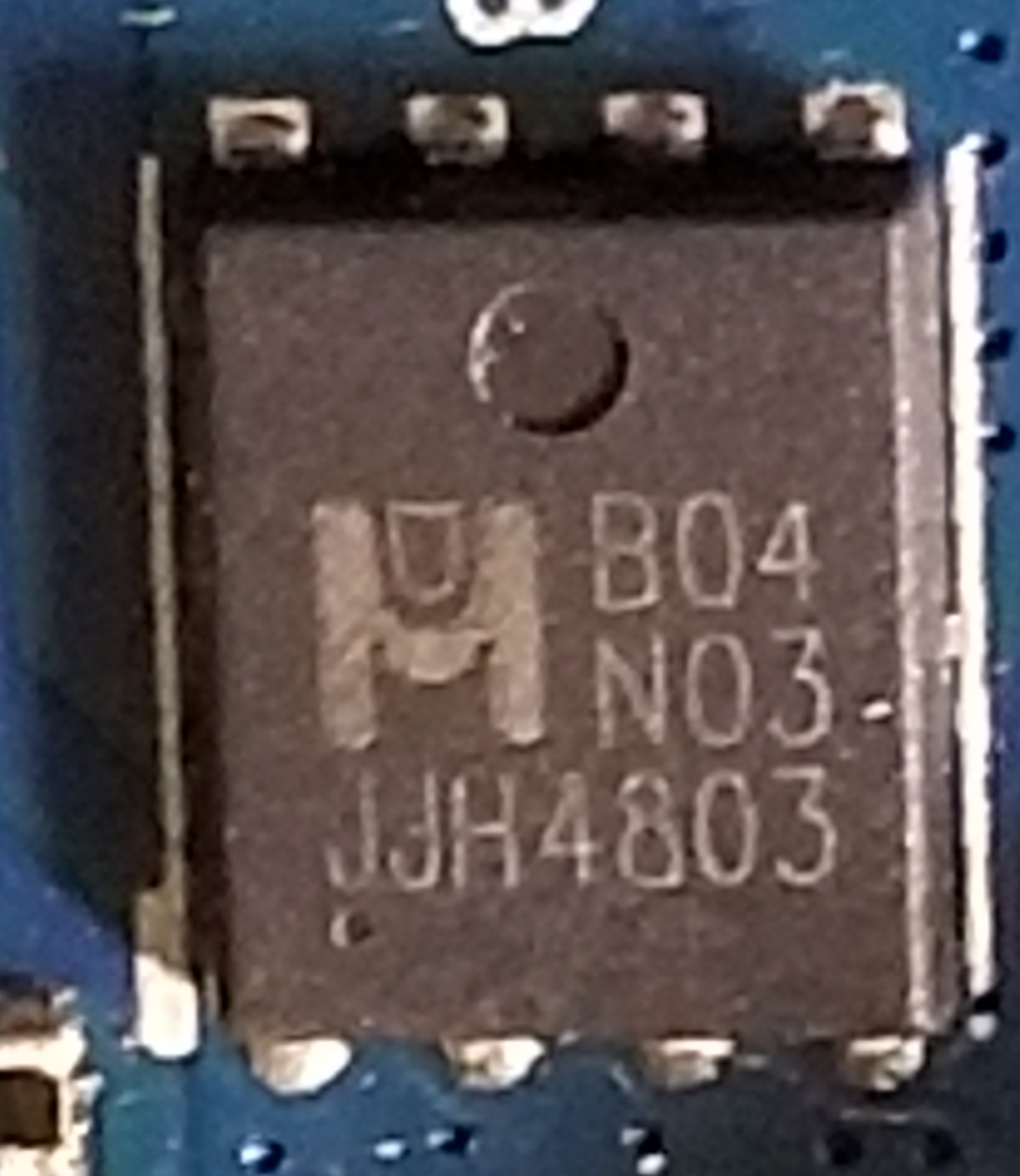

                                      Could one of you guys possibly recommend a part from mouser or digikey that I could order to replace the one I took from my old board? It was labelled B04 N03.. I'll attach a picture of the chip for reference..
