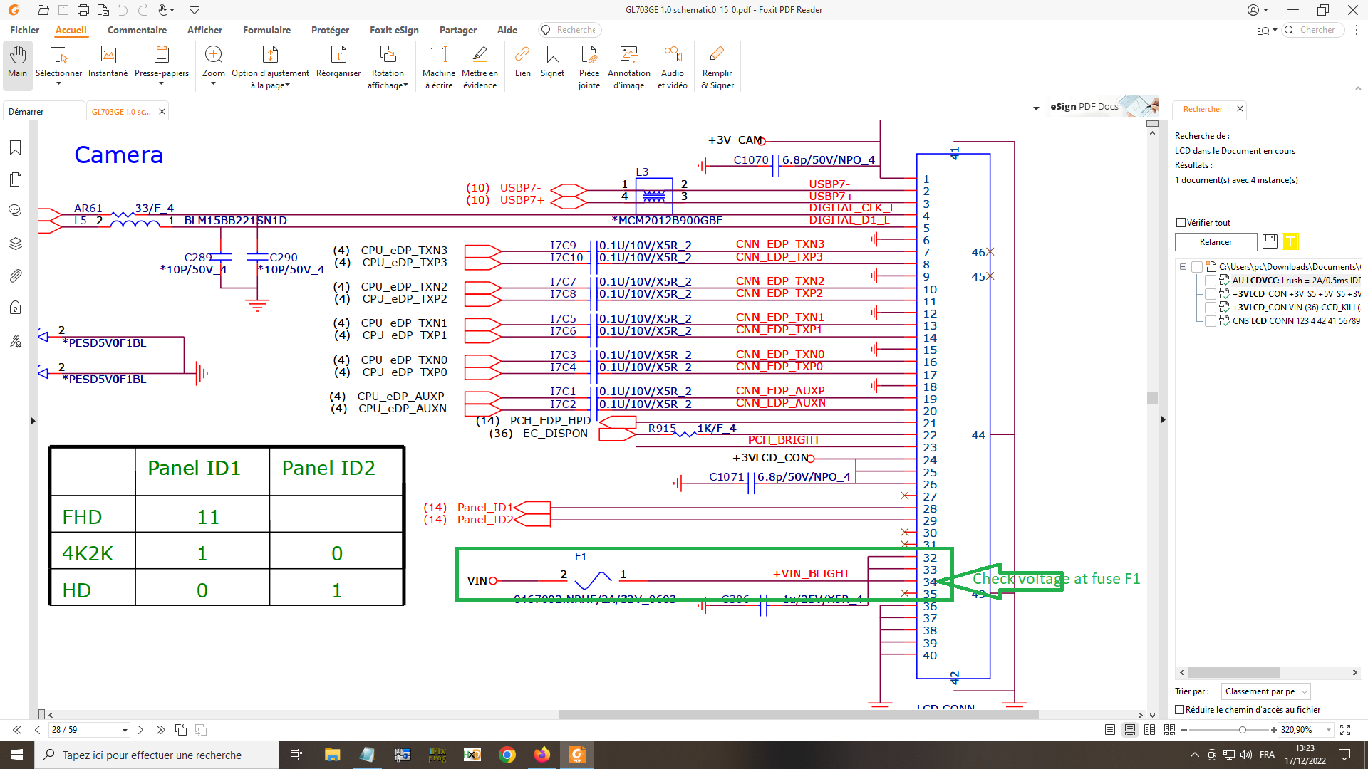

    One has a LCD Backlight issue (I got the Board Diagram which I'm uploading right now). Starting to learn this skill, already done some soldering jobs but nothing small in size. I would like a bit of help on what to look since I already discarded the LCD and the LCD is working as it should.

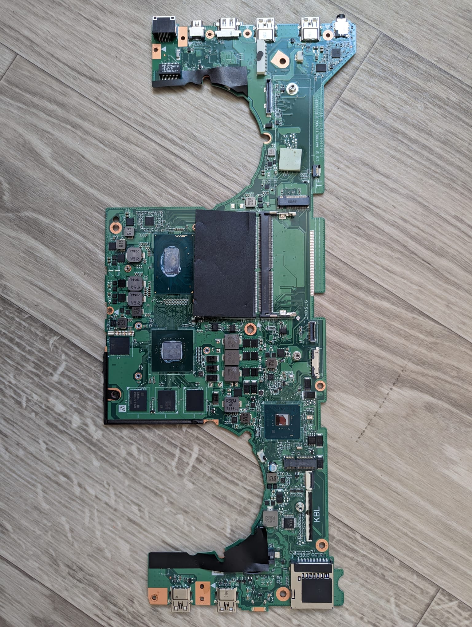

    So far 1 of the motherboards is working without issues, and I was able to read the BIOS Information with the RT809F Programmer successfully. I believe the issue is with the bios on most of these boards (I think at least 2 or 3) For Example 1 of the laptops will boot into BIOS but won't boot into any storage unit. I tried to use the RT809F with a SOIC-8 Clip to read, backup and write the BIOS chip with the BIOS from the good motherboard but It fails to program the chip. I think It fails on all of them on the verification process. I'm thinking I should desolder the chip. What are your thoughts on this?
    Edit: I also forgot to mention if the small Windbond chip on the bottom right is the BIOS Chip. I believe that's the one but I might be mistaken.

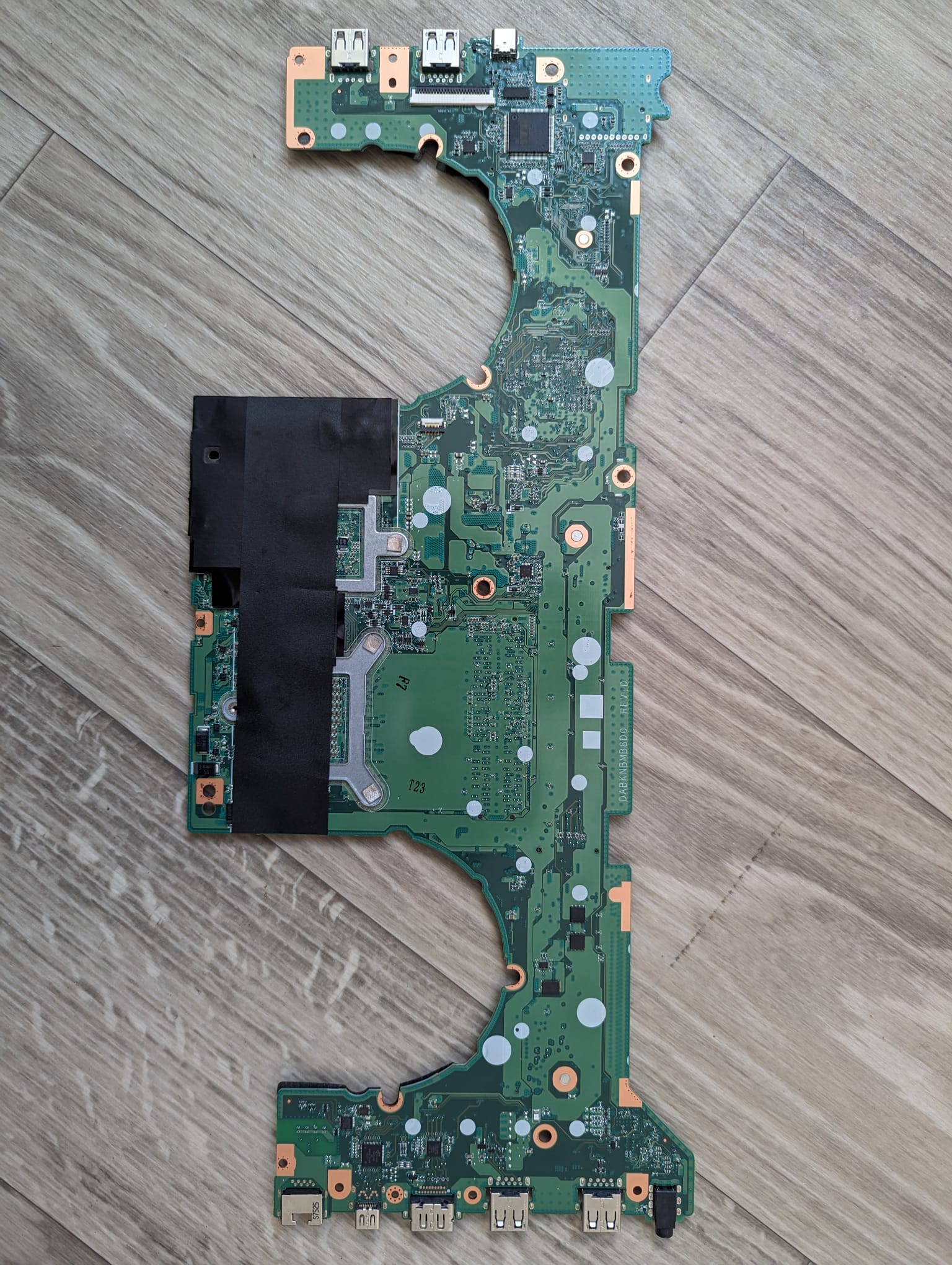

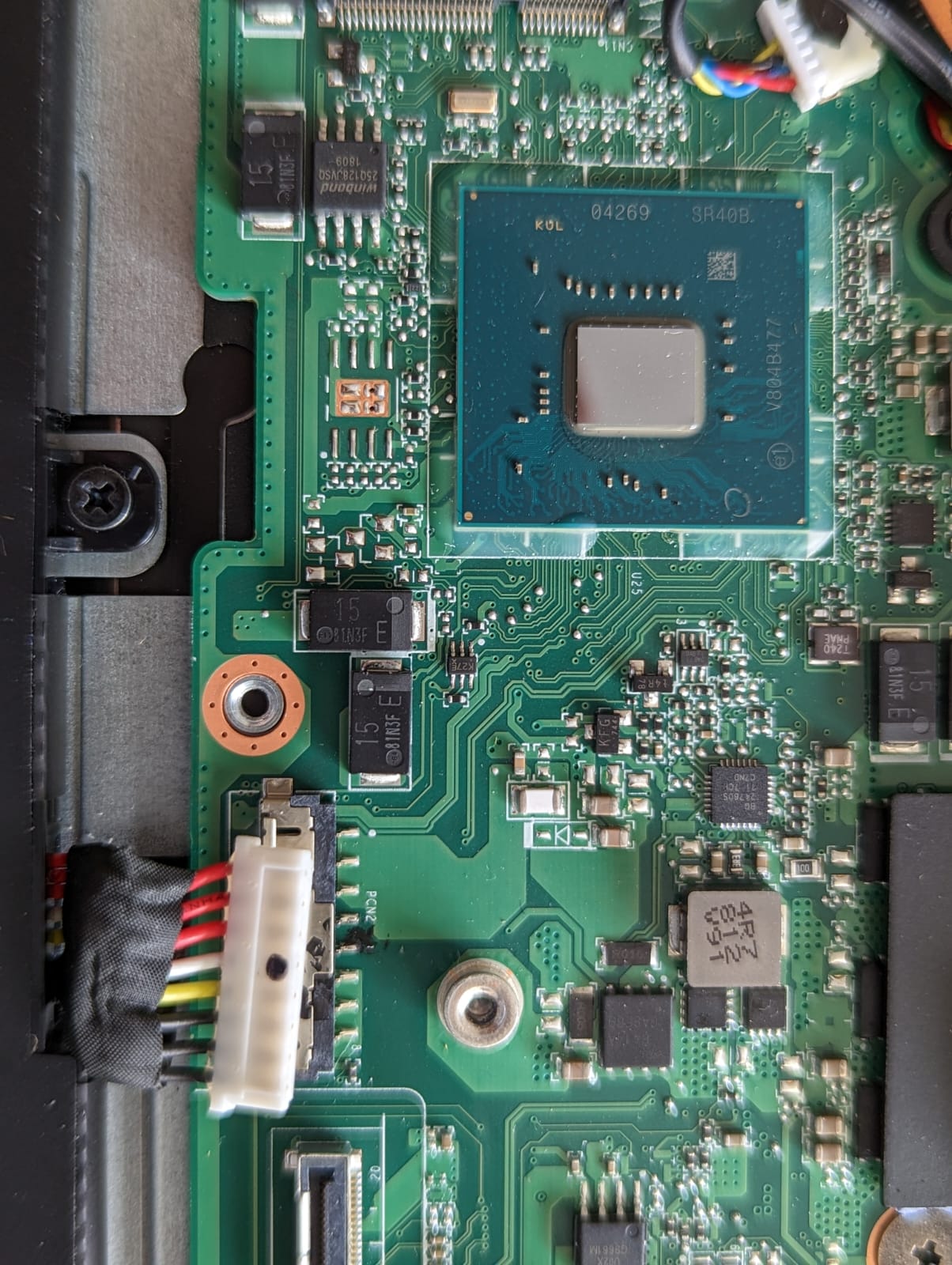

    Here is also 2 extra pictures one motherboard as a reference (This one has the Chipset Die broken lol).

      You can't reliable dump nor program the BIOS without desoldering the flash from the motherboard and soldering it onto a dedicated programming board. Clamps often result in corruption.
      The board with the back-light issueightnjave just 19V at the display connector missing. I'd start there.

            For no backlight issue,start by reading voltage at fuse1

              For backlight check the enable signal and the main voltage
