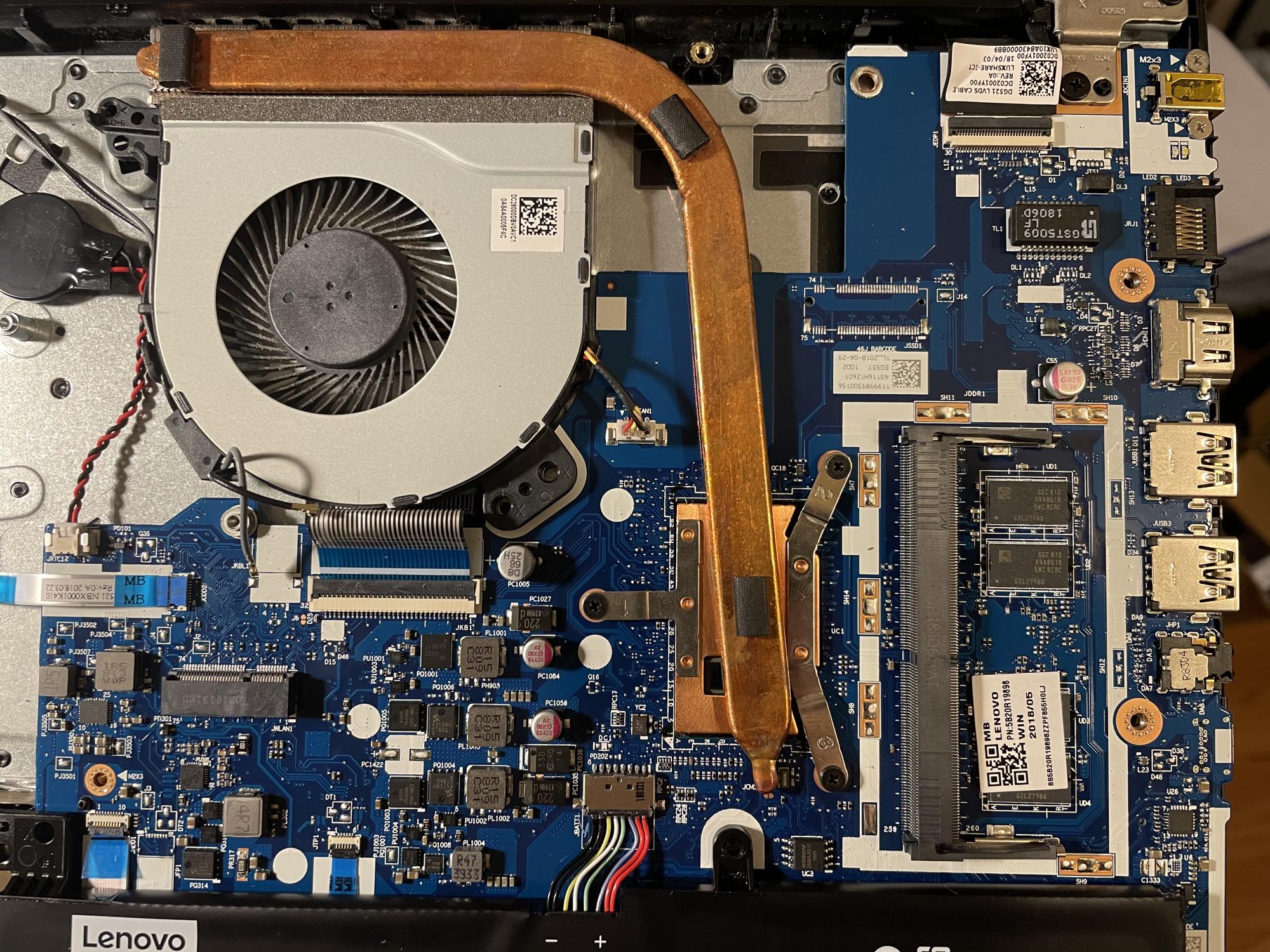

    Hi guys. I've used the forum a lot but never asked questions before. I had a Lenovo come in that was shorted on the 20V rail. I fixed that and thought my job was done until I realized it wasn't charging the battery. Here is what I've checked so far
    On the BQ24780SRUYR charging ic
    VCC 20V
    SMBUS lines
    SDA 3.3V
    SCL 3.3V
    Current Sensing lines
    ACP/ACN 2.3 ohms
    SRP/SRN 21.2 ohms
    REGEN line 6V
    PHASE .84V with no battery installed(this may be normal)
    PHASE xxV with battery installed voltage is slightly higher than battery voltage.
    Originally the battery was completely drained so I charged it with my DCPS. The machine will work on battery power. When the ac adapter is first plugged in the battery icon in the lower right shows that it is charging and it shows the battery filling up over and over for about 10-20 seconds. Then it stops but still shows that the battery plugged up. I do not get a message saying not charging. Feel free to let me know what I haven't checked. I have not tried a new battery yet because this battery seems okay.

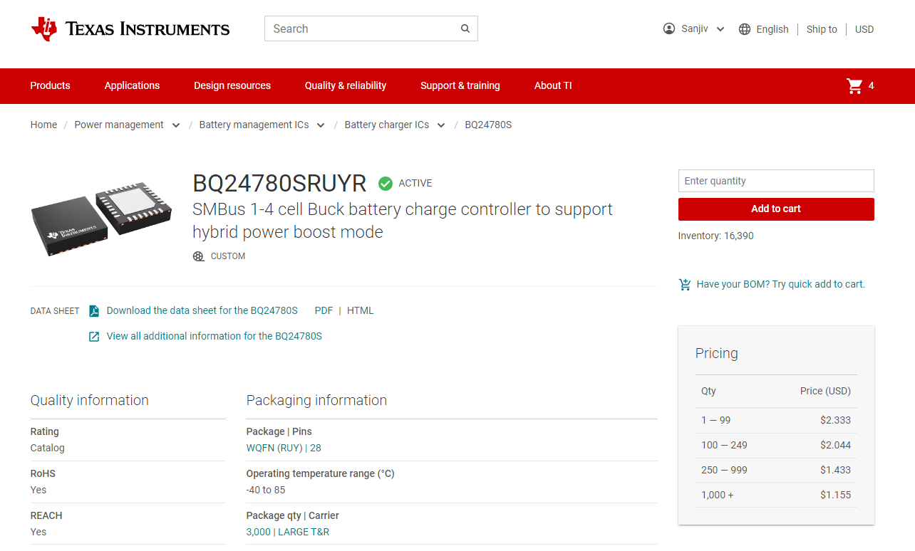

                I did read that but I just wanted to ask. I’m still new to some of this. Now to locate a replacement that won’t take a month to get here.
                • mon2
                  • Dec 2019
                  • 14238
                  Re: Lenovo Ideapad 320-15IKA NM-B452 not charging battery
                  Now to locate a replacement that won't take a month to get here.
                  Aliexpress is not too bad but yes it *may* take longer than sourcing locally.
                  See attached. TI has stock of the part at this time of writing. While you are at it, consider to buy drop in replacement mosfets for the same repair. If TI has them in stock, the part will be great as spares for your parts drawer.

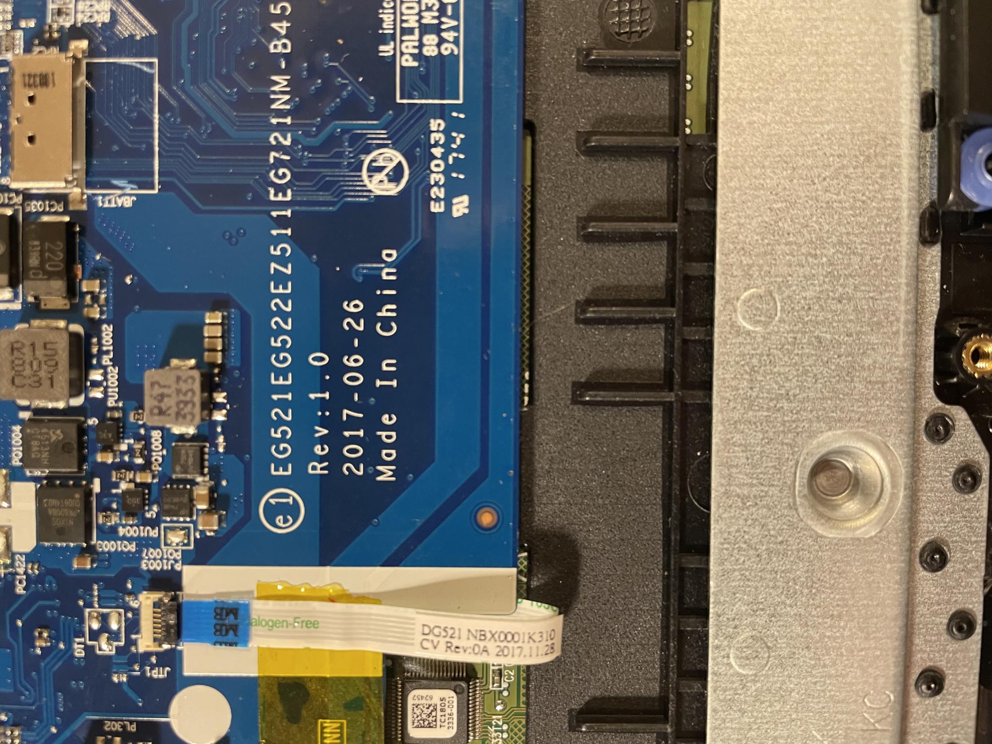

                            Hello team, I am having same charge battery issues with the same model.
                            The SRN_R line was blown internally at the pcb and the pcb was lifted a bit at that spot.
                            So far I have cut both lines SRN_R & SRP_R just to be sure and connected them by cable to PR317, replaced PR338, PR328 & PU301, checked PQ311 & PQ312.
                            ACDET 2,66V
                            ACOK 3,32V
                            ACDRV 24,11V
                            ILIM 0,84V
                            SDA & SCL 3,33V and connection to kbc & battery
                            HIDRV 7,44V with battery voltage 5,85V or 7,80V with 6,15V [second battery]
                            I have orange flashing led 3 times for as long I have a battery connected.
                            I can find nothing wrong with it, any help will be appreciated.
