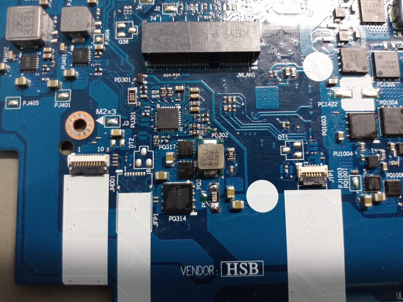

          Re: Lenovo Ideapad 320-15IKA NM-B452 not charging battery
          ok, this time I have some photos too.
          So far I have replaced again the PU301, both dc-in mosfets and the KBC.
          First picture shows the PU301 area with the new lines at the shunt resistor.

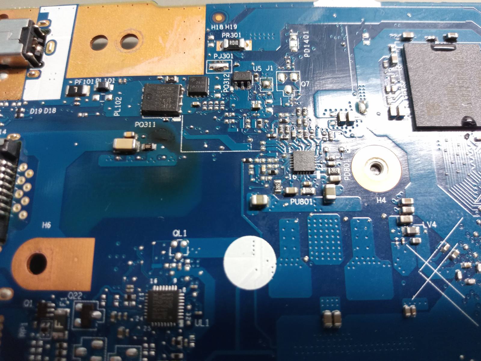

          Second picture shows the board at the other side of PL302 which has a lift [where the green solder mask is]

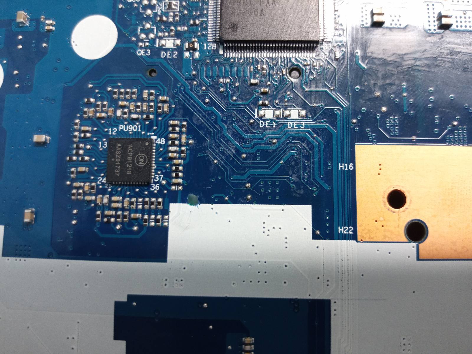

          Third photo shows probably what caused the issue, it has burned lines from the lan and a lift at the spot there...

            You must see 25V on the ACDRV Bro. Change PQ311.
