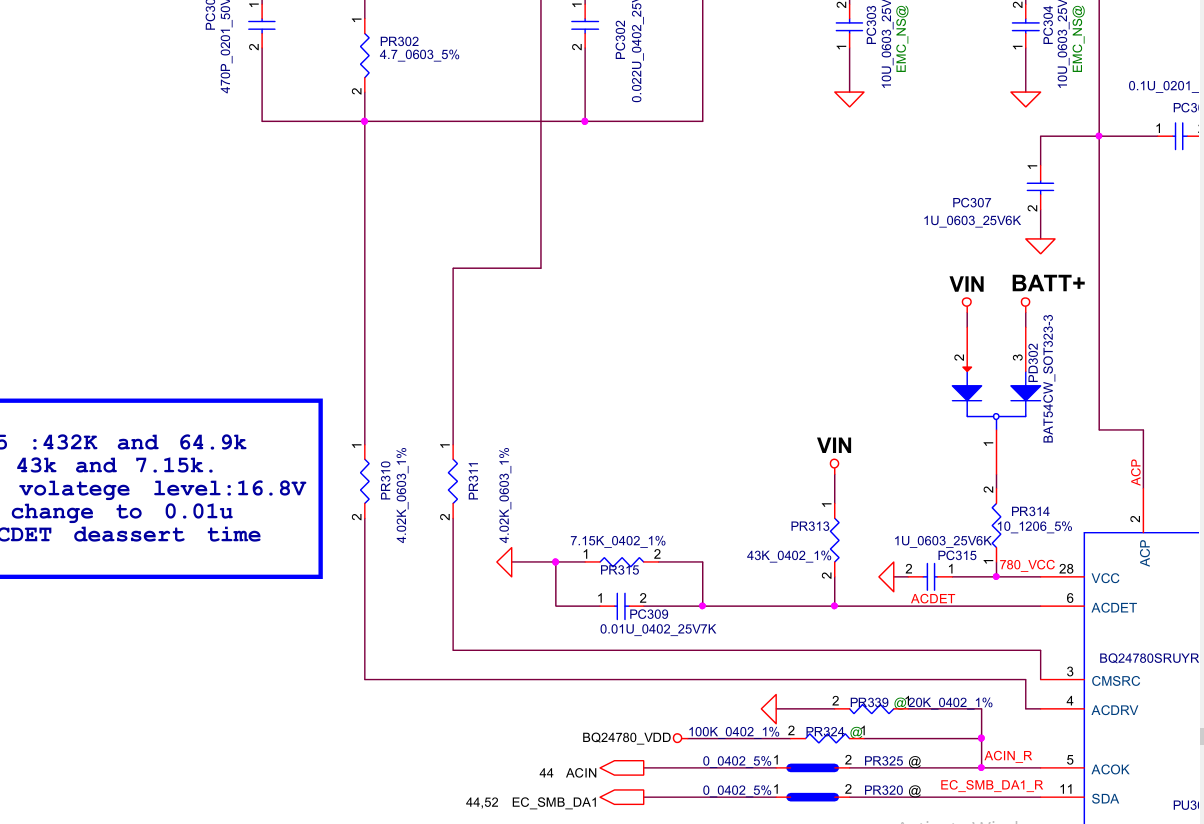

                            schematic attached.

                              See attached.
                              1) Charger IC is a typical TI (BQ series) IC and is driving n-channel mosfets.
                              2) Carefully, with the power adapter connected - measure the voltage of:
                              pin # 4 = ACDRV (PU301)
                              This is the same voltage that is used to ENABLE / DISABLE the DCin mosfets.
                              3) Confirm that the resistor @ PR310 is present. With the power OFF -> confirm this resistor is ~4k ohms and that it does indeed mate with the mosfets.
                              4) Carefully, measure the voltage on each pin of PU301.
                              Do you have a voltage @ REGN ? (pin # 24)
                              This pin should be ~6 volts if all is well with PU301.
                              Post each measurement.

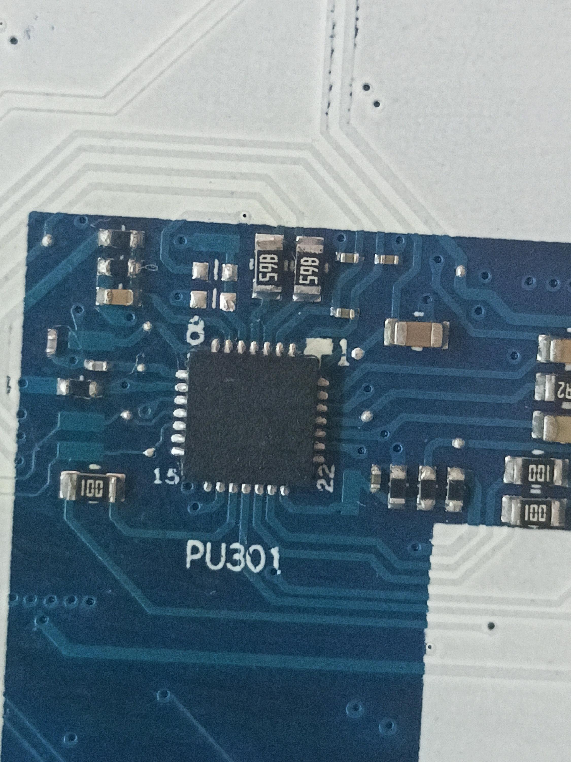

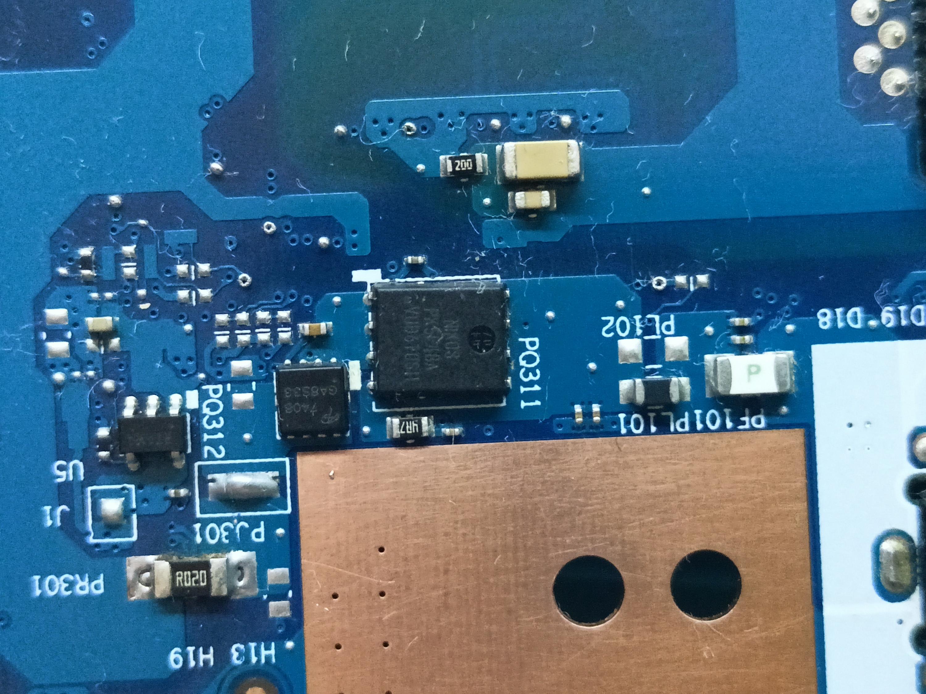

                                      Here are the pictures the are I have worked so far.

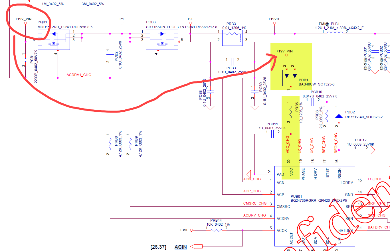

                                        Re: LA-C501P No ACDRV??
                                        Pin20:0.13v
                                        From the voltage on pin # 20 (VCC), the charger IC @ PUB01 is not being powered.
                                        See attached.
                                        Review the parts that have been highlighted.
                                        The dual diode and series resistor must be present and working to allow for the raw ~19v to reach this charger IC to power up this logic board.
                                        On a normal logic board, pin #20 should be ~19 volts. Confirm it and update this thread.
                                        Start with the voltage check on each pin of PDB1 (dual diode). Pin #1 should be about the same as the adapter voltage.
