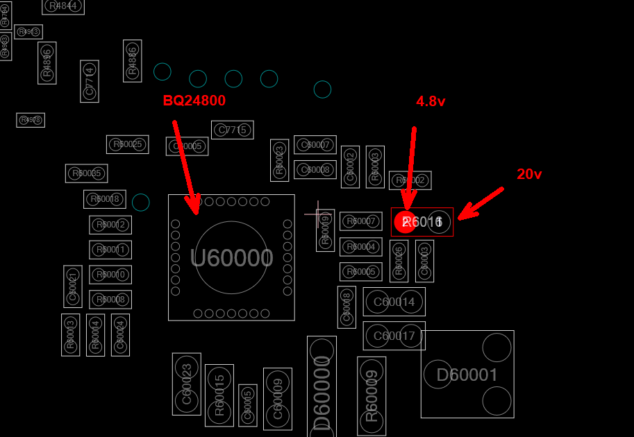

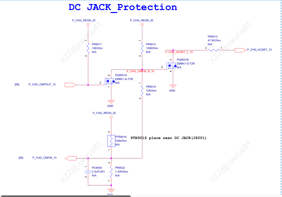

    Hi all, I have a Asus TUF Gaming F16 (2024) FX607J motherboard with liquid damage. The oxide on the board was removed before giving it to me. This made it more difficult to repair. Also they did not give me the power supply.
    When I connect the 20 volts with the bench power supply I get 4.3 volts on the main power line. If I remove the power sensing resistor I get 20 volts on one side (first 2 mosfets are ok) and 4.3 volts on the main power line (see photo). How is this possible?? I thought the 4.3 volts was coming from the battery mosfet so I unsoldered it and tested it. It is ok too. I also checked the 2 mosfets that charge the battery and they are ok.

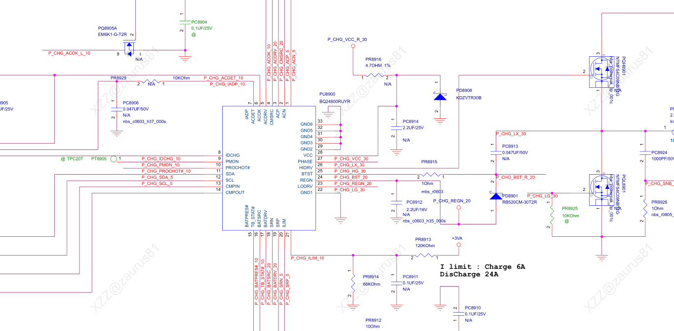

    The IC that manages the first two mosfets and the battery charging is the BQ24800. These are the values I get on the pins of the IC with the sensing resistor removed.

    When the sensing resistor is present I have completely different values on the IC and ACDRV from bq24800 is absent.
    I also checked the integrity of the ACP and ACN lines that start from the ic and arrive at the sensing resistor. The lines are not interrupted (i read a topic in this forum ).
    Attached you will find photos and bordview of the board, thanks in advance to anyone who will answer.

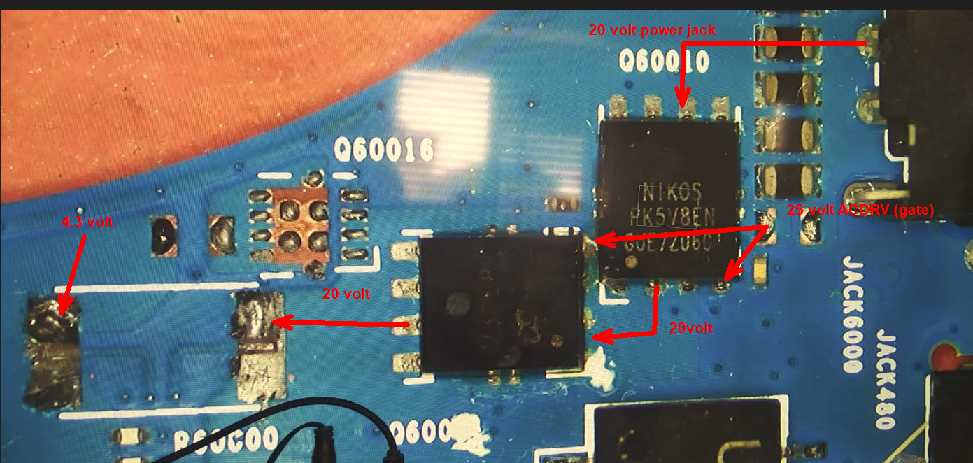

            Power up. Now the DCin mosfets are supposed to be OFF. What do you measure now on the ACP and ACN pins?
            • zaurus81
              • Feb 2021
              • 67
              • Italy
              See photo for results. 4.3V and 0.3V
              thx for your patience

                Remove the 2nd DCin mosfet off the board. After you do this, measure the voltage to ground on each pin on the remaining 1st DCin mosfet.
                When the 2nd Dcin mosfet is removed, allow it to cool down on your work table. Then, meter in resistance mode.
                Measure the removed mosfet as follows:
                source (1-2-3) & drain (5-6-7-8)
                source (1-2-3) & gate (4)
                gate (4) & drain (5-6-7-8)
                Post each measurement. With the 2nd dc in mosfet removed, do you still see a voltage on ACP or ACN? If yes, for sure the charger IC is defective and must be replaced. Suspecting the power path for this leakage is through the Vcc pin on the BQ charger IC.
                • zaurus81
                  • Feb 2021
                  • 67
                  • Italy
                  Voltage to ground of 1st DCin mosfet are:
                  Gate 25V (i have resoldered 4.2K resistor in series on ACDRV line)
                  Drain 20V
                  Source 20V
                  Here the values of 2nd Dcin mosfet out of the board:
                  source (1-2-3) & drain (5-6-7-8) ----> 0L (with inverted probes 3.6Mohm, i don't know why)
                  source (1-2-3) & gate (4) --------------> 0L
                  gate (4) & drain (5-6-7-8) --------------> 0L
                  I also checked the mosfet in diode mode. I read the voltage drop of the diode integrated in the mosfet from source to drain (red probe on the source and black on the drain, N-channel). Also when I apply the red probe to the gate and the black to the source I get conduction between drain and source (0.002). This indicates that it is working.
                  With the 2nd dc in mosfet removed, i see same values (see photo).
                  Looks like I need to buy a new bq24800.

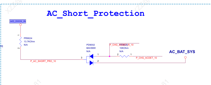

                    Disconnect the battery (if it is connected). Connect the external power adapter. Measure the voltage to ground on each pin of the commonly used dual diode on the Vcc pin 28 of this IC. This is a dual common cathode diode with one leg feeding the power adapter voltage; other leg feeding the battery voltage to power this BQ charger IC.
                    Confirming if this dual diode is leaking and causing this mystery voltage to appear onto the ACN pin. Test all 3 pins on this dual diode.
                    • zaurus81
                      • Feb 2021
                      • 67
                      • Italy
                      In photo you read voltages values to grounds of each pin of this dual diode.
                      In diode mode i read 0.289 voltage drop for each diode (red probe to anode and black probe to cathode). Reverse it give me 0.L.
                      If you need i post boardview on appropiate section
                      • mon2
                        • Dec 2019
                        • 14571
                        This dual diode appears to be ok. Replace the charger IC and do update this thread.

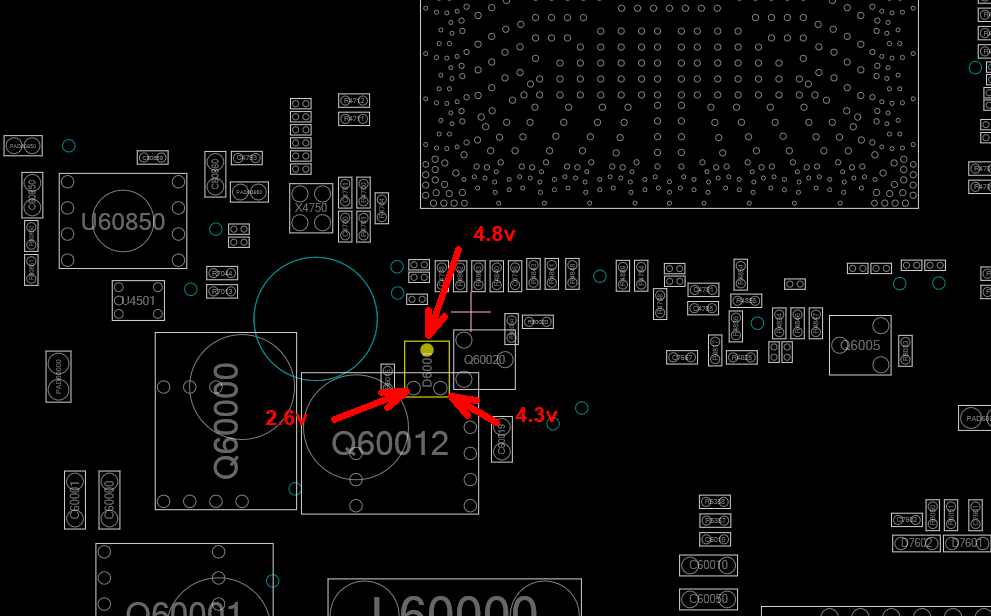

                                Here I am. New bq just installed. Nothing changed. I still have 4.3 volts on the main power line with the sensor resistor removed from the board
                                • zaurus81
                                  • Feb 2021
                                  • 67
                                  • Italy
                                  20 volts coming from the power jack (PVADPTR line) goes to the diode D6001 passing through the resistor R6016 (13.7K). This is a switching diode (datasheet) and this is where the 4.3 volts are generated. By removing the diode I no longer have 4.3 volts in the sensing resistor. I tested the diode out of circuit and it seems ok. Unfortunately I don't know what function this diode performs and if it is doing its job. See boardview

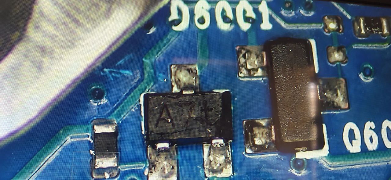

                                    Post a clear pic of D6001. Wish to confirm the smd markings to confirm against the diode datasheet.
                                    Continue to trace each pin of the mystery rail. This would have been helpful earlier.
                                    • zaurus81
                                      • Feb 2021
                                      • 67
                                      • Italy
                                      Smd Marking code is A7t. I found this diode in another asus schematic. see photos
                                      • mon2
                                        • Dec 2019
                                        • 14571
                                        That is a great find! Was hunting for the same but could not find it. Which schematic are your referencing with this partial screen grab? It can help us debug your case.
                                        Leave this diode off the board. Without this part - is the board able to operate normally?
