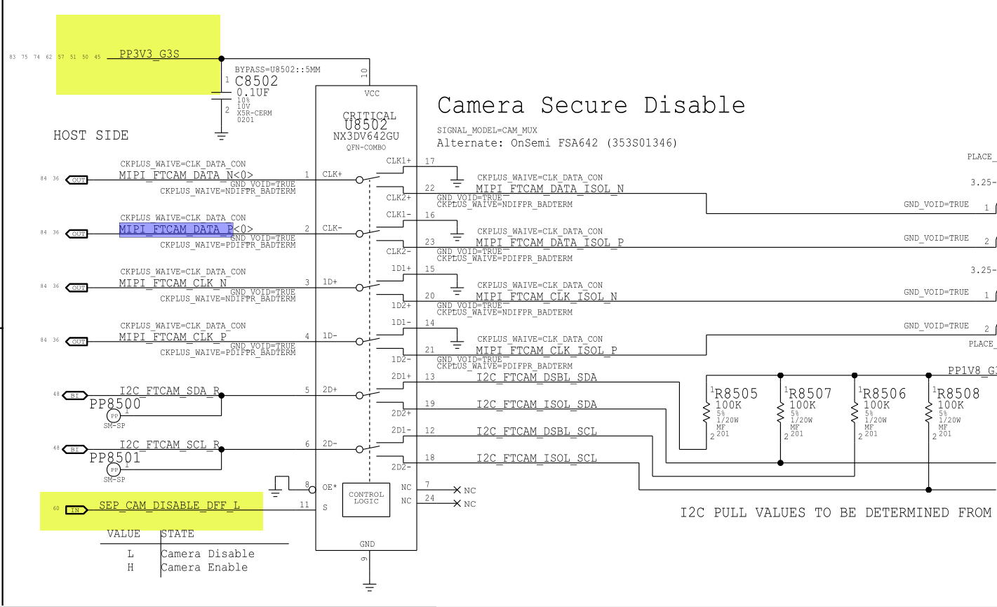

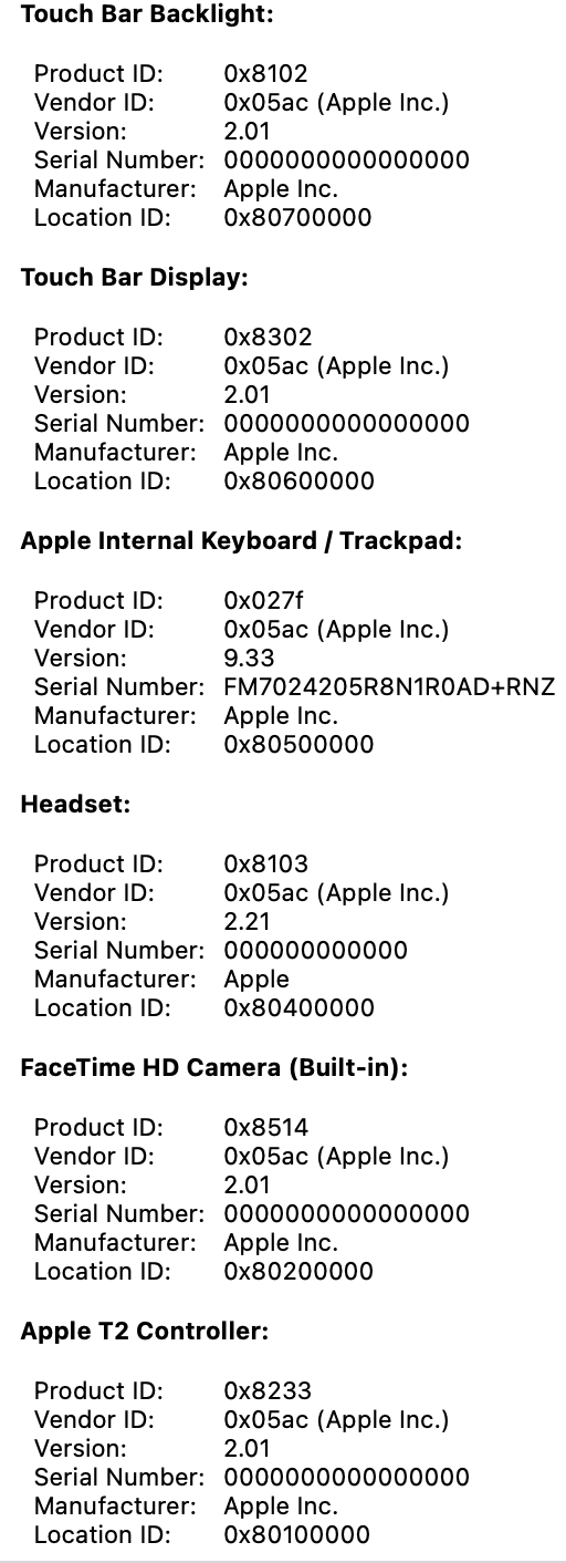

    Hi everyone. I have this laptop after water damage. The main board wasn't really affected apart from a slight residue but components seem unharmed, but trackpad was very corroded and had to replace a few components. The problem is that the ALS ambient light sensor isn't working as well as camera. Sometimes even my screen image goes blank with backlight on and I have to close the lid and reopen it. I believe there is some issue with communication as
    MIPI_FTCAM_DATA_P,
    MIPI_FTCAM_DATA_N,
    MIPI_FTCAM_CLK_P,
    MIPI_FTCAM_CLK_N,
    They show 0V all the time. The I2C_FTCAM_SDA_R and I2C_FTCAM_SCL_R have 1.8V Also when I go to System information the APPLE T2 BUS doesn't have any serial numbers apart from Apple Internal Keyboard / Trackpad, rest are all zeros not sure if that's was supposed to be or not.
    I also had to reflow the LCD board as the screen wouldn't turn on at all and I noticed when I heat it up slightly it starts to work. Where or what should I be looking at?

    Re: Macbook Pro 2020 Touch Bar A2289 Ambient sensor and camera not working
    See attached.
    There is a security MUX IC @ U8502.
    Confirm the voltage and the ENABLE pin # 11 voltages.
    Consider to flux and reflow this IC if you suspect liquid hit this area.

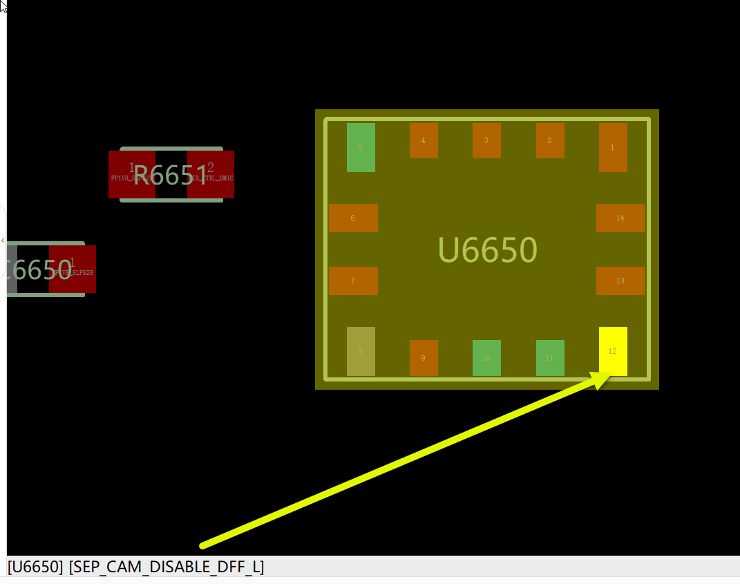

      That's the IC I mentioned. Pin #11 goes straight to U6650 so no way of measuring it unless I take the IC OFF. The I2C_FTCAM_DSBL_SDA #13 and I2C_FTCAM_DSBL_SCL #12 both have 1.8V. I did reflow this IC but probably gonna try removing it completely.
        The Silego part is a DFN package and pin 12 is a corner pin.
        Sometimes, you can see a bit of solder from the SMD pad - can you meter probe pin #12 ?
        Do you have voltages on the MIPI pins on the other side of the MUX ?
        The MIPI pins will only be active after the MIPI CSI camera is enabled. The CSI interface will require the presence of the data & clock lines in addition to the usual power & ground rails.
        Confirm that the inductor / EMI filters @ L8502 & L8503 are in tact.
        What is the voltage of PP5V_G3S_ALSCAM (pin # 46 of J8500) ?
        Do you see a voltage on the I2C_FTCAM_ISOL_SCL / SDA pins ?
        The actual MUX may need to be replaced.
          Originally posted by kuba2102
          MIPI_FTCAM_DATA_P,
          MIPI_FTCAM_DATA_N,
          MIPI_FTCAM_CLK_P,
          MIPI_FTCAM_CLK_N,
          If that's the MIPI you are asking for then no they all show 0V,
          I2C_FTCAM_SDA_R 1.8V
          I2C_FTCAM_SCL_R 1.8V
          PP5V_G3S_ALSCAM has 3.3V
          U6650 pin 12 has 1.8V
            Sorry - should have been more clear.
            Can you measure to see if there are any voltages between the MUX & the J8500 connector pins for the MIPI CSI camera ?
            Specifically, these are the following:
            MIPI_FTCAM_DATA_ISOL_N and also check MIPI_FTCAM_DATA_ISOL_FILT_CONN_N
            and the rest of the MIPI lines in the same way.
            If even a single MIPI line is damaged, the camera will not work.
            The voltage of the 'S' pin #11 on the mux is required to understand in which side the mux is steering the logic. Perhaps you can see the trace under the black solder mask that can be very very gently scraped to allow for a probe check ?

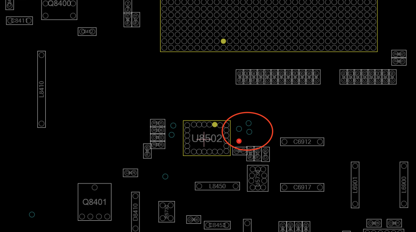

              MIPI_FTCAM_DATA_ISOL_N. 0V
              MIPI_FTCAM_DATA_ISOL_FILT_CONN_N 0V
              MIPI_FTCAM_DATA_ISOL_P 0V
              MIPI_FTCAM_DATA_ISOL_FILT_CONN_P 0V
              U6650 pin 12 to pin 11 U8502 has 1.8V
              I have solid connection from MIPI filters to the ribbon connecting the LCD. Perhaps The LCD board part could be damaged?

                SOLVED: Macbook Pro 2020 Touch Bar A2289 Ambient sensor and camera not working
                Okay after double checking the LCD flex it turned out that PP5V_G3S_ALSCAM line was missing (burned out) i run a short lead for test and the camera and light sensor started working for few minutes but now the line seems to be shorted..

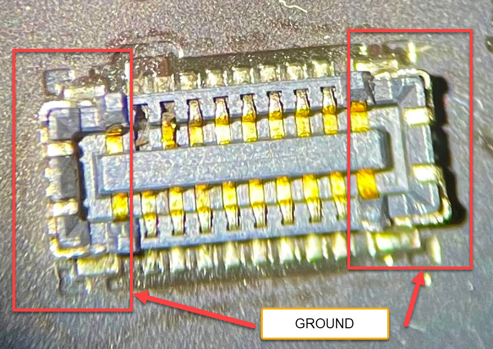

                      I have similar problem, but in my case the connector on display board has corroded and broken pins. Can anyone suggest the type / name of the connector or where to buy it? It looks the same as on A1708 / A1706 display except that on those this type connector is on the cable side not on the display board.
                        Yes, working on a MIPI DSI design and took a while but found the proper names.
                        These are called mezzanine connectors and they do vary in their pin-to-pin pitch. Some are 0.35mm while common are 0.40mm.
                        The height appears to be common. Molex is one vendor but there are tons in Asia since they are making their phone for brand X, Y and Z.
                        How soon do you require the part ? The schematic should reference likely the MOLEX version.
                        What is the connector reference for this component ?
                        See here for starters - again, need to know the pin-pitch; then review if you require the MALE or FEMALE version of this connector.
                        https://www.mouser.ca/ProductDetail/...hoC6ucQAvD_BwE
                        I believe that you require a 20 pin connector where 18 are for signal + 2 for the outside ground tabs but let us confirm this with the schematics.
                          It looks slightly different from the one in your link. Size of it is approximately 5.1x2x0.7mm, pin spacing is 0.35mm. It is a 20pin connector where 16pin are for signal and one in each corner is ground. I believe it is female connector (Receptacle). I am not sure there is a schematic for it as the part is on the display T-Con board.
                            I believe this is your part...
                            0.35mm pitch, 16 contacts (8 per side), receptacle
                            Hirose is one vendor of these
                            Select the 16 pin version of the receptacle and compare the dimensions. Mouser or Digikey should have these.
                            https://www.mouser.com/ProductDetail...88j4CKVQ%3D%3D
                            * Link to the 16 pin version
                            Mouser has these in stock if in a rush.
                            If not in a rush, you can buy them at a lower cost in Asia but will take a few weeks for delivery.
                            See attached for the datasheet.
                              None of those look close to what I need, I have searched the mouser page with no luck. All look similar but not the same. Here is picture of replacement cables for repairing A1706 displays which suffer the flexgate / stagelight issue. The one on the right looks exactly the same as on A2289 screen board and the one on the left look like counterpart on the camera / sensor cable. Could buy these and transfer but that would be a pain to remove it from cable without damaging.
                                You will not be able to salvage the connector from a donor flex cable without deforming the plastic like a chucky-doll.
                                See attached.
                                What part does not match ? Source a few of both the male & female connectors and test their fit to move on.
                                  Ordered the connector but it did not fit as I already thought - could not connect it with the cable, it seem to have slightly thicker center plastic and wouldn't fit on. So still looking to find the right connector.
