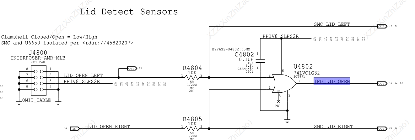

              These are good diode mode measurements for each. If practical, carefully measure the voltage to ground of these same lines. This is to confirm that the mandatory pull-up resistors are being pulled up to their logic '1' state when parked. Also note that the non-working camera / ALS / keyboard backlight will only be enabled when the LCD display lid is detected to be OPEN. This is my understanding. This open / close status is based on a hall effect sensor that operates between the trackpad and the display assembly. In the schematic will be a signal rail with the keyword 'LID' that will offer a '1' or '0' logic level based on the condition of the lid assembly. This signal should be reviewed. If the LID is considered to be closed, the above functions will disable.

                Also measured :
                PP3V3_G3S. - 3,33 V
                SEP_CAM_DISABLE_DFF_L - 1,816 V
                PP5V_G3S_ALSCAM. - 5,14 V
                SMC_LID_LEFT. - 1,810 V
                SMC_LID_RIGHT - 0 V ????????
                IPD_LID_OPEN - 1,816 V
                The measurements where made with the board out from inclosure.
                It ssems there could be some issues with the right LID sensor, but could this affect ALS CAM?
                • nelusab
                  • Aug 2022
                  • 27
                  • România
                  The board has only the left LID sensor, so the value for the right side is normal

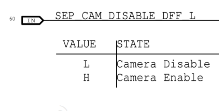

                    What does mean DFF from SEP_CAM_DISABLE_DFF_L ?
                    If it means DEFAULT it sould be in Low state?
                    • mon2
                      • Dec 2019
                      • 14667
                      #30
                      See attached. This signal is used by the multiplexer @ U8502.
                      If this signal is LOW then this state is considered to be true (denoted with the _L suffix in the netname label). That is, this is an 'active LOW' enable. When LOW (0 volts) then the camera is DISABLED and vice-versa.
                      What is the voltage to ground of this signal ?
                      Click image for larger version  Name:	mux_table.png Views:	0 Size:	43.5 KB ID:	3249637
                      • nelusab
                        • Aug 2022
                        • 27
                        • România
                        #31
                        In a privious post is mentioned
