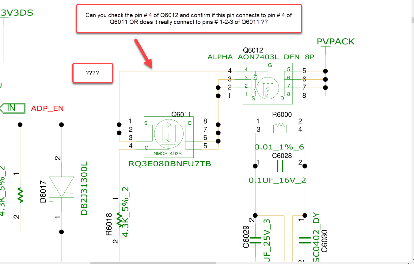

    HP 840 g1 Turning on DC and read 0.070 then goes off simultaneously.
    Pls i also have same issue on HP 840 g1
    At first MOSFET I have 19v at gate comings from acdrive instead of 25v.
    When checked the the charging
    Acdet is 2.6 cmsrc is 19, but vcc is 0v instead of 19v.
    After that, I jumped 19v to vcc then acdive changed to 25v but still no changes to the pc.
    Am having 2.47 at on/off switch pin
    Kindly help.

    Re: HP 840 g1 Turning on DC and read 0.070 then goes off simultaneously.
    1) do you have a battery installed when connecting the AC power adapter ?
    If yes, remove the battery and test again.
    For now, the battery is not required to test the logic board so the battery can be removed.
    2) It is a good sign that the gate voltage is ~25v which is required to turn ON the DC IN mosfets.
    3) Your DCIN mosfets need to be inspected as at least one is defective.
    4) I think the schematic may have errors - check the wiring of the GATE pin on the DCIN mosfets - to me, it does not look correct on how the schematic is showing the GATE trace for Q6012.
    Can you confirm where pin # 4 of Q6012 is truly connected ?
