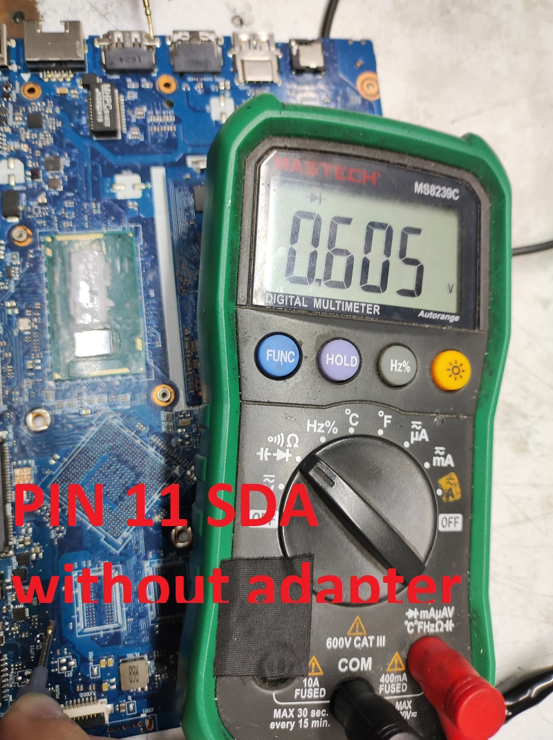

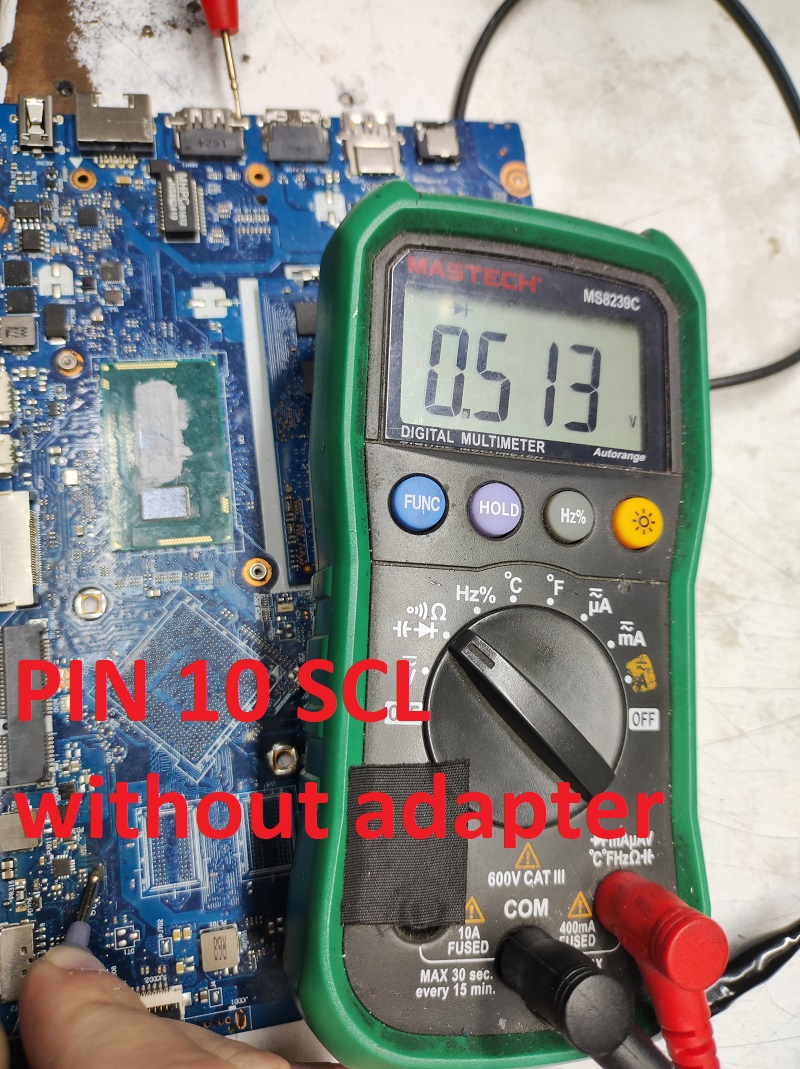

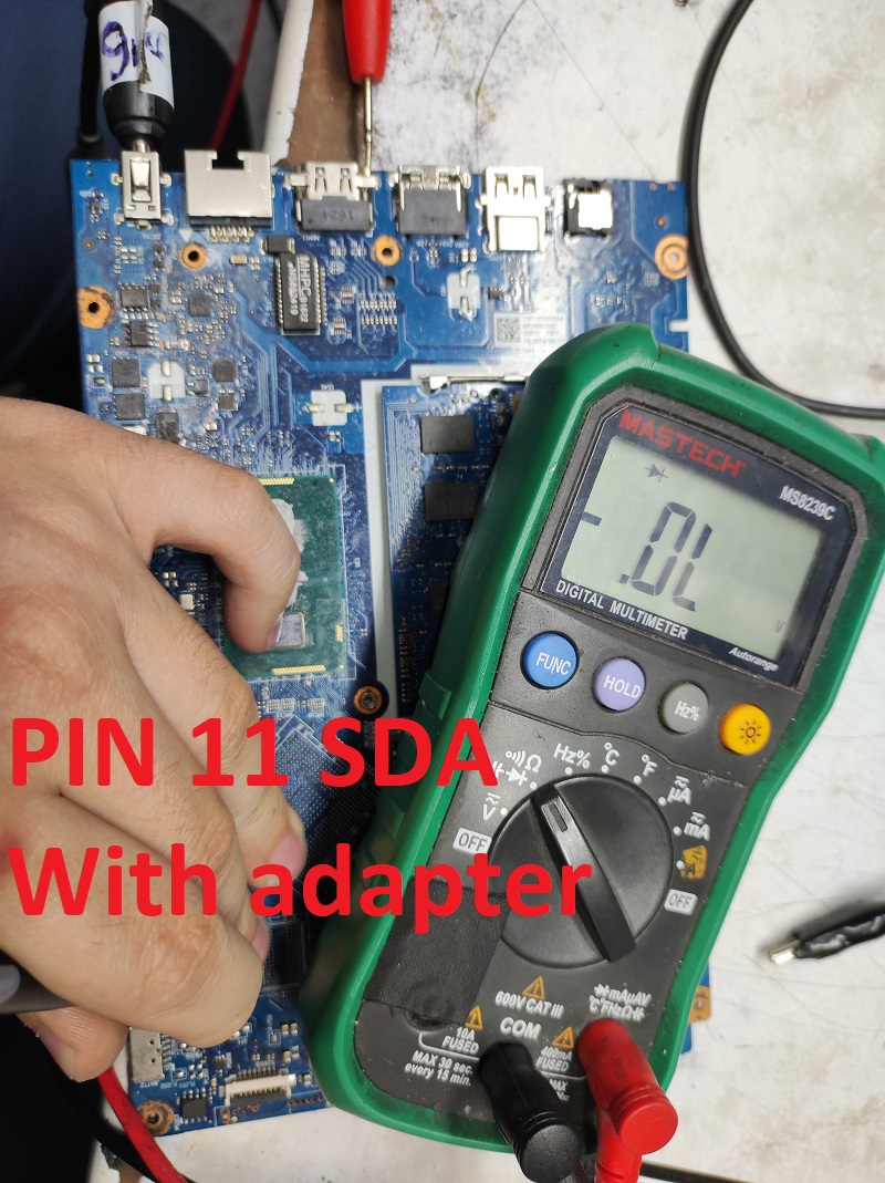

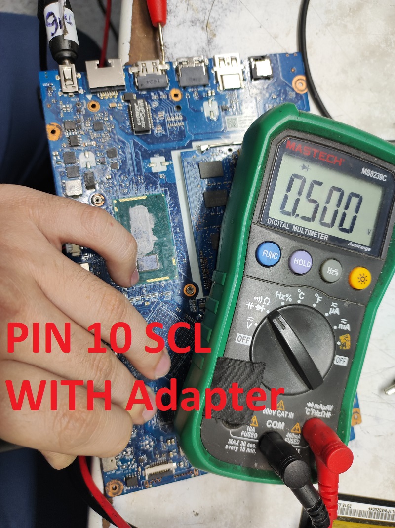

                    Diode mode on photo
                    about pin 10 scl with adapter jumps every 2-3sec 0.300-0.500 diode mode and voltage jumps 2.4v-2.6v
                    • mon2
                      • Dec 2019
                      • 14663
                      Re: LENOVO 100-15ibd NM-A681 Doesn't detect battery
                      DIODE mode = measured always without power.
                      RESISTANCE mode = measured always without power.
                        The photo shows measurements without power.
                        I changed another Ite8586e but the problem remained, the laptop works if you connect the battery and the adapter the laptop turns on and immediately disconnect the adapter, then the laptop continues on the battery but does not see and does not charge.
