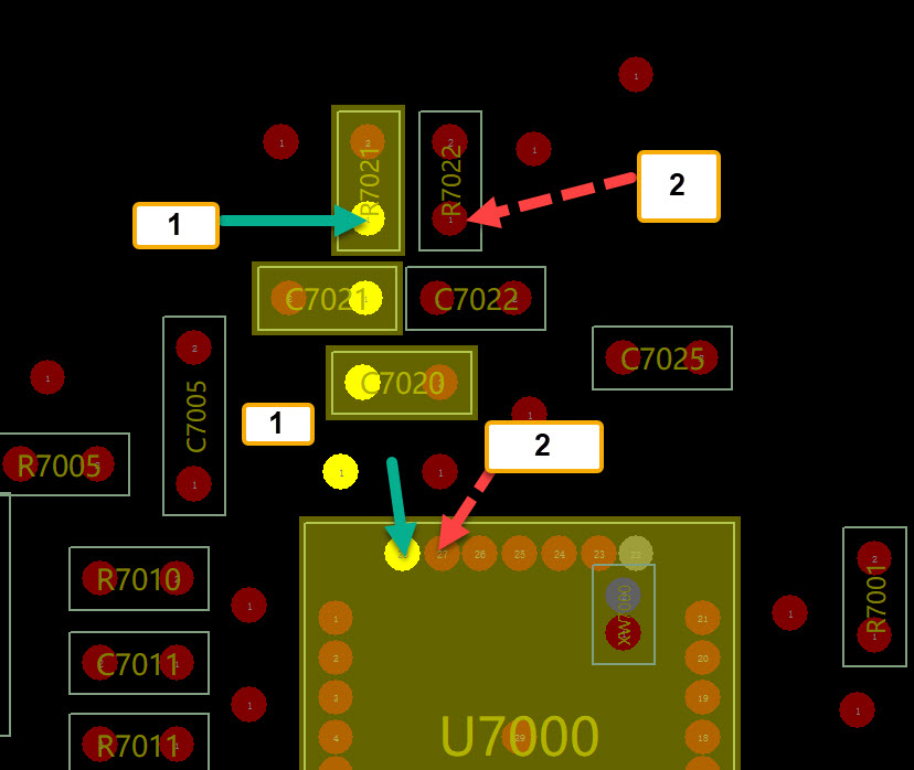

    Measure the resistance from the arrow heads 1-1.
    Then 2-2.
    What are the resistance readings for each ?

      Re: MacBook Pro Mid 2012 turns on, fans spin for five seconds and turns off, repeats
      Sadly I lost first resistor so I will need to replace - it blew away
      For second on the right: 00.5
      • Gigabit2
        • Apr 2022
        • 264
        • United Kingdom
        #63
        For first on left: 00.5 [resistor missing]

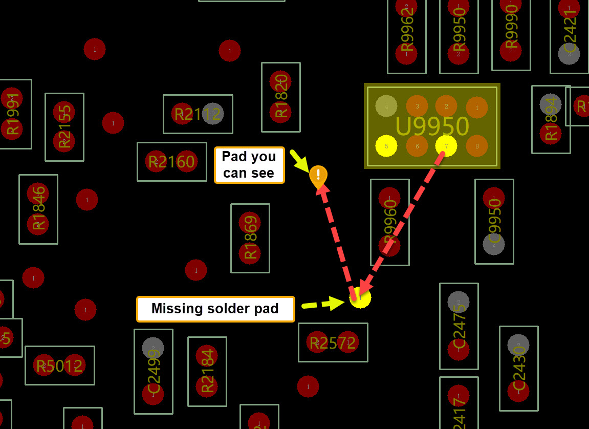

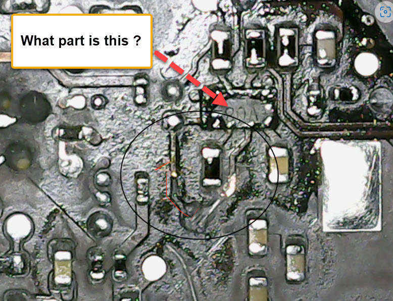

          Whilst looking around board, I did find broken trace but elsewhere.
          Could this be causing any issue?
          • Gigabit2
            • Apr 2022
            • 264
            • United Kingdom
            #65
            ^ Around U9950 - I am not sure what this does.
            It looks like trace broken between highlighted red points, there is point there looks like it goes to other side of board? I could not scrape anything away and could not find any continuity from it to either points. I tried to scrape off some trace on right and also no continuity to there.

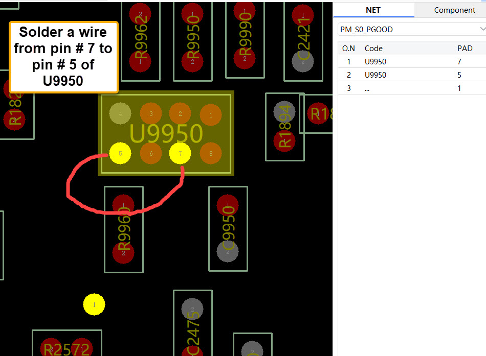

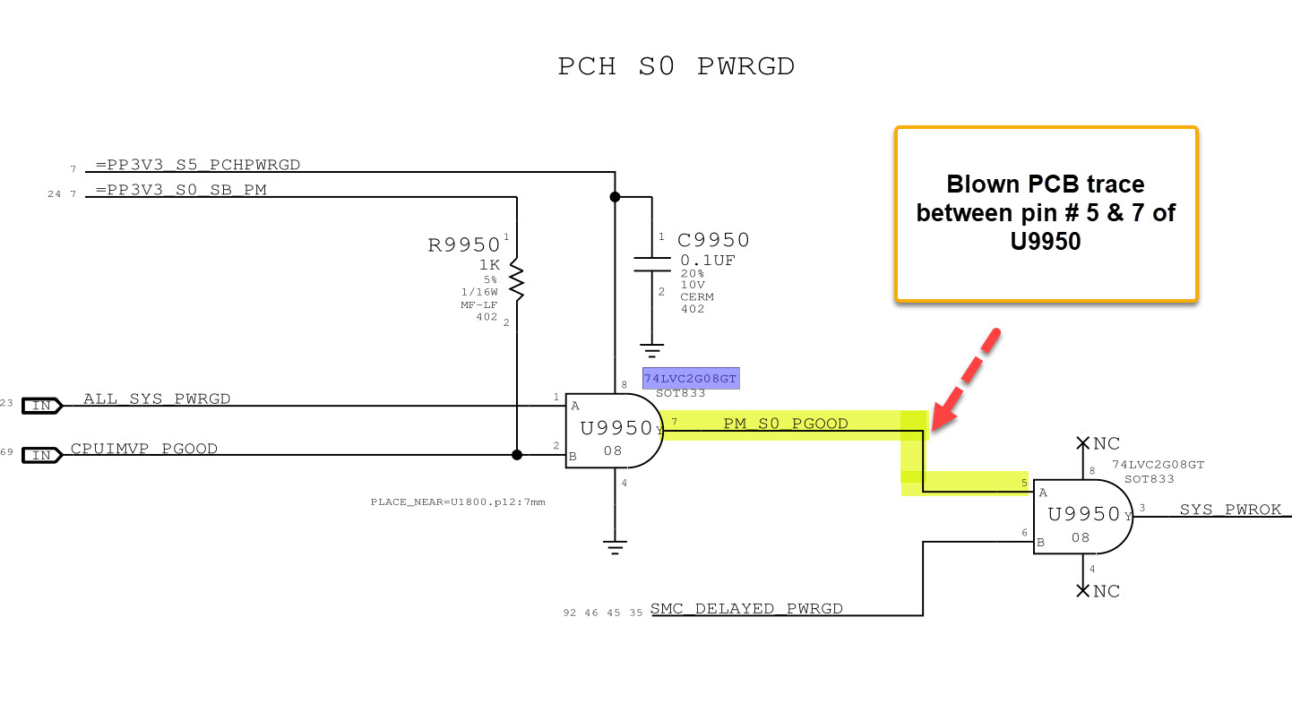

              #66
              See attached.
              • Gigabit2
                • Apr 2022
                • 264
                • United Kingdom
                #67
                Originally posted by mon2
                see attached.
                u9950
                • mon2
                  • Dec 2019
                  • 13849
                  #68
                  See attached.
                  I believe this is the trace flow - from pin # 7 of U9950.
                  Respectively, it does not matter how the traces flow on the PCB itself as long as you can rebuild the same connection.
                  You have enough meat from Pin # 7 trace that is broken to solder a thin wire and connect it directly to the target point = pin # 5.
                  Update - you have meat (actual test pad you can solder to) on pin # 5 trace.
                  You have meat on pin # 7 trace.
                  Just solder a small wire onto the pad on pin # 5 trace and mate it to pin # 7 - done.

                    #69
                    Hi mon2,
                    Yes I will fix this, is this likely to be causing the problem?
                    Can we do more testing in the meantime whilst waiting for the resistor replacement for the other component?
                      This could have been THE show stopper. Of course you still need to replace and stuff the 10 ohm resistors - suggest 1% tolerance if available. The engineers expect this resistor value to be present in series to the current sense resistor. Based on this value, they have knowledge of how much current draw is too much to shut down the unit.
                      You are facing a shut down event so it is quite possible that U7000 is shutting off PPBUS_G3H (a critical rail) due to the missing current sense loop.
                      At this time, can only wait for the parts to replace and see. The area you shared appears to be toasted - any other damaged traces ? If not obvious, just wait for the replacements to move forward.
