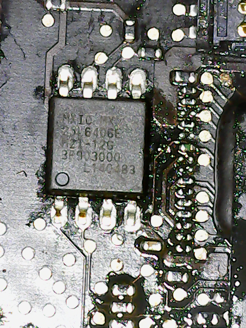

    Re: MacBook Pro Mid 2012 turns on, fans spin for five seconds and turns off, repeats
    So I did cleaning of the area above and now machine fans turn on for one second and then turn off, like quarter fan spin.
    I will replace BIOS chip
    • Gigabit2
      • Apr 2022
      • 264
      • United Kingdom
      #42
      I replaced BIOS chip, issue remains.

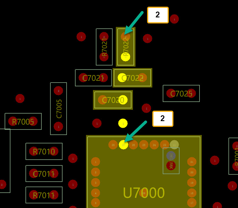

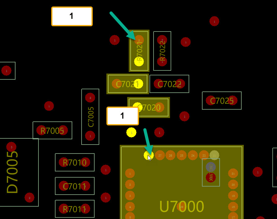

                #47
                Hi. See attached.
                Remove all power. Meter in resistance mode.
                Use the lowest scale on your meter.
                Confirm the resistance from the topside of R7020 current sense resistor to the current sense pin CHGR_CSI_P (pin # 28).
                So you are measuring from CHGR_CSI_R_P --> pin #28 of U7000.
                What is the resistance in ohms ?
                Repeat for the other side of the current sense resistor R7020 and CHGR_CSI_N (pin # 27).
                So you are measuring from CHGR_CSI_R_N --> pin #27 of U7000.
                For each, measure right at the pin on the U7000 IC - we want to be 100% sure the traces are reaching the current sense resistor legs.
                • Gigabit2
                  • Apr 2022
                  • 264
                  • United Kingdom
                  #48
                  Hi mon2,
                  CHGR_CSI_R_P --> pin #28 of U7000: 00.5 on 200 mode
                  CHGR_CSI_R_N --> pin #27 of U7000: 00.6 on 200 mode

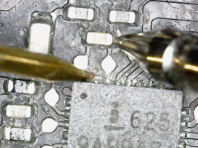

                        • Gigabit2
                          • Apr 2022
                          • 264
                          • United Kingdom
                          #52
                          Hi mon2,
                          Showing 0.6 on one side and 20 on other. See photo, this is where I measured 20:

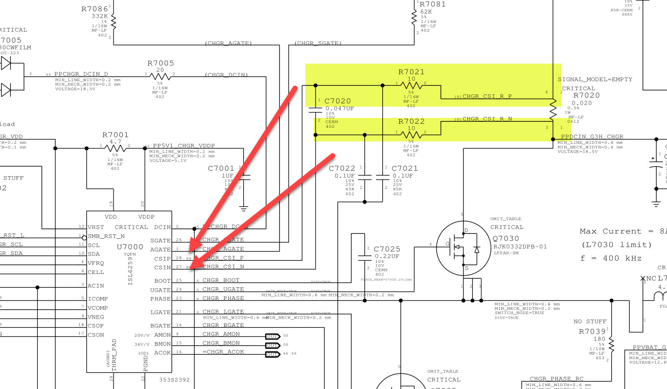

                            #53
                            See attached.
                            Measure from the 2 arrow heads as shown for the first check.
                            Reading ?
                            Then repeat for the 2nd resistor check.
                            Reading ?
                            • Gigabit2
                              • Apr 2022
                              • 264
                              • United Kingdom
                              #54
                              1: 07.8
                              2: 08.0
