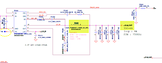

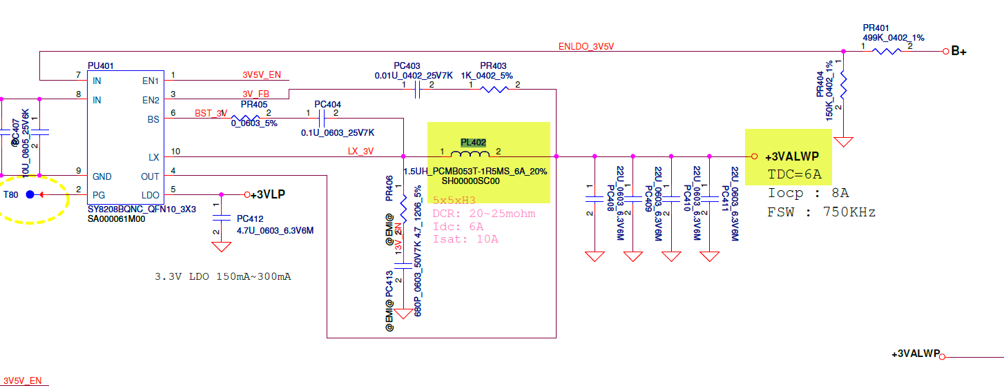

          PL402 is too low. The rest look ok. The other low resistance rails are normal resistance measurements for low voltage rails.
          Double check this resistance again. If still under 100 ohms, there may be a fault here. Flux and lift up one leg of PL402. Take care to not lift the PCB pad for this part.
          The check this resistance again. Is the lower resistance on the producer side (PU401) or on the consumer side (+3VALWP) of this rail? Suspecting the consumer side.

            mon2 with the pl402 removed from the board, i have the following:
            - without power cable connected to the board: on one side of the PL402 - 1,5KOHM and 2,6MOHM on the other side, i cannot tell from the board which side is the producer rail or the consumer rail
