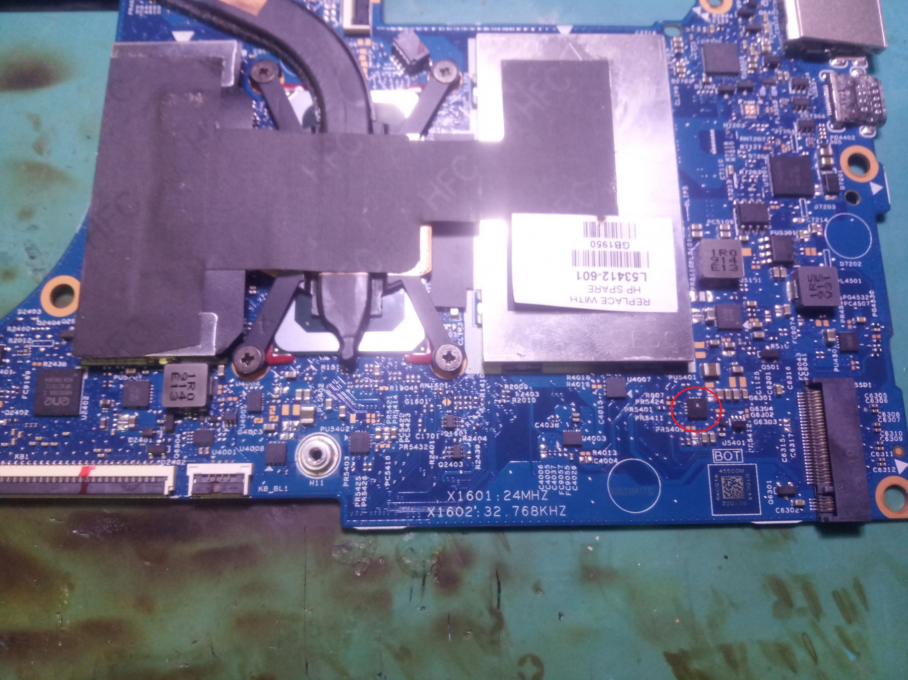

    Identify IC. Board code: 2019G1 Moorea 13 intel 18744-1
    Hello master
    I Need help identify IC, this ic burn & the marking unreadable. maybe someone have clear picture of this ic or have schematic for this board
    board code :
    18744-1
    Thank you

    Re: Identify IC
    Which HP laptop is it ?
    Post markings from the logic board - perhaps LA-xxxx format ?

      Re: Identify IC
      HP 13 - AQ0017TX
      18744-1
      this only marking i can found on the board sir

        Re: Identify IC
        Which make / model is the laptop ? Saw the HP sticker. Perhaps it is referenced in my database of schematics.
        I think I just found it...
        https://www.empowerlaptop.com/p/hp-1...with-i7-8565u/

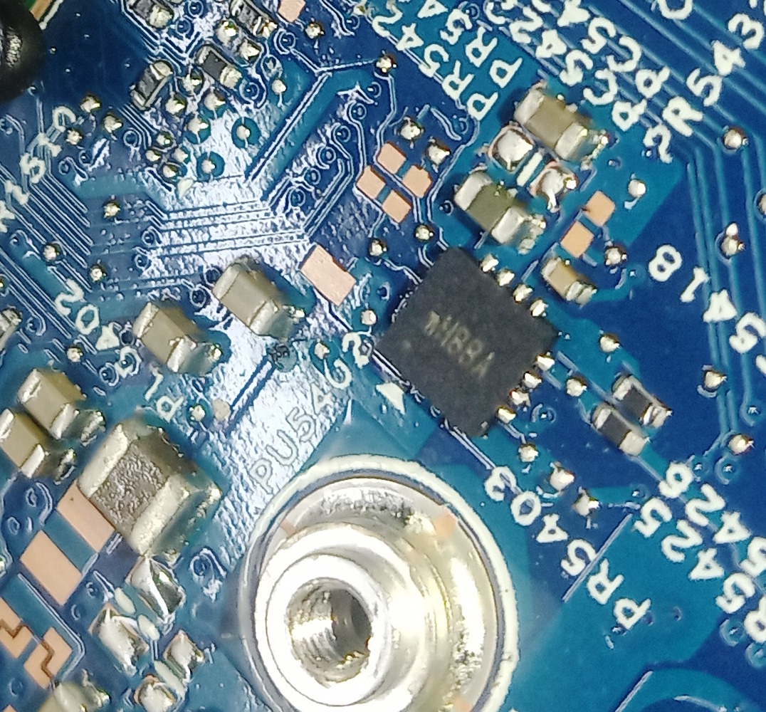

            Re: Identify IC
            Pour some alcohol over the damaged IC and this will allow for the indented laser markings to be visible.
            Then tilt and apply a strong flashlight / cell phone torch onto the top surface.
            Some of the markings should be visible. Plan B is to ask a vendor of the logic board to share the details but from my past experience, most will not help unless they have a monetary gain.

              Re: Identify IC
              best clear image i can found on this ic marking is mHBBA & again i can't found datasheet

                Re: Identify IC
                Any chance you can take a picture of the markings ?

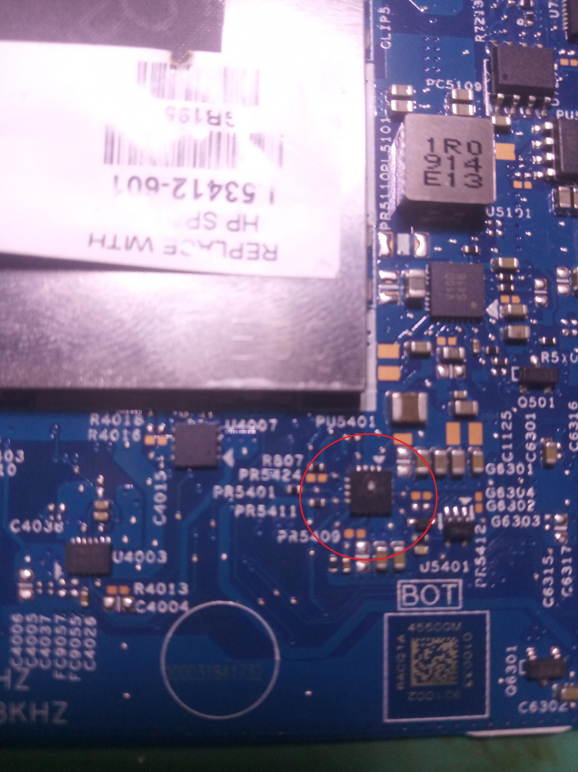

                  Re: Identify IC
                  This is the best picture, my friend send it

                    Re: Identify IC. Board code: 2019G1 Moorea 13 intel 18744-1
                    Found this
                    https://www.ebay.com/itm/185002771512
                    SY8057
                    but i can't find the datasheet
                      I would share the ORIGINAL pic from your motherboard and this new reference from Ebay with a supplier on Aliexpress. They are quite bright and able to source the weirdest parts from within China.
                      Keep updating this thread with your progress.
