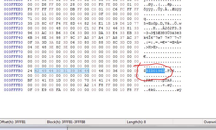

                                Which bios did you flash,this one,post #2 https://www.badcaps.net/forum/showthread.php?t=47205
                                Did you flash both,did you make a backup first and check your BID

                                    The 4MB file is the bios.Did you make a backup ? .Open your backup with a hex editor and search for the word BID ,if your BID matches the one posted (BID0196D) then you can flash it.If your BID is different then you need a different bios. What is the full laptop model number 17-??????
                                    HxD hex editor https://mh-nexus.de/en/downloads.php?product=HxD20
