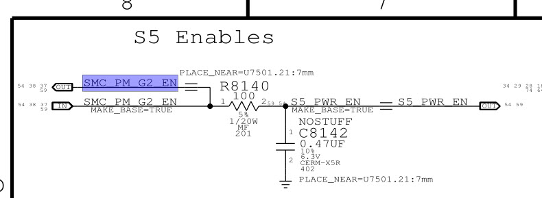

    Hi all, I'm new here (thanks for having me). I've repaired some macbooks in the past, but never had to dig really deep, until now...
    Got my hands on a Macbook Air that does not boot. Charger light goes from green to orange so there was some life in this thing.
    Did some digging to find that I do not have a PP3V3_S5, also not pulsing in anyway. SMC_PM_G2_EN is also missing, no pulse.
    Some voltages:
    PPBUS_G3H 8.56V
    PP3V42_G3H 3.42V
    PPDCIN_G3H 16.5V
    PP5V_S5 5V
    PP3V3S5_EN_R 3.41V
    PP3V3_S5_AVREF_SMC 3.24V
    SMC_RESET_L 3.38V
    SMC_ONOFF_L 3.42V
    I don't have a donor board to check whether U7501 is causing the issues. But maybe someone has any tips on what I could check?
    Did not notice any shorts so far.

                      Remove all power. Meter in resistance mode.
                      What is the resistance to ground of SMC_PM_G2_EN ?
                      • mrdefaultuser
                        • May 2022
                        • 10
                        • Netherlands
                        Re: Macbook Air 820-3437B missing PP3V3_S5

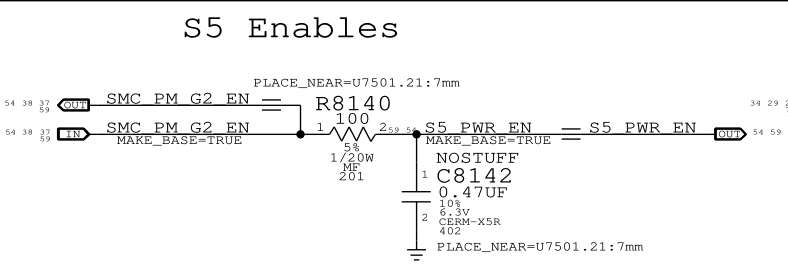

                        Ohno! 1 Ohm!
                        • mon2
                          • Dec 2019
                          • 14003
                          Remove R8140 and check the resistance to ground again of this signal on both sides of R8140 pads.
                          • mrdefaultuser
                            • May 2022
                            • 10
                            • Netherlands
                            Removed the resistor and checked resistance afterwards, but no shorts on both sides now. I don't get it...
                            Fan spins 3 times with the resistor removed so thats looking promising, will use some equipment at work tomorrow to look at it a little better.
                            • mrdefaultuser
                              • May 2022
                              • 10
                              • Netherlands
                              So changed the resistor, macbook boots now! Though not completely there yet:

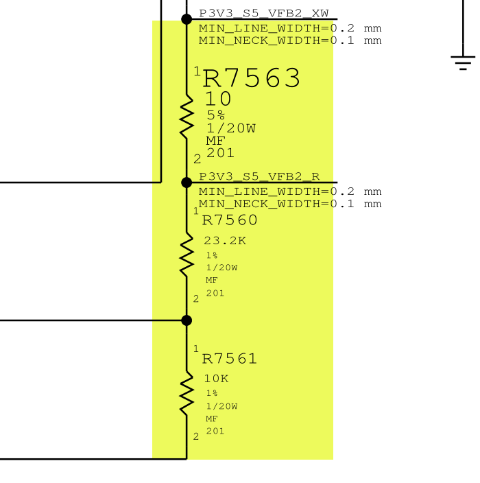

                                    Hi all i have a a1466 and i have PP3V3S5_EN_R = 0,52V ?
                                    • vinifera
                                      Vinifera
                                      • Aug 2018
                                      • 28
                                      • Belgium
                                      Originally posted by piernov
                                      I have the same board and i measure 0,52V on PP3V3S5_EN_R?
                                      When i remove L7560 then i measure 2,78V ?
                                      No short on PP3V3S5_EN_R.
                                      Can someone help me ?
                                      • mon2
                                        • Dec 2019
                                        • 14003
                                        If you have a voltage on PP3V3S5_EN_R (EN2), then this enable pin is OK since that part of the regulator is attempting to output a voltage @ PP3V3_S5_REG_R.
                                        The concern is more with that the output voltage is not @ 3v3 (rather is 2v78).
                                        The voltage is dialed up using the FB (feedback) resistors on pin # 16.
                                        With NO power to the board -> meter in resistance mode -> confirm the resistor values present on pin # 16 from the large inductor @ L7560. Check that each resistor is matching the values shown in the schematic. These resistors will impact the true output voltage value.
                                        Also, check the resistance to ground of L7560, pin # 2.
