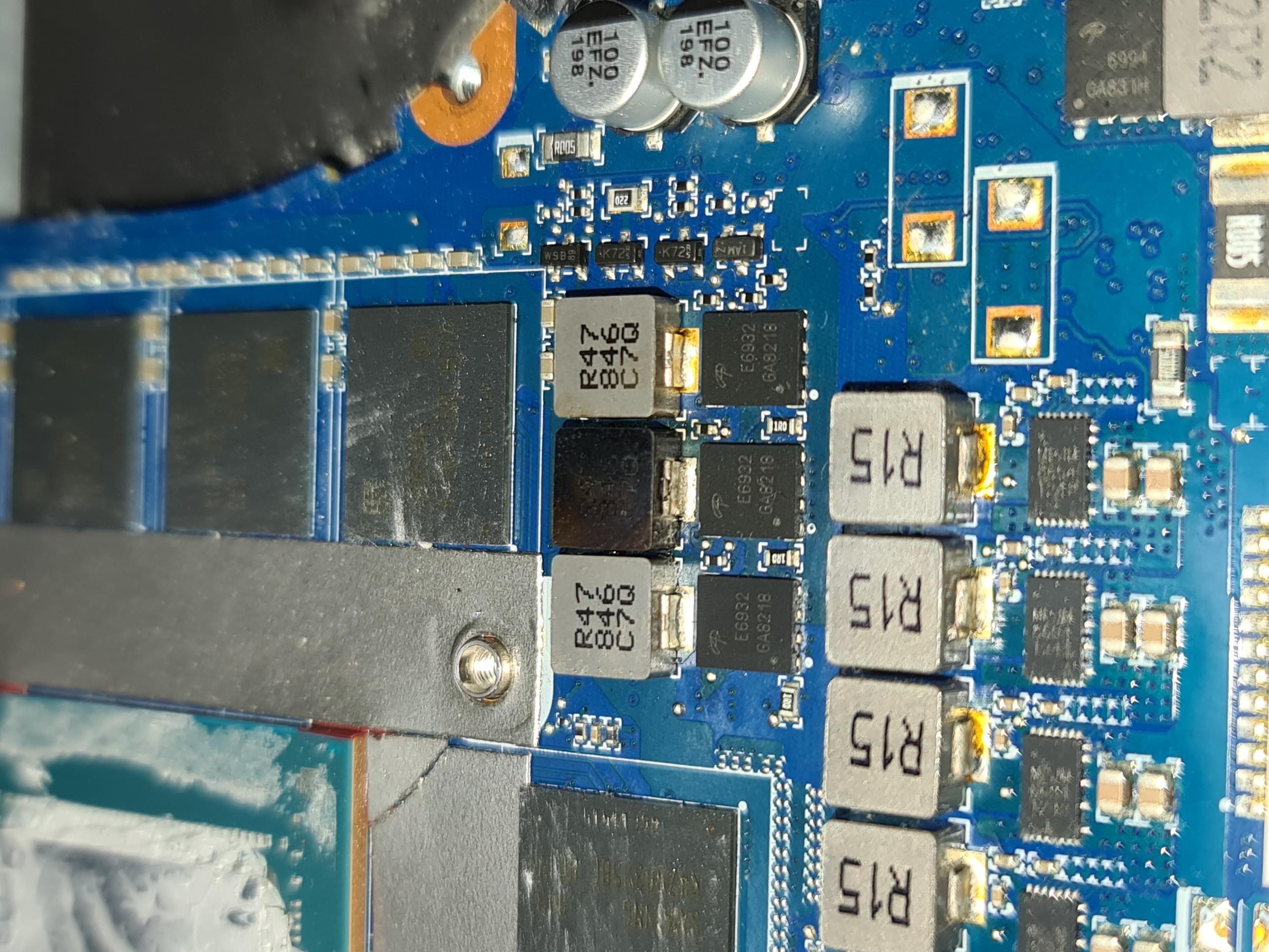

    PC specialist NL5E-N18EG
    Hi, i have the same problem, no more power and same coil is broken, how do you check if a mosfet is in short, and if you remember where was your broken on as my be the same on my one

    Re: PC specialist NL5E-N18EG motherboard
    This question is best posted in the laptop repair side of the forum.
    Remove all power -> meter in resistance mode (start with the lowest scale).
    Then measure across the mosfet pins as follows:
    source (1-2-3) & drain (5-6-7-8)
    source (1-2-3) & gate (4)
    gate (4) & drain (5-6-7-8)
    If the meter shows '1' -> switch to the next higher meter scale.
    Post each measure & the meter scale used for the measurement.
    You are checking for a low resistance reading which often means a defective mosfet.
      Thank you, will do tomorrow
      • lucian6464
        • Feb 2021
        • 9
        All sorted, mosfet under the burned coil was burned also, replaced that and the laptop works again
        Thank you for your support
