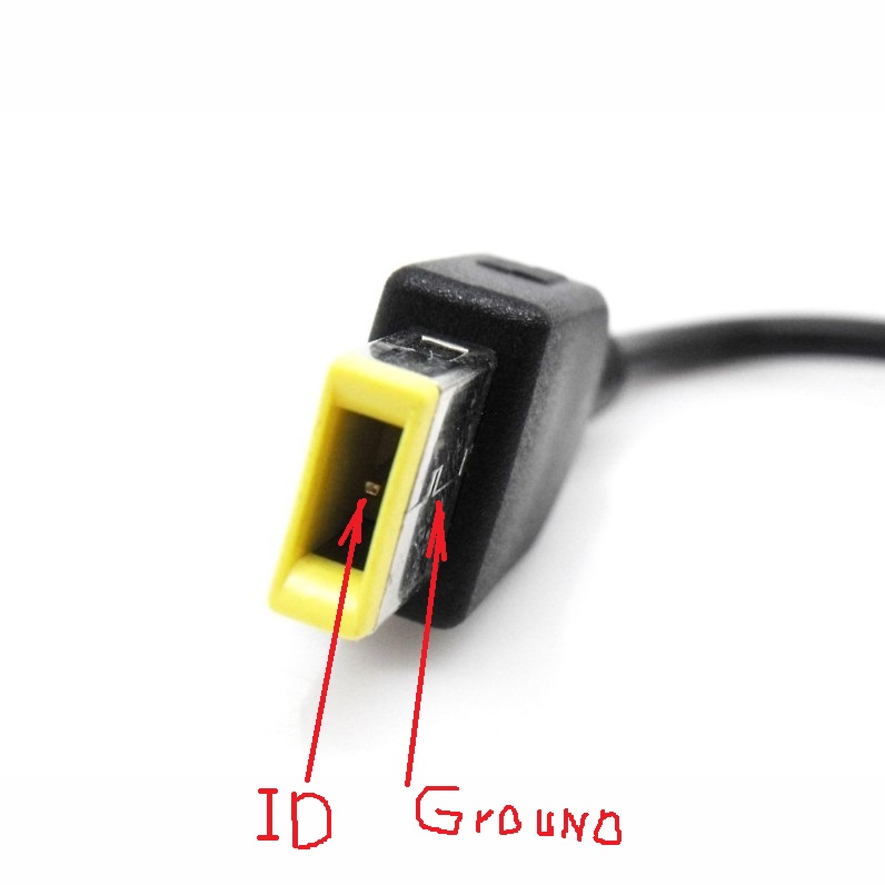

              ADAPTER_ID is not present (0v) as far as I see.

                Try with known good Lenovo power supply.
                Measure resistance to ground (the adapter must be disconnected from the mains and the laptop itself) between the Id pin and the ground (at the jack) of your current power brick.

                      Re: Lenovo Y530 power button only works with battery
                      I measure 0.996 kOhm resistance to ground between the ID pin and ground.
                            DMM is set to 2k.
                            Seem ok, it's a 135W power brick right?
                                  Yes I do.
                                  ADAPTER_ID is not a (positive) voltage line! It's a signal line, SIO chip receive this signal as a value of the resistance to the ground in it.
                                  That's why I asked above to measure this value at the jack of your current power brick.
                                      0.996 kOhm at the jack of the power brick and 0.005 kOhm on the ADAPTER_ID pin on the board to ground.
                                        Sorry, I meant it in resistance mode between S/D/G to ground and between S/D/G. In diode mode:
                                        S to D: 0.542
                                        D to S: 2.431
                                        G to S: 1.814
                                        G to D: 2.476
                                        Also, I found a short to ground on the 3VALW line. If I apply 2V/4A on it the PCH chip is getting slightly warm, but nothing else.
                                        0.005 kOhm is 5 Ohm - this is almost short, along with the shorted PCH means that this machine is now beyond economical repair.
