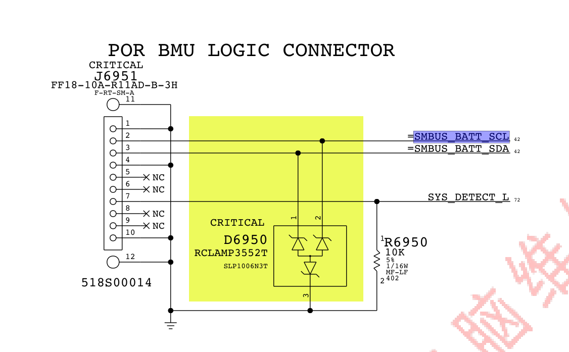

        Re: Macbook Pro A1708 820-00875 No boot
        Every design by apple has an esd diode on the battery for the smbus interface (scl and sda). Used for communication with the BMS board in the battery pack.
        Measure the voltage of these sda and scl lines.
          It seems that I cannot find what you told me on that battery maybe because its not original. Could you please explain further?
          • mon2
            • Dec 2019
            • 14085
            Attached.
              I see so
              SMBUS_BATT_SCL is 3.4V
              • mon2
                • Dec 2019
                • 14085
                Good voltage.
