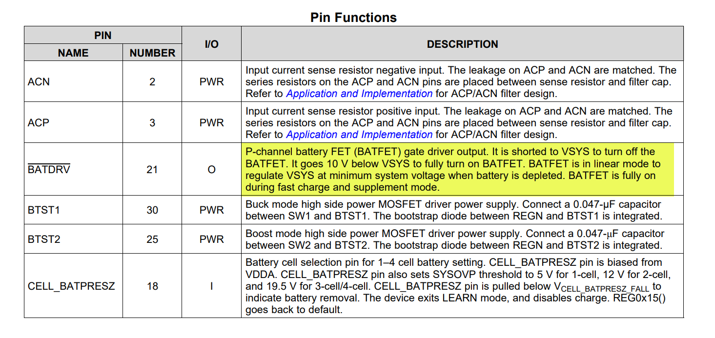

    Hi. So BQ25700 is the charger IC ?
    With the adapter & battery connected, measure the voltage on
    pin # 19 (SRN)
    pin # 20 (SRP)
    BATDRV# pin # 21
    SCL (pin #13)
    SDA (pin #12)
    CELL_BATPRESZ (pin # 18)
    Post each reading.

      Hi. Here is the measurements
      SCL sda 3.3v
      Cell batpresz 3.459v
      Sen srp 12.85v
      Batdrv 13v
      Vdda REGN 6V
      Vbus 20
      CHG ok 3.3
      Upon plugging battery without ac adapter No activity on SCL SDA pin confirmed with oscilloscope
      There is 1.8v and 3.3v at thinkengine ic tho

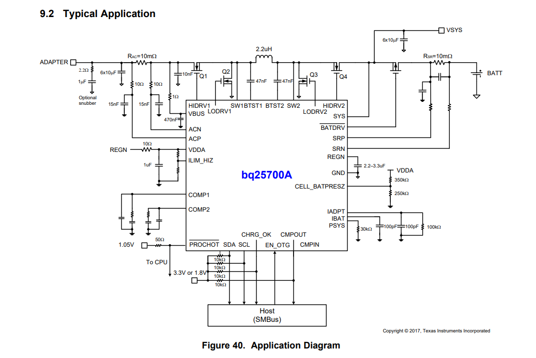

        Review figure 40 of the above charger IC datasheet.
        With no power, compare if you have a similar resistor based voltage divider on your logic board for the CELL_BATPRESZ pin.
        With no power, check the resistance across the high side and low side resistors for this pin.
        The posted voltage, from the datasheet, does not look correct.
        What voltage do you see for CELL_BATPRESZ on the other laptop that is working?
        If you charge this battery in the other laptop, does this battery work to power this logic that is not charging?

          Well battery confirmed working. Sadly Currently no other laptop of similar model, previously there was, but already fixed and returned, different problem
          Anyway the resistor 58.5 kohm to vdda 75.5 kohm to gnd
          So the math checks out, ~3.4 is around 55% of 6v which according to the datasheet will configure the chip to charge 3s battery. The battery nominal voltage is 11.5 which also strengthen it is indeed 3s bat.

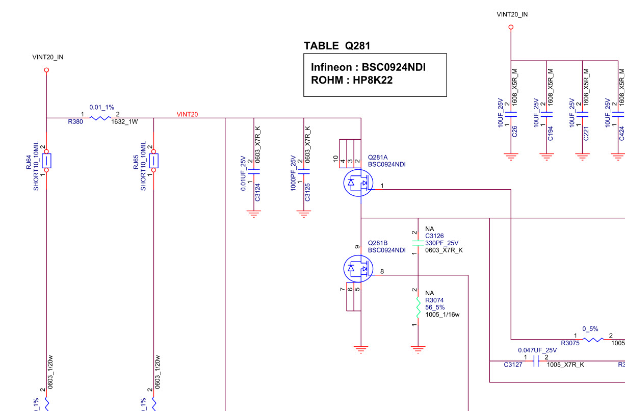

                See attached for the first DUAL MOSFET in a single package datasheet.
                Remove all power. Meter in resistance mode.
                Check the resistance between the following:
                source & drain (review the datasheet on which pin is which on this package)
                source & gate
                gate & drain
                post the readings for the 1st and then the 2nd mosfet inside this package.
                • ss45
                  • Jun 2019
                  • 119
                  • Brazil
                  Re: Lenovo a285 no power can't charge power button no response
                  All MOSFETs are fine, ie q1-q4, batfet all no short. Checked waveform on all gates, they are also fine and each conducts when proper signal is fed,
