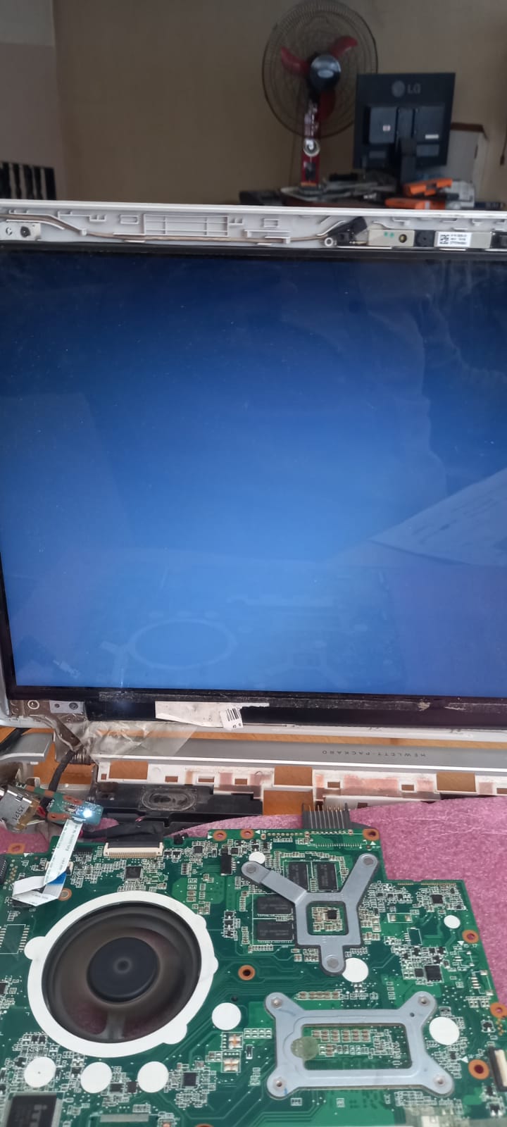

    hp 15-p202ne no data but light screen
    hp 15-p202ne power ok but light screen no data
    flashed bios but same issue!

    Here we will give just a few pointers to what kind of troubleshooting has to be done if you suspect a board issue.
    Powers on but no display
    • Check if it's no backlight, no image or both
      • If no image:
        • Check if external display works, try with internal LCD disconnected as well.
        • Measure voltage on LCD power rail(s)
      • If no backlight but image is present
        • Try to locate the fuse (or resistor or inductor) to backlight rail and check if it's blown
        • Measure voltage on backlight rail, backlight enable signal, brightness adjustment signal
    • Check if laptop is POSTing: pressing caps lock key triggers caps lock LED, activity of USB drive blinks when turning on, audio plays, HDD is being read, etc… If it's not POSTing:
      • Check RAM compatibility
      • Reseat RAM and clean RAM slots
      • Measure exact voltage on CPU VCore
      • Check CPU Reset signal
      • Follow power sequence if it exists in the schematics
      • Follow list of power rails if it exists in the schematics
    No power
    • Check Laptop battery charging circuit
    • Check if DC-in jack LED lights up
    • Check voltage on all the large inductors
    Note: don't forget to trigger power button when measuring for the rails that only come up when machine is turned on.
    When requesting help, please attach a picture of the board with voltage and resistance to ground measurements on all the large inductors after triggering power button.
    Powers on, display ok but something is wrong afterwards
    • Exclude software issue by booting from another drive with Windows 10/Linux/macOS

      USB keyboard Numlock glows?? Screen.display cable replaced or tested with working ones??
