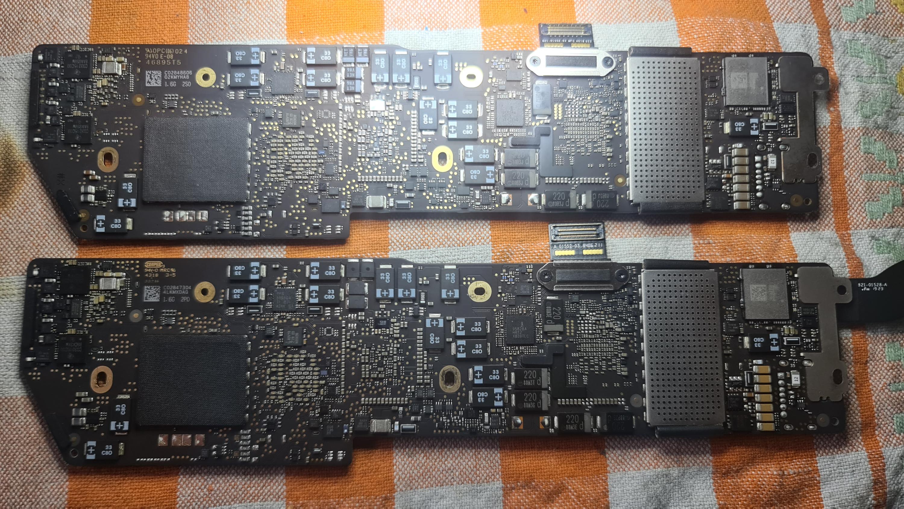

    Apple MacBook Air 13" A1932 2018. It's on. Touchpad clicks and board gets warm. There is no start-up sound and the display stays black. The audio board was defective after liquid damage. Nothing is visible on the logic board. bild comes with another logic board. So display and cable are intact! I have both logic boards here and can also measure on both.

    From C8469-C8473 I have 43 volts on the board where the display works. On the board where the display remains black, I have 0.0200 volts from C8469-C8473!
    • mon2
      • Dec 2019
      • 14663
      Re: A1932 - Black screen, no startup sounds
      Remove all power. Meter in resistance mode.
      Check the resistance to ground on C8469-C8473 for the non-working board.
      Compare the resistance to ground of the working board.

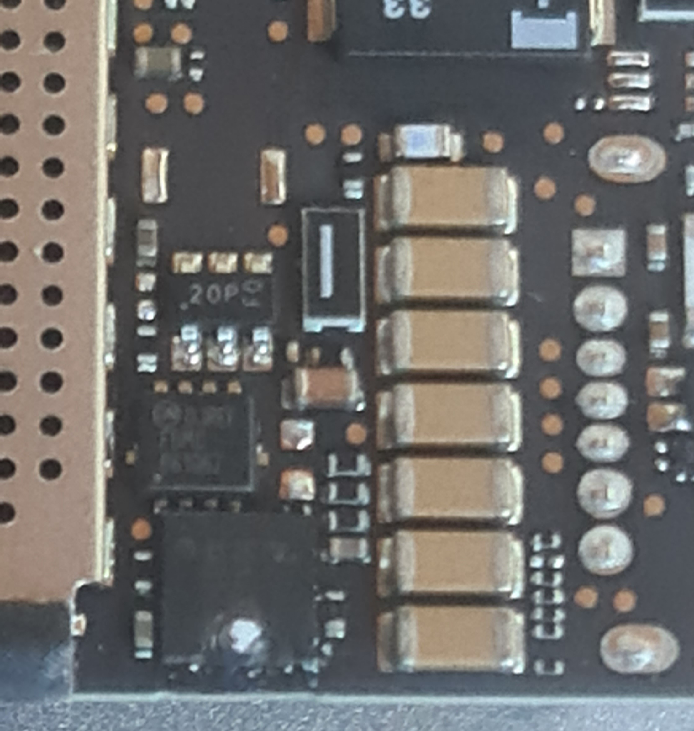

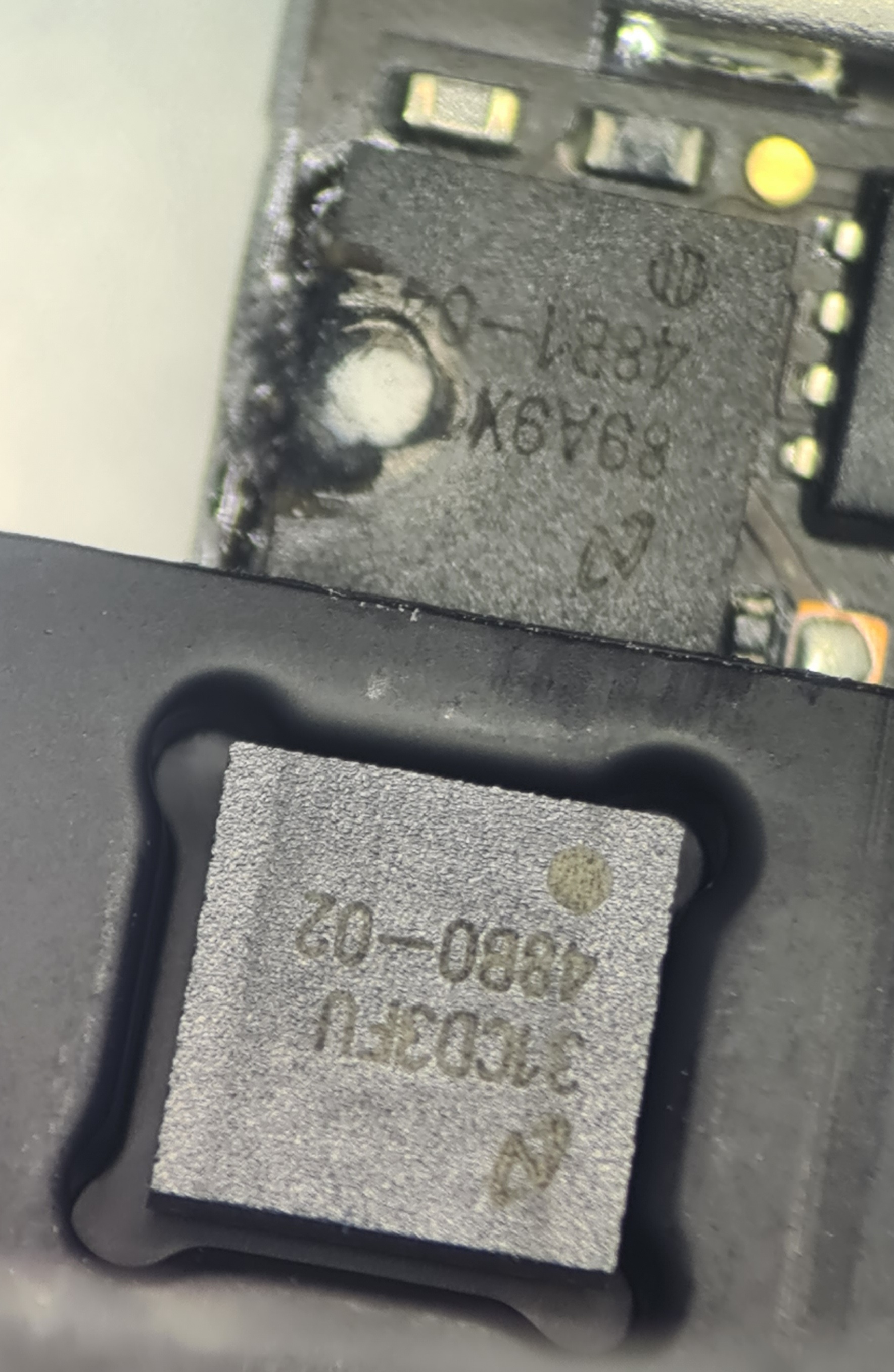

                      I had slipped while measuring near F8400 and wanted to test the board and installed it. Then there was some smoke and the U8400 burned out ;-( from the intact board!

                        Then I'll probably swap the U8400 from the board first and see if it works again.

                          Ouch! They are commonly available on Aliexpress.
                          Being in this position, consider to flux and carefully remove the same IC off the non-working board and transplant onto this board and see if the backlight works.
                          Lots of flux & patience.

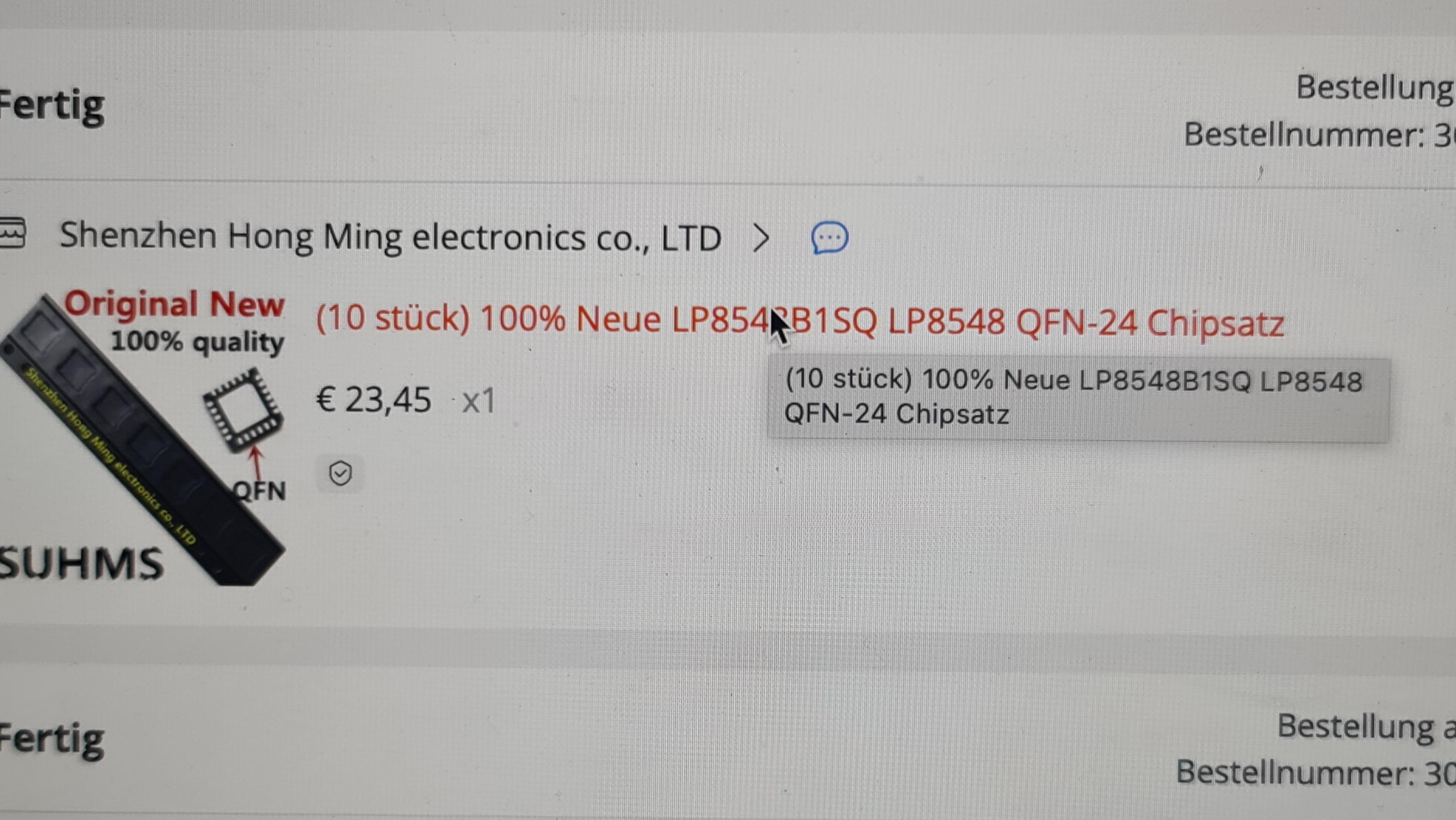

                            I bought 10 pieces from Ali. I'm not sure if it fits this board. The the IC both the same? The numbers are not the same.
                            • mon2
                              • Dec 2019
                              • 14663
                              Perhaps a different housemark.
                              Did the vendor state the part to be the same as the original backlight IC ?
                              Worth testing with 1 device.
                              Post the bottom side pic of the new part. The defective one needs to be replaced of course but do make a note of the pin #1 orientation for this surgery.

                                I also installed the IC in the A1707 15 inch MacBook Pro! On the schematics the IC on both boards Air and Pro are the same LP8548B1SQ_-04 and LP8548B1SQ_-03 and the same contacts

                                    Das sind die IC die ich gekauft habe
                                    • mon2
                                      • Dec 2019
                                      • 14663
                                      That is a good store - have used them many times for parts. No issues.

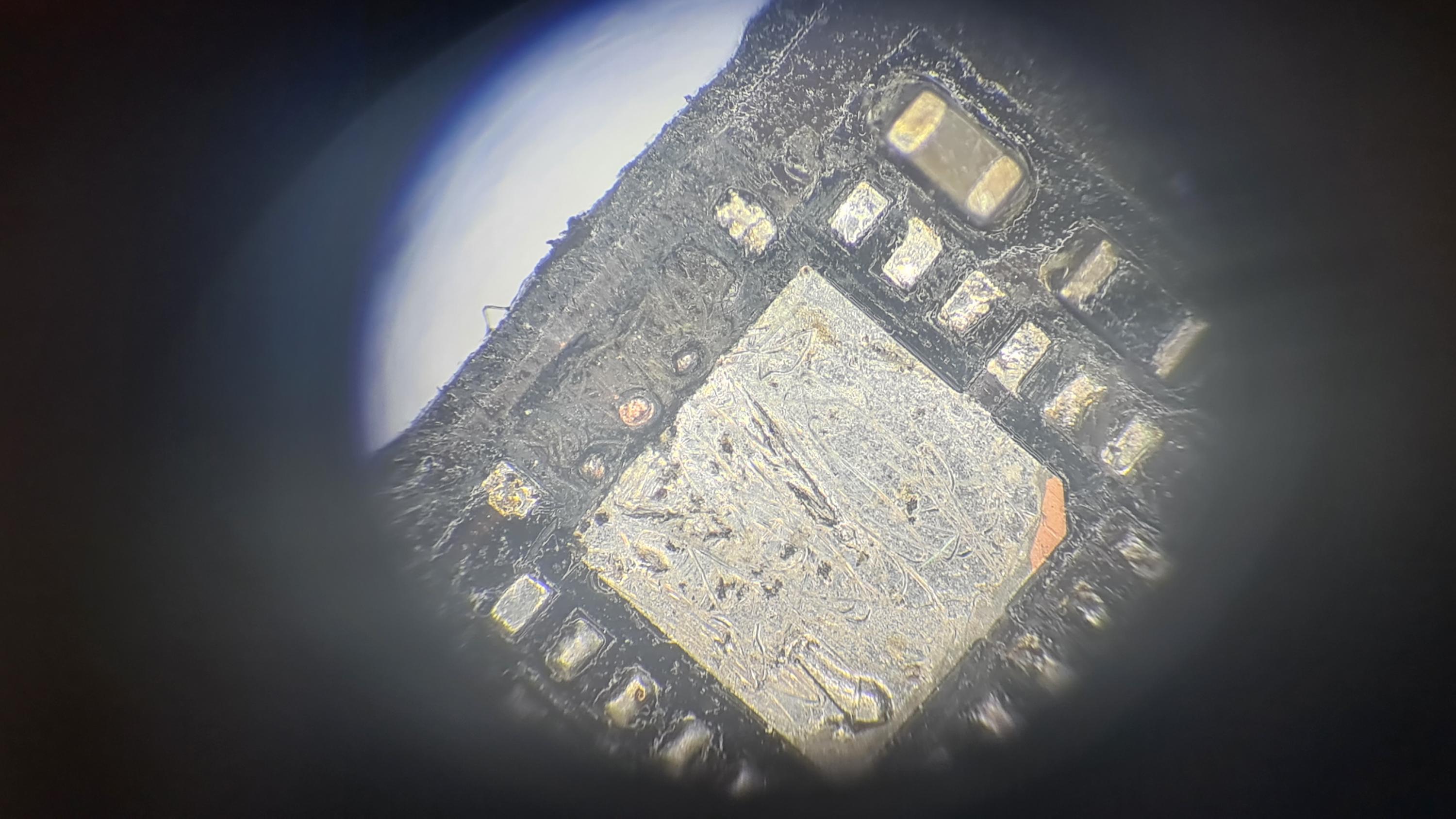

                                        I unsoldered U8400. 3pins don't look good one pin is gone. Pin 8 is not connected. I will rebuild the 3 pins and solder in U8400. I hope the display will work again. Then I measure the other board.
