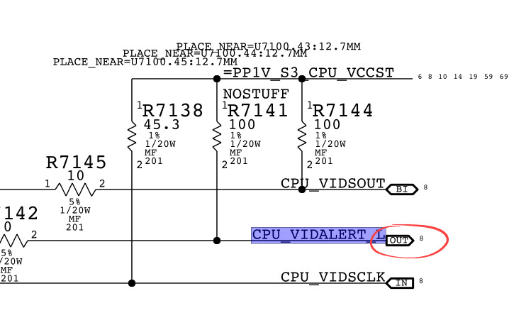

    Strange how I got different readings from pin 2 of R7138 and R7139, I know it's only slight but I doubt there should be that much difference. Presume its my probe contact point.

      CPU_VIDALERT_L is at 0.1v
      being a logic active LOW signal, this signal is reporting that there is a FAULT.
      Review each of the current sense lines from the CPU power rail:
      CPUVR_ISNS1_P
      CPUVR_ISNS1_N
      CPUVR_ISNS2_P
      CPUVR_ISNS2_N
      and be sure they reach the op-amp through the resistors in the schematic @ U5600.
      That is, U5600 should output some value to report that all is well / or not.
      It is possible that the rail is turning on briefly and then shutting down due to a missing or defective current sense component which is the loop of parts discussed (U7100 creates the PWM to drive the voltage rail for the CPU).
      What is the history of this board ? Any liquid damage ?
      The indicators seem to hint that it should all work but you are drawing very low current. You have 20V so the ACE controllers and local ROM to the ACE are good.

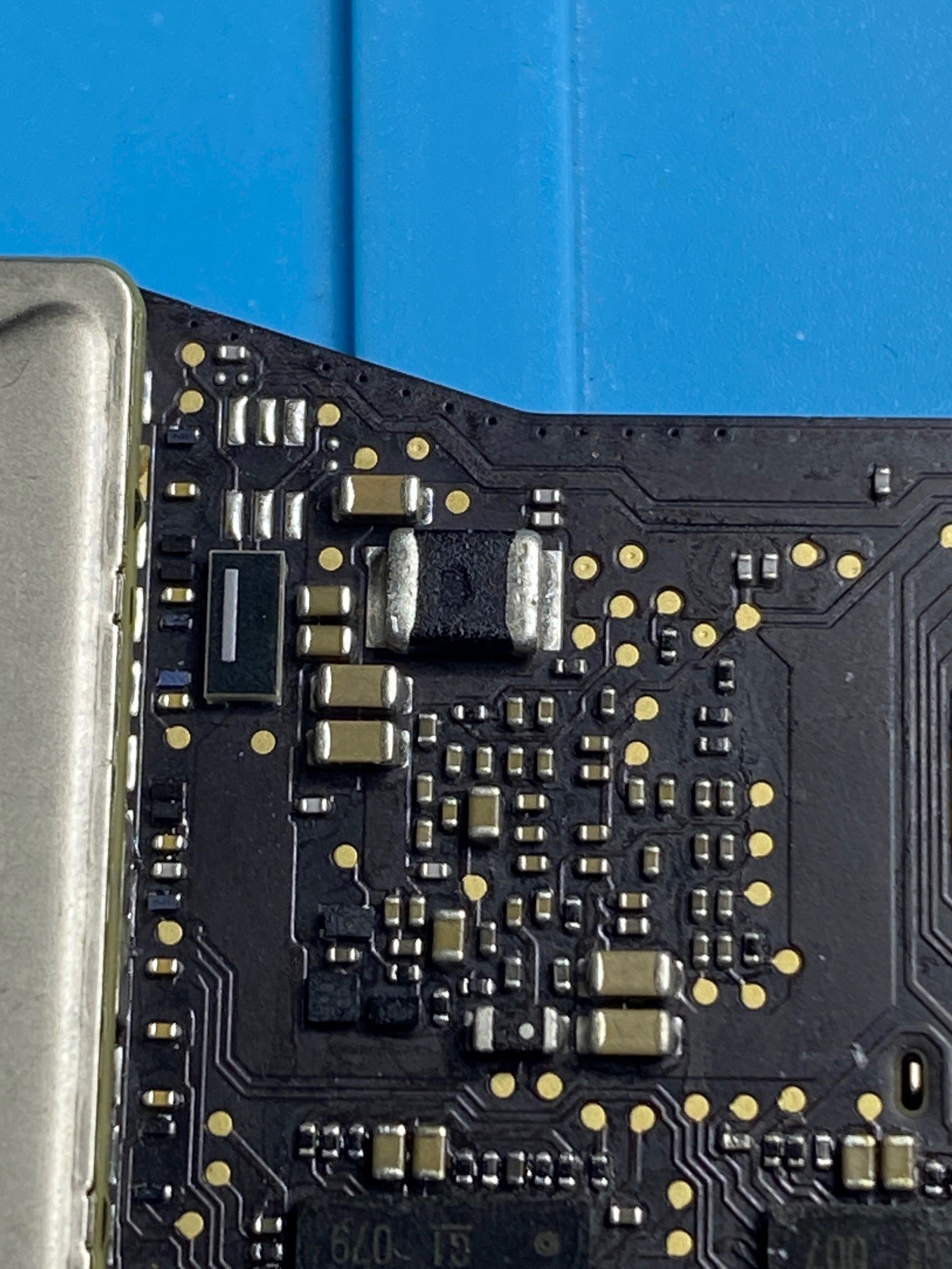

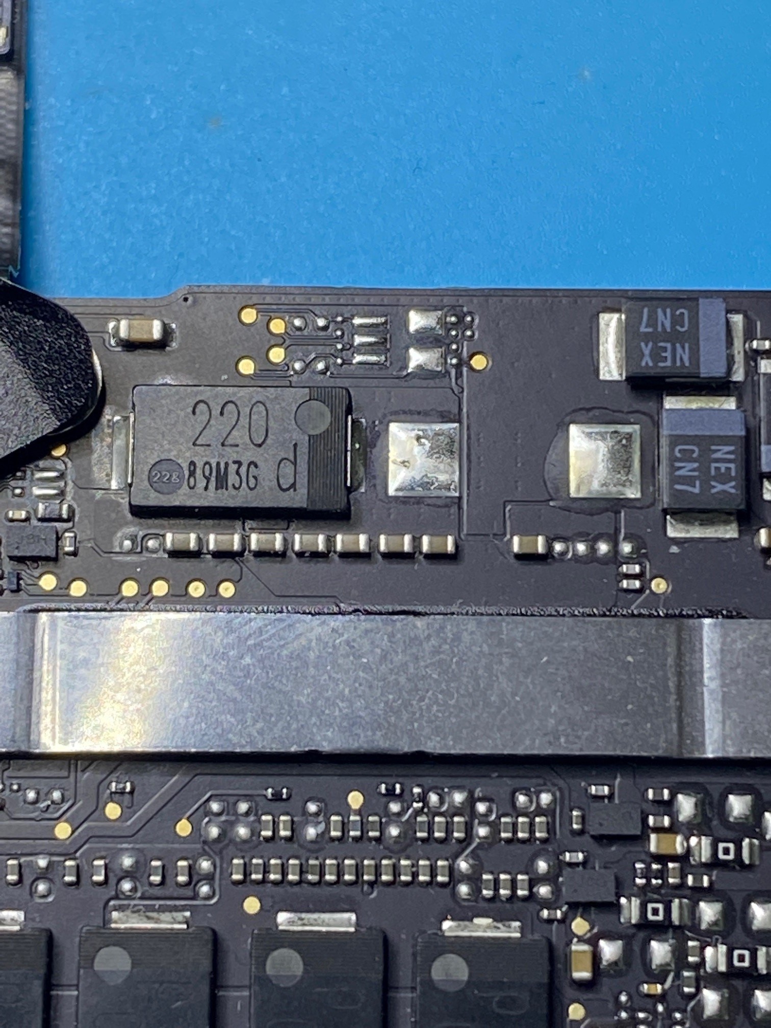

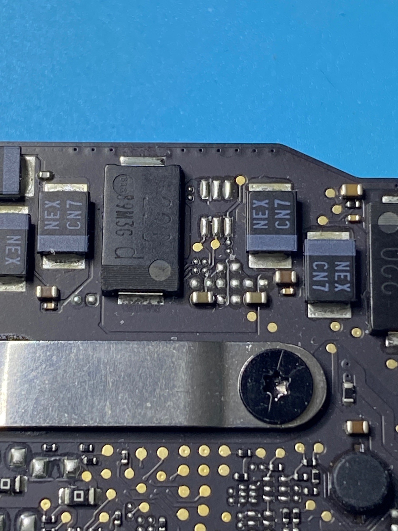

          I have taken a look at the schematic as suggested however the current sense components do not exist on this board. I have two of these boards and both do not have any of the components. I have attached images to show the areas where the components should be.
          CPU_VIDALERT_L is low however I cannot understand what would generate this especially without the current sense components.

                Re: A1708 820-00840 charging issue
                Does anybody know if CPU_VIDALERT_L is sent to the CPU or if the CPU sends it to U7100?
                  #48
                  OUTPUT from U7100.
                    #49
                    Thanks Mon2,
                    But if it's an output from 7100 why would there need to be PP1V_S3 injected into the circuit? Is that for sleep?
                      #50
                      Think I've just found the answer to that. S3 is a sleep mode therefore the CPU needs a little power to be awake in sleep mode.
                      So my next question is what voltage should U7100 output on the CPU_VIDALERT_L rail under normal conditions?
