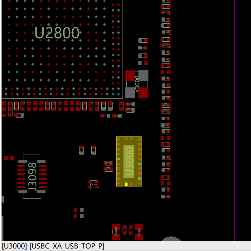

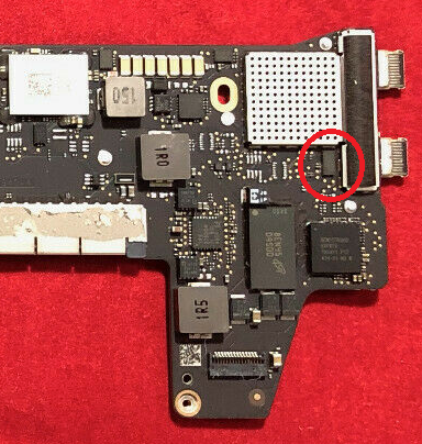

    I have a 820-00840 board which shows 5v on the usb c ammeter. I have checked both CD3215 which seem fine and I have all the required voltages except a short on pp3v3_g3h.
    What I have noticed is there is a ic on the top side of the board near J3300. It is marked with p13usb32.
    The boardview or schematic I have for this board has no mention of this ic, it's not displayed on the boardview.
    This ic does get hot when trying to charge therefore I removed it and the short on pp3v3_g3h has gone.
    Does anybody have any information on this ic or where I can purchase it from?

      Hi. See attached.
      The part is @ U3000 = Diodes / Pericom PI3USB32324XEAE .
      You can find replacements on Aliexpress:
      https://www.aliexpress.com/wholesale...psort=1&page=1
      The BV file that shows the U3000 = 820-00840-01

          The URL is working for my side but you can also go to:
          aliexpress.com and enter in the search bar 'PI3USB32324XEAE' -> then sort by price or ratings or sales, etc.
          Update - also review more about the MUX here:
          https://www.macbook-repairs.co.uk/bl...ok-air-13-2019
          BTW - the author / store from the above article is in the UK. Perhaps ring them to ask if they will sell you the spare parts ? I know the lizards in our town will not do that. We do not have a problem with it but other shops appear to urinate around their shops to mark their territory.

                        Careful..the last post references a totally different part and with a different package and pinout.
                        TBH, I did the same based on the original post. The boardview confirmed the device is not the same.
                        The full part number wraps onto the 2nd line of the device package.

                            Thanks for you help Mon2, I was able to source the ic with your help.
                            I have replaced the USB IC and the charger now shows 20v @ 0.22ma.
                            The CPU warms up, not hot just warm yet I don't believe it's booting.
