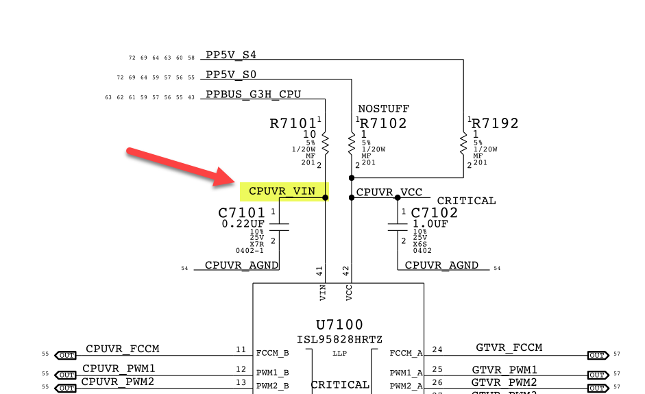

                        Voltage of SMC_GT_VSENSE ?
                        Update:
                        Also voltage of CPUVR_VIN ? (see attached)

                            Re: A1708 820-00840 charging issue
                            Voltage of CPUVR_VIN ? (see above last post for location)
                              #34
                              CPUVR_VIN is at 13v

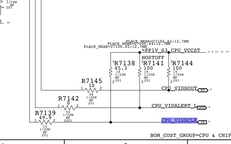

                                        So U7100 is being told to enable the power rails for the CPU via PM_EN_CPUVCC_R yet the power rails for the CPU (PPVCCGT_S0G ) remain @ 0v.
                                        The resistance to ground (3R9) for the CPU rails (PPVCCGT_S0G ) appear to be ok so the CPU is not shorted.
                                        Post the voltage readings for:
                                        CPU_VIDALERT_L
                                        CPU_VIDSOUT
                                        CPU_VIDSCLK
                                        CPU_VCCST_PWRGD
                                        See attached and confirm that the same voltage readings are present on each side of the series resistors. These are the I2C lines + ALERT# signal out of U7100.
                                          #40
                                          R7144
                                          Pin 1 is 0.99v
                                          Pin 2 is 0.99v
                                          R7141 (No Stuff)
                                          Pin 1 is 0.99v
                                          Pin 2 is 0.1v
                                          R7138
                                          Pin 1 is 0.99v
                                          Pin 2 is 0.99v
                                          R7145
                                          Pin 1 is 0.99v
                                          Pin 2 is 0.99v
                                          R7142
                                          Pin 1 is 0.1v
                                          Pin 2 is 0.1v
                                          R7139
                                          Pin 1 is 0.924v
                                          Pin 2 is 0.924v
                                          CPU_VIDALERT_L is at 0.1v
                                          CPU_VIDSOUT is at 0.99v
                                          CPU_VIDSCLK is at 0.99v
