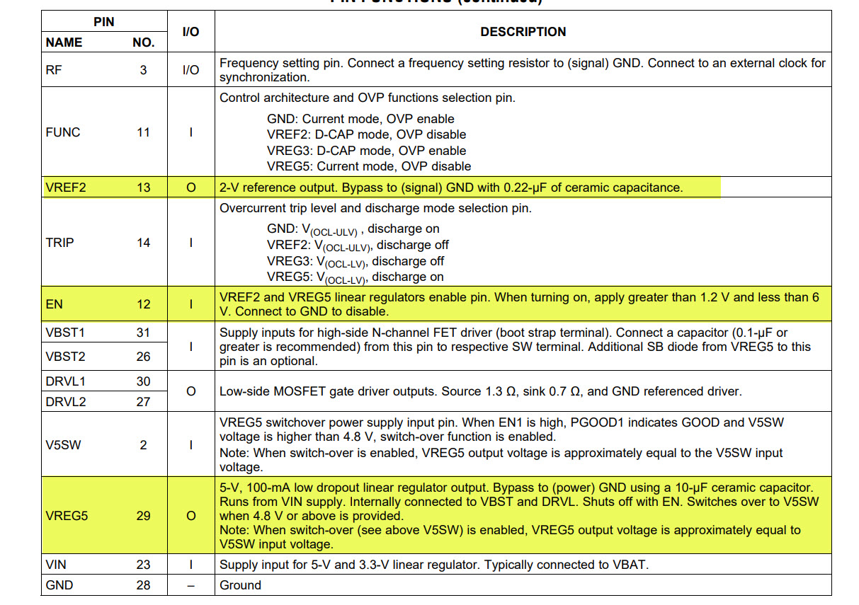

              Remove all power. Meter in resistance mode (2k scale).
              Measure the resistance to ground of VREG5 (pin 29) of U41.
              Post the readings.
              VREG5 will only enable if EN (U41, pin 12) is a logic HIGH.
              EN (pin 12) of U41 receives this signal from the TQFP128 (Toshiba) part TB62D516FG (TQFP128 14X14) @ U101 (pin 96) = KBC ??

                    • mon2
                      • Dec 2019
                      • 14672
                      Re: THINKPAD T450S - NM-A301 no power
                      The rather high resistance is ok and confirms there is no excessive load (ie. short circuit or a bad cap) on this rail. So this rail has no reason to turn OFF.
                      Now for this rail to enable, the EN pin of U41 needs to be a logic high as per the shared datasheet for this component.
                      This logic level for the EN pin comes upstream from the Toshiba component (pin 96).
                      Is the Toshiba component warm / hot to the touch ? Review if the power rails are present on this component.
