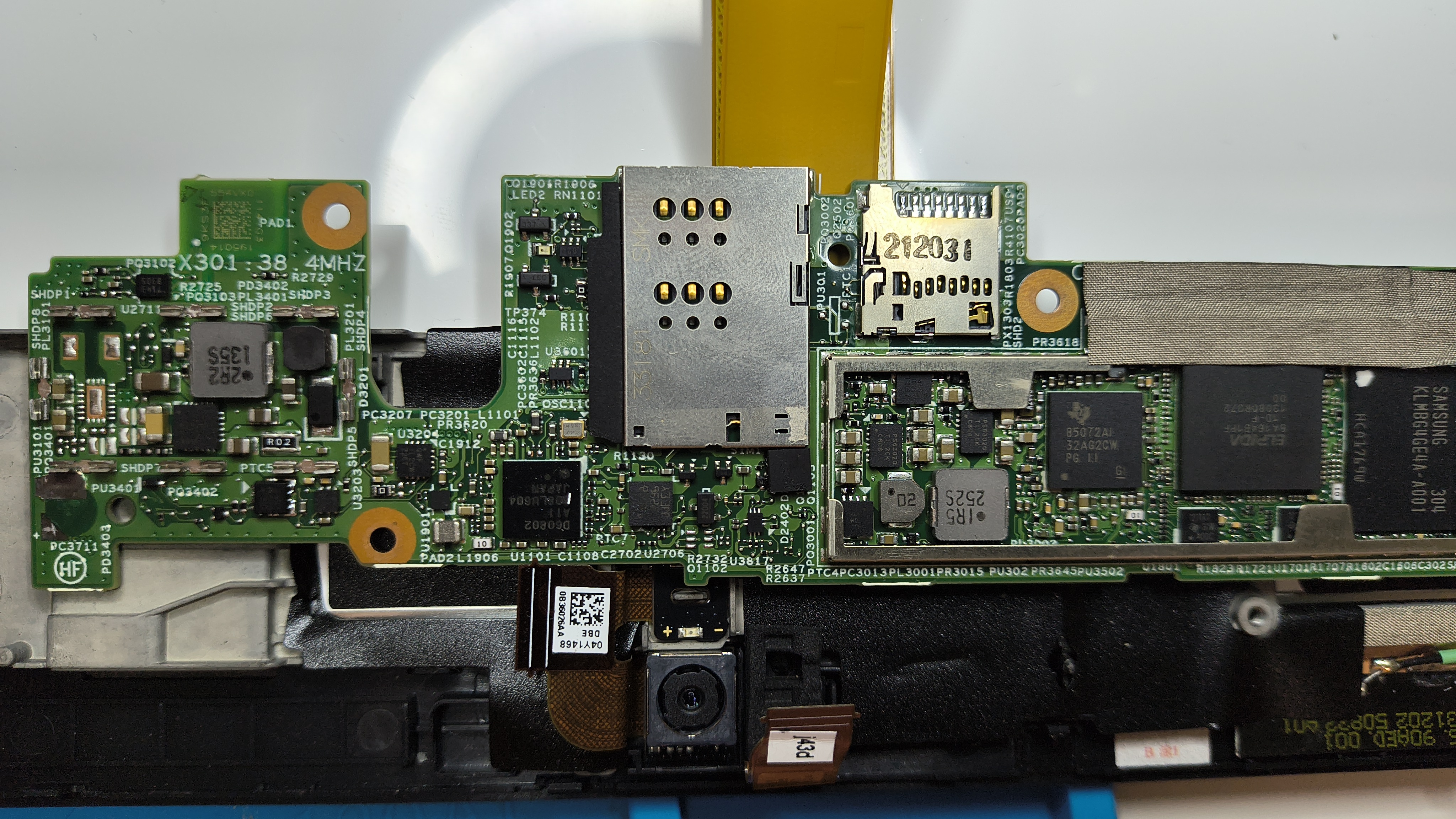

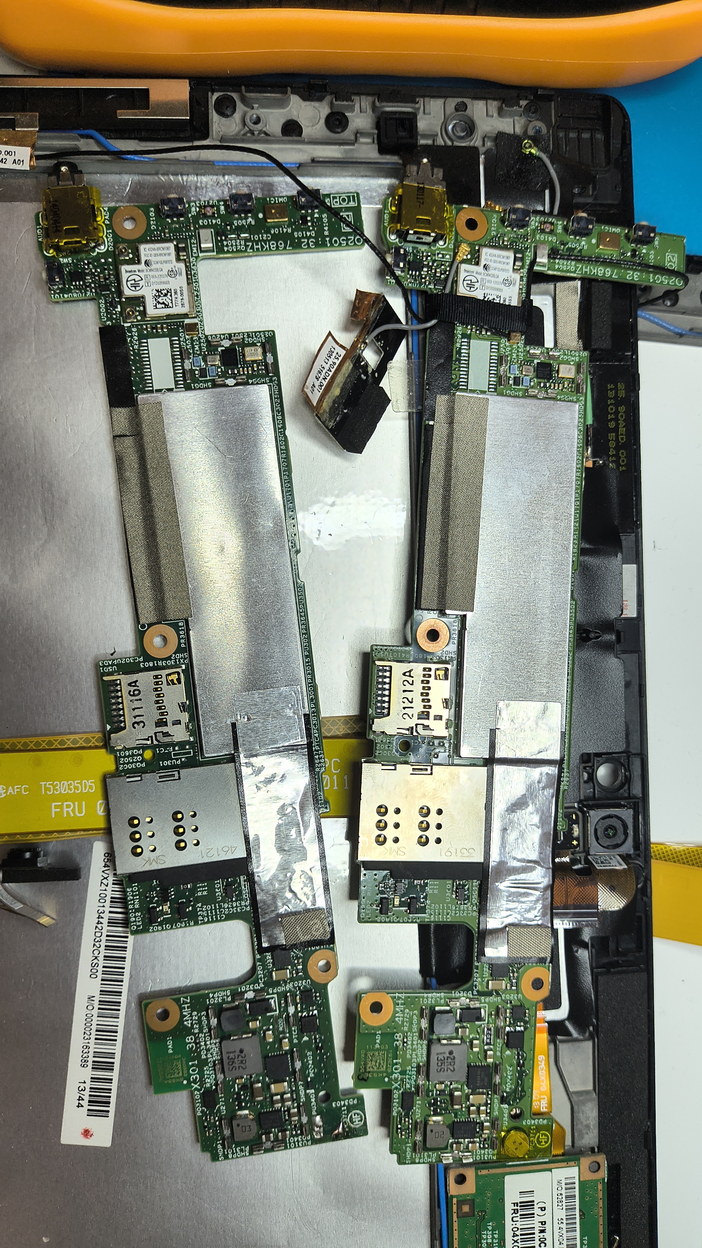

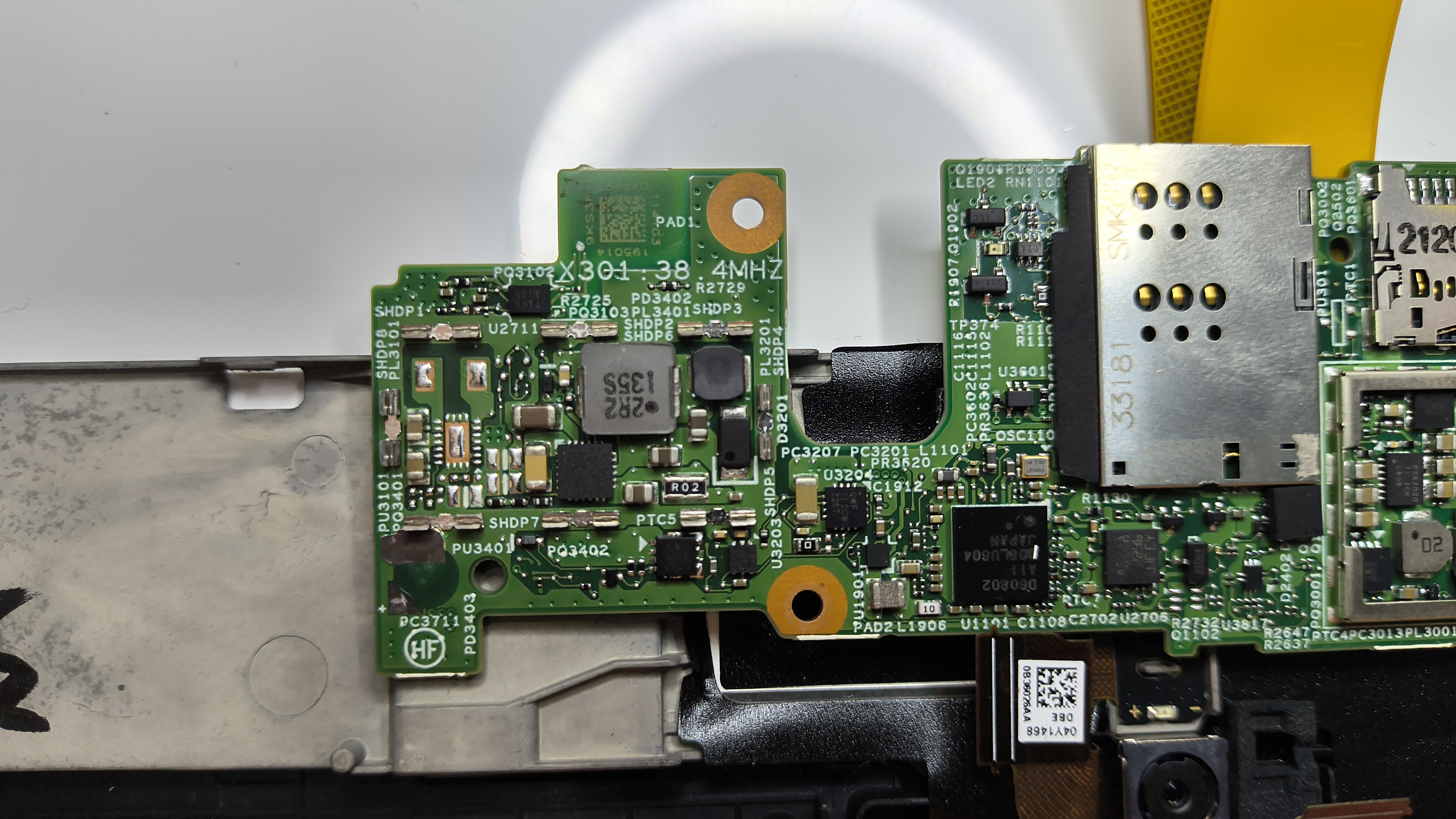

    I recently got my hands on a batch of Thinkpad Tablet 2 that a local business was throwing away. They all have the same issue, no Power.
    I do have a working one that i also took and the first thing i did was trying to power it without the battery being inserted.
    It seems that these tablets do not work unless the battery is in (my PSU is 5V5A so i doubt it's a current thing, probably design).
    I thought i'd be lucky so i took the battery from the working one and i tried it in 2-3 of the broken ones, but no luck, still no power.
    The current draw is 18mA while just plugged that spikes to 120-150mA while the power button is pressed, stays there for couple seconds, then back to 18mA.
    As they all have the same "no power", i thought that historically there could have been a bad bios deploy, so i took the working one, extracted it's bios with an CH431A flasher and flashed it on one of the broken ones, still no luck.

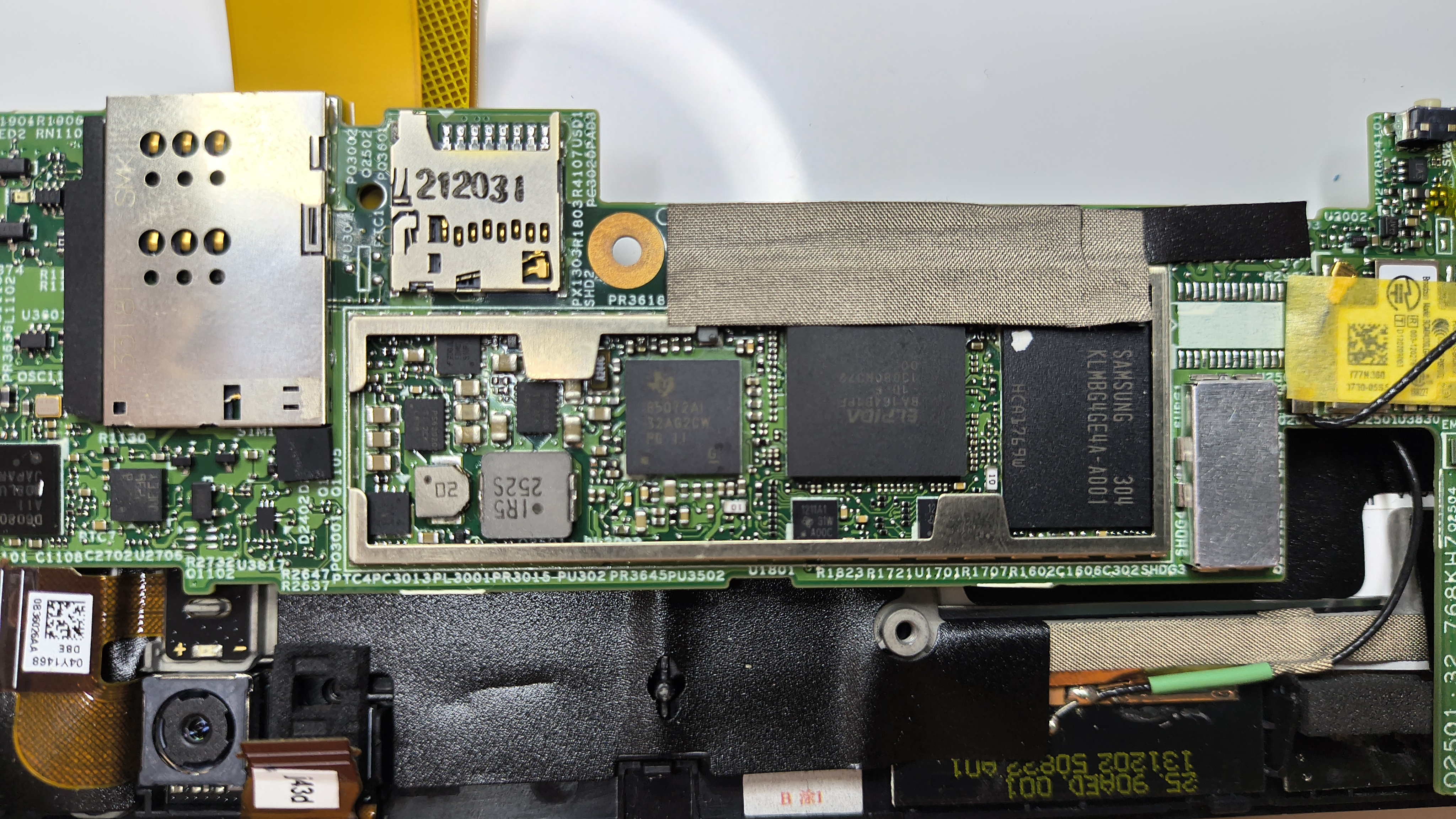

    I started probing around, the 5V is correctly transferred from the separate power board to the motherboard, and while plugged in, something that looks like a buck converter is whining, probing the diode it seems to turn the 5V into 3.8V.
    I also checked and while plugged in the battery pins are correctly at 3.7V, so technically charging should be working.
    I tried fingering around but nothing gets hot in the slightest, not even barely warm, moreover nothing looks burned, scorched or inflated, everything looks immaculate.
    At this point i'm out of ideas, i do not own an oscilloscope, just a variable power supply with current measuring and a multimeter.
    Any other troubleshooting steps i can look into?

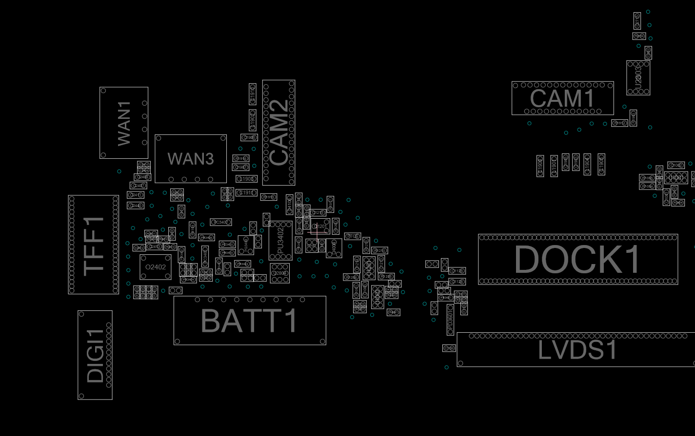

      See attached. Does this boardview look like yours?

        I cannot believe i made such mistake in the title, i just noticed the "2679" while it should be "3679". But anyway the detail URL is correct so the board pictures are too.
        The picture you posted looks about right i'd say

          Download the boardview file from here:
          Thinkpad Tablet 2 Boardview file - Badcaps

              Since you have a good working unit, this is gold. You will need to carefully measure the voltage to ground of each and every inductor (boardview will be with 'L' = coils) onboard. Make a table and location of each such inductor. Each inductor = power supply rail.
              Then pick any of the non-working units and compare their inductor voltage to ground. Stop if you have a mismatch. An alternative option is to remove all power / remove battery. Meter in resistance mode. Measure the resistance to ground of each inductor of the good sample board.
              Then compare to the non-working board. If there is a short on any of the power rails, the power supply and board will shut off due to an excessive current draw. Too much of a load condition. This 2nd approach is safer since no voltages to short with the meter

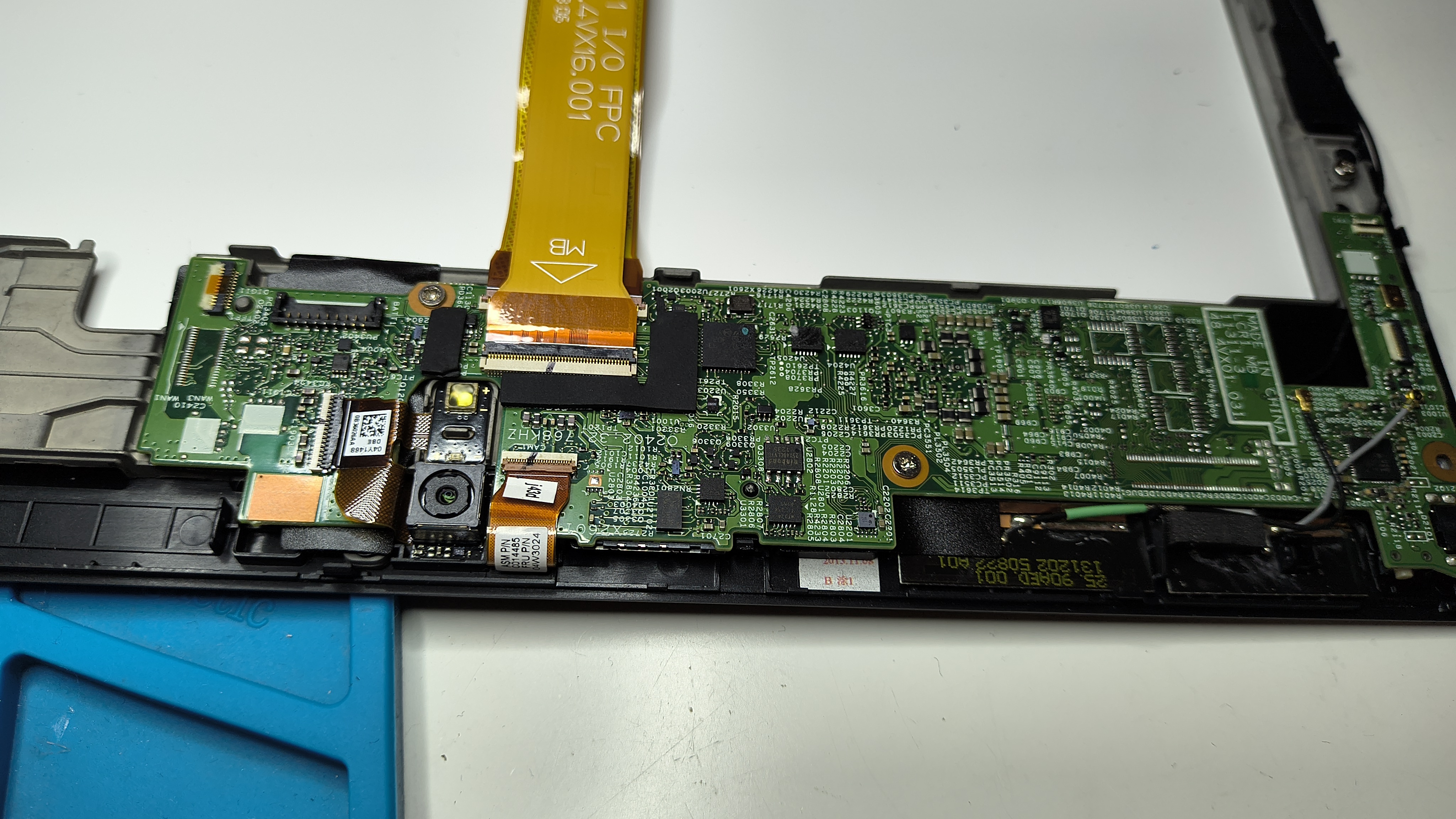

                Thank you for your reply, i tried checking every inductor on both boards and i have to say the difference in resistance to ground is pretty big.
                Code:
                Component,Working,Broken
                L2001, 324, 70
                L2401, inf, inf
                L2101, 280, 31
                L2604, 991, 1084
                L1904, 290, 32
                L1901, 1328, 1388
                L1902, 1328, 1390
                L1903, 287, 33
                OTHER SIDE
                L2105, inf, inf
                L2503, 757, 757
                L2501, 1305, 1340
                L1906, 21000, 25000
                L1101, 6.5, 6.5
                L1102, 740, 345
                i also noticed that the mask layer is a different shade of green, but the components are all exactly in the same position everywhere so i don't think its 2 different revisions.
                All the inductors with "big dip" in resistance are those connected to the V_1P80_VCCAON rail, would it be correct to guess that the short is here somewhere?

                    Today i tried with voltage injection, i hooked my power supply instead of the battery and closely monitored the current.
                    The broken board has a constant draw of 250mA, moreover i checked all the power rails:
                    1.8 has 1.82V,
                    3.3 has 3.3V
                    5 has 5.3V
                    1v (right under the processor) 1.00V
                    If there was a short somewhere these rails would not be at the right voltage, right?
                    I also noticed that very very slowly, the processor warms up, however it never exceeds "barely warm" temperature (finger wise, i unfortunately do not have a thermometer).
                    I also tried manually pulling up backlight_enable and the screen lit up with the booster correctly showing around-ish 20V.
                    I am completely at a loss, all the power rails seem fine, the booster is fine, the current consumption is reasonable, no component ever gets hot, but still absolutely no sigh of life.
                    Could anyone advise?

                            If you do please let me know, in the end i got around 10 of these tablets and the 3-4 i tested none is turning on even with 3-4 days charging with a known-good battery inside.

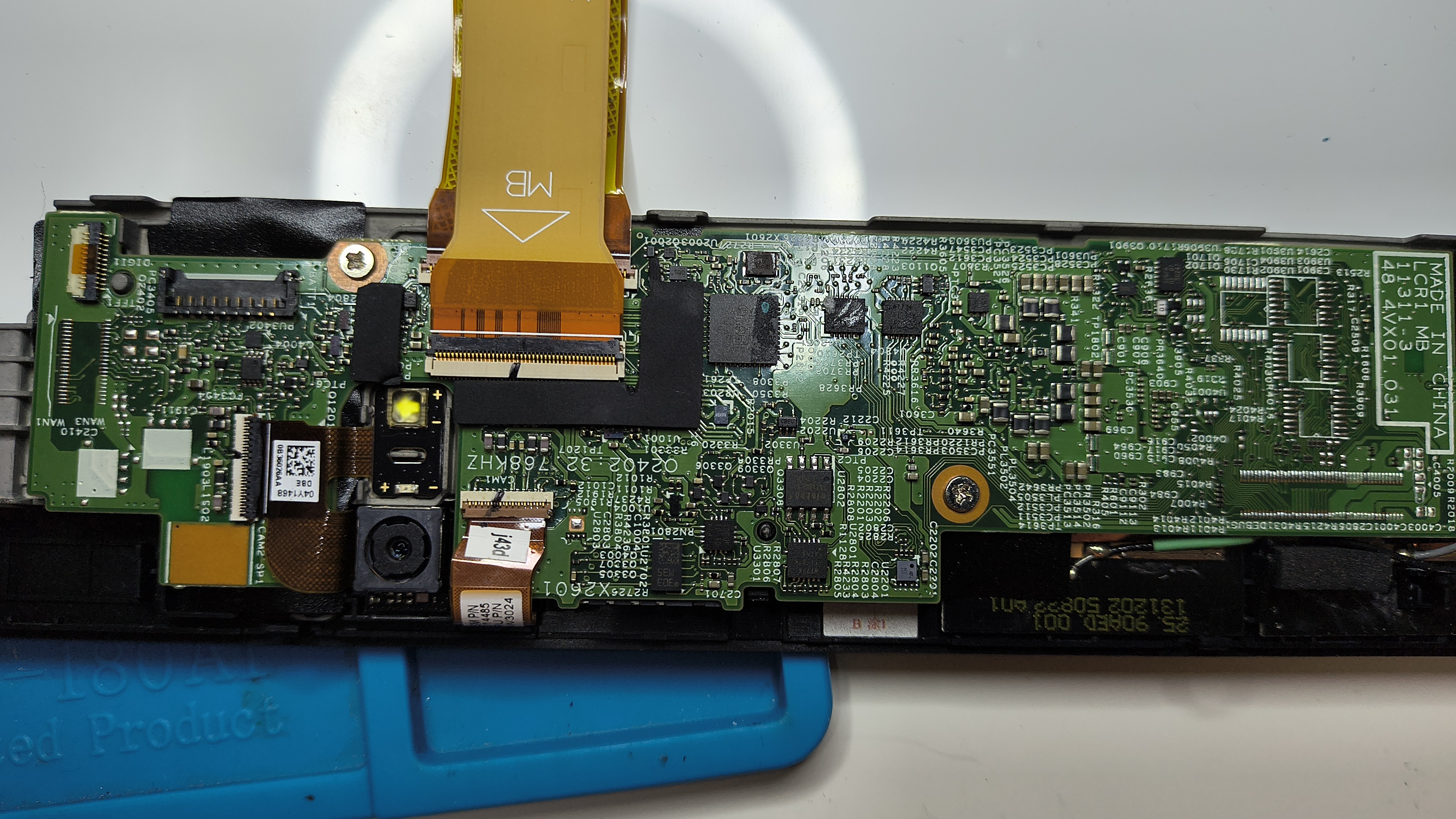

                              Good news! It's powering on with a different board. Unfortunately it doesn't seem to have OS installed, but it is powering on with the new board with access to boot menu and BIOS settings.
                              Does the battery from a non-working TPT2 get charged if installed in your working TPT2?
                              Even though this is not exactly root-causing, I strongly suspect it is the PMIC. If you have the means, replace the PMIC.
