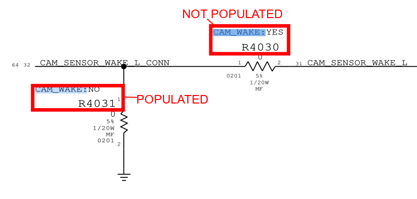

          I2C_CAM_SDA 1.79V & I2C_CAM_SCK 1.79V & CAM_SENSOR_WAKE_L_CONN 0 Volts even when the camera cable is attached to the logic board connector. So this CAM_SENSOR_WAKE_L_CONN should also be 1.79v because I am getting 1.79v on R4005 (Both sides 1.79 & 1.77V) but it's NOT reaching R4031. BUt I see in all the board R4030 in not present???? Why?? There might be a circuit break somewhere, I have to check this. Just Mon2 please confirm the voltages, am I right??? Thanks

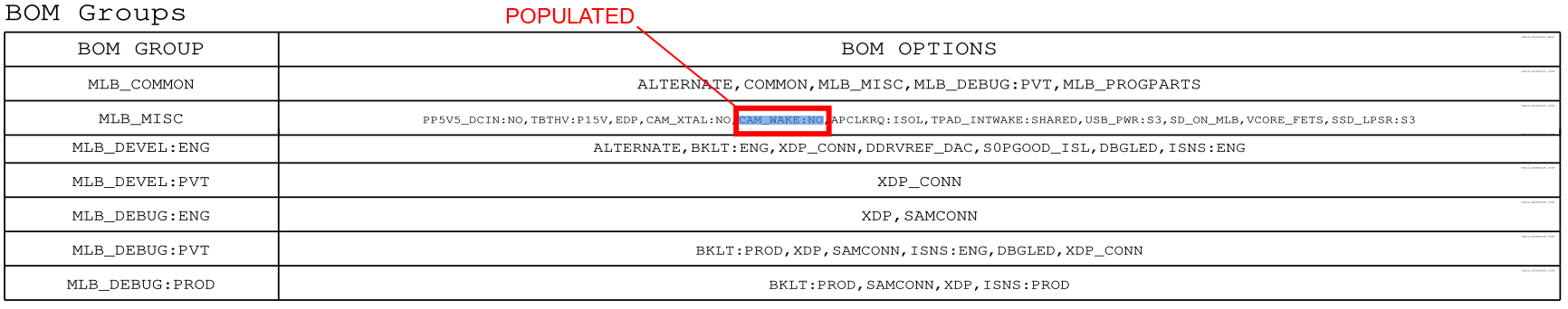

            BOM option CAM_WAKE:YES not populated, CAM_WAKE:NO populated instead.
            • mferna14
              • Jun 2018
              • 1011
              Re: MacBook Air A1466 webcam not detecting
              piernov, seriously I did not understand "BOM option CAM_WAKE:YES not populated, CAM_WAKE:NO populated instead" can you please explain in detail please.. Thanks
                • mferna14
                  • Jun 2018
                  • 1011
                  Thank you so much for the Explaination "Piernov"., really very help, so I think in the logic board which I am working the resistor R4030 should not be populated???
