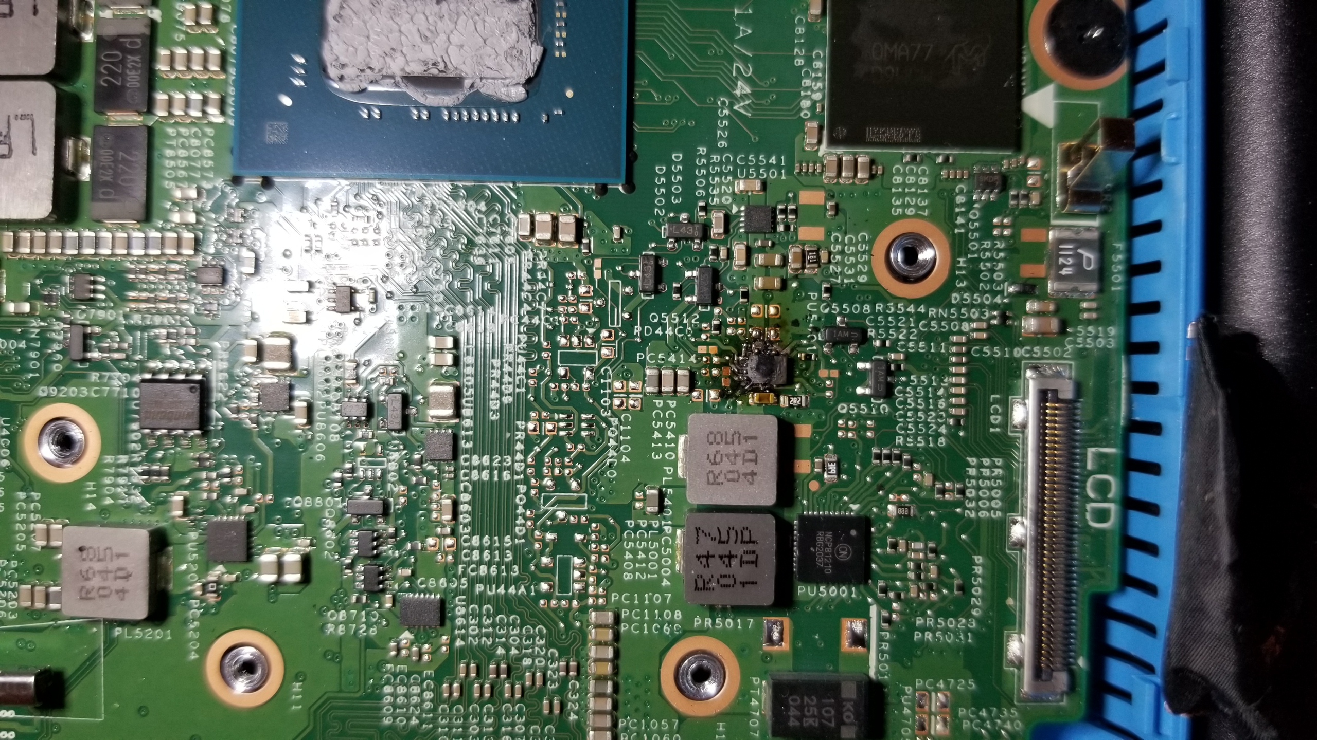

    Hi folks
    Can anybody tell me what component is this and what does it do ?
    It is near lcd connector
    Is there any hope fixing it ?
    Looks to me it is welded to board firmly

    Re: Dell g3 p89f002 burnt component identification
    Originally posted by ss45
    Hi folks
    What is the motherboard part number ,search for a schematic and boardview to help ID what it is .

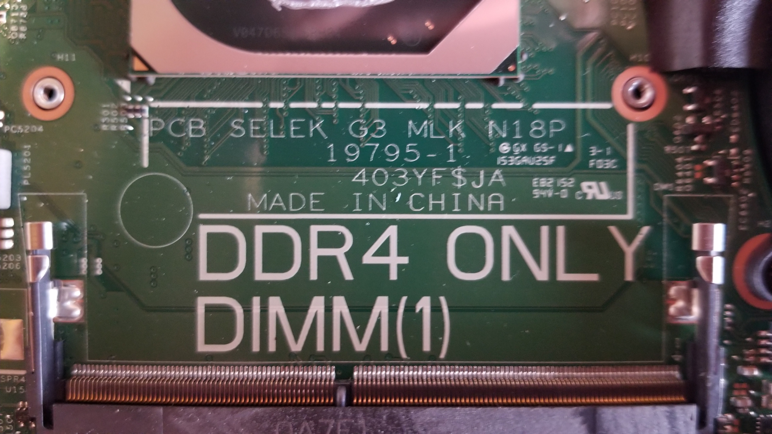

      I believe this is the board number
        Dell G3 3590 Wistron Selek CFL-H 18225-1- this schematic is there on forum. might help
          Thank you for your reply..
          Ughh this looks ugly... It supplies Vccio which is part of CPU.. so my bet is this PC is as good as ornament..
          Rant: dell why don't you put fuse at the Vin of this chip.... Cries..... End rant
          Case closed
            Sadly fuse won't help. Razer boards have fuses, high failure rate of CPU VRM ICs and CPU often dies as a result even when the fuse has blown.
              Yes, whenever an IC is blown in VCCIO/VCORE/GFXCORE on newer motherboards, SOC dies(On rare occassion it survives)
