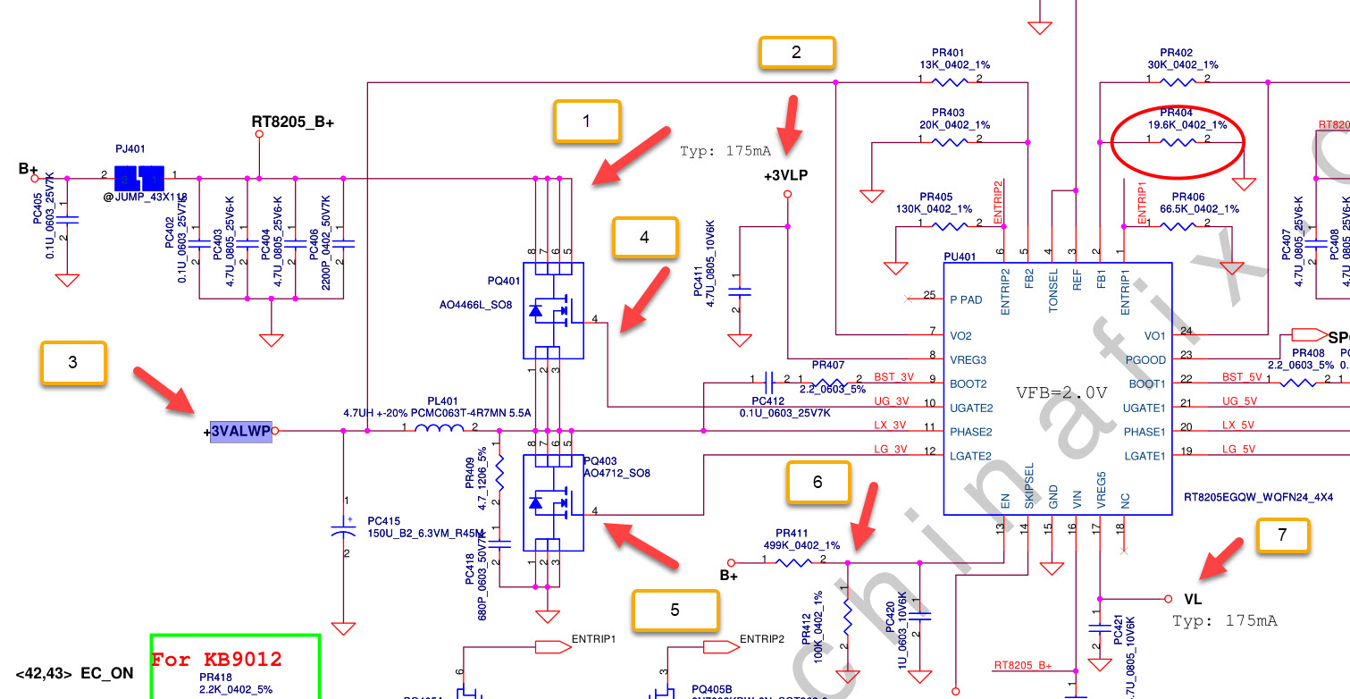

    Remove all power. Meter in resistance mode (2k scale is ok).
    Check and post the resistance for each mosfet linked to these rails:
    source (1-2-3) & drain (5-6-7-8)
    source (1-2-3) & gate (4)
    gate (4) & drain (5-6-7-8)
    Check mosfets PQ401, PQ403, PQ402, PQ404.
    Next check the gate voltage of each mosfet. Is this regulator even putting out any gate voltage ?
    Is B+ voltage present on the high side mosfets ?
    Personally do not know but how is KBC linked to this switching regulator?
    Looks like that PU401 is defective but share the above details.

                              Your +3VALWP rail appears to be absent. This rail defines the SMBUS pull-up resistor. Since the reading is 0 volts on SMBUS, most likely the pull-up resistors are not being pulled up to 3v3. Issue is with PU401 who generates the +3VALWP rail.
                              Check and post the voltages for the attached points for PU401.
                              Has PU401 been replaced before ?

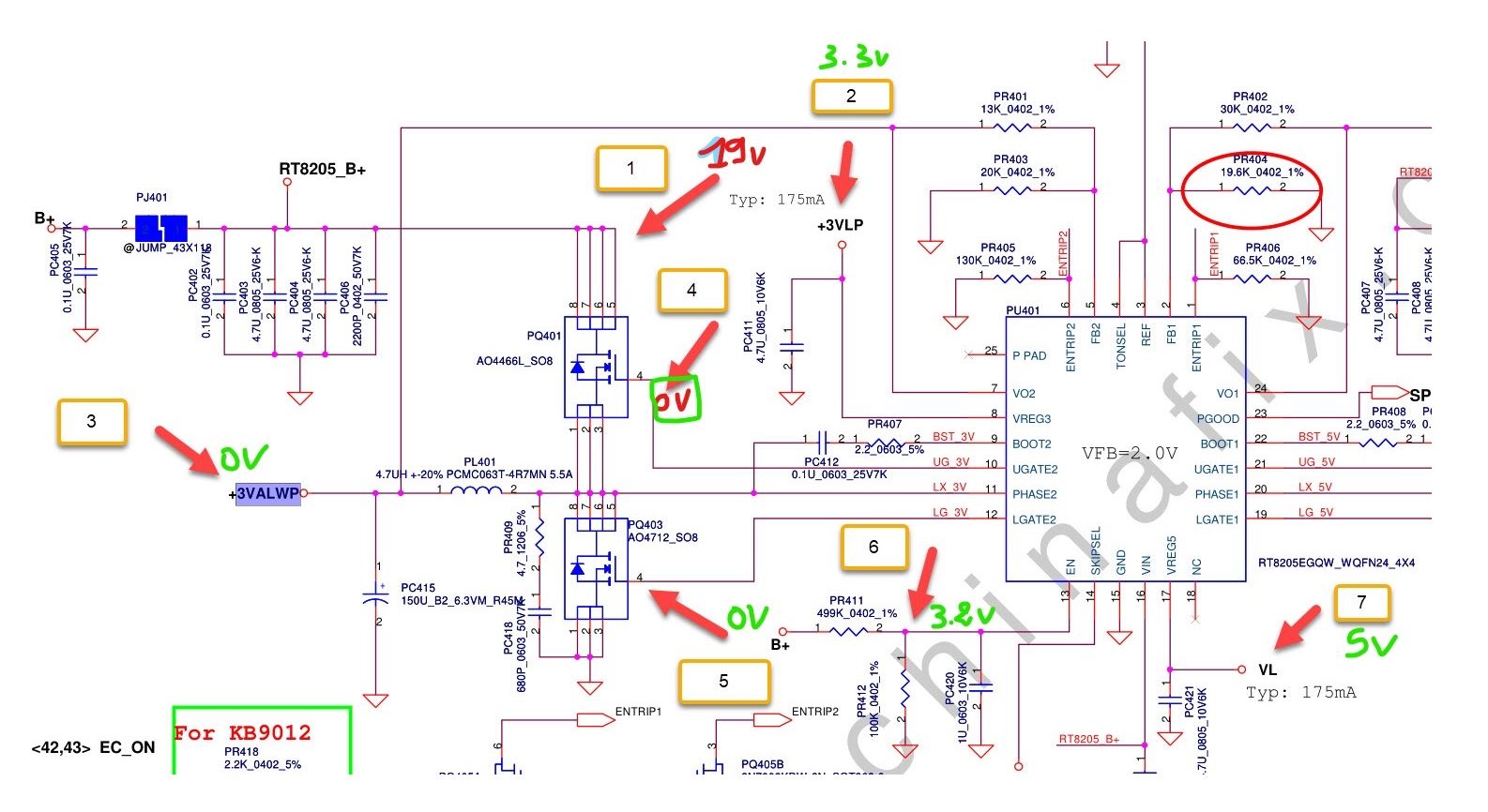

                                Re: LENOVO G580 no power
                                the readings in attachment .
                                why pu401 has all the requirement voltages but can't generate 3.3/5v ALW?
                                btw i try to replace it but same results .

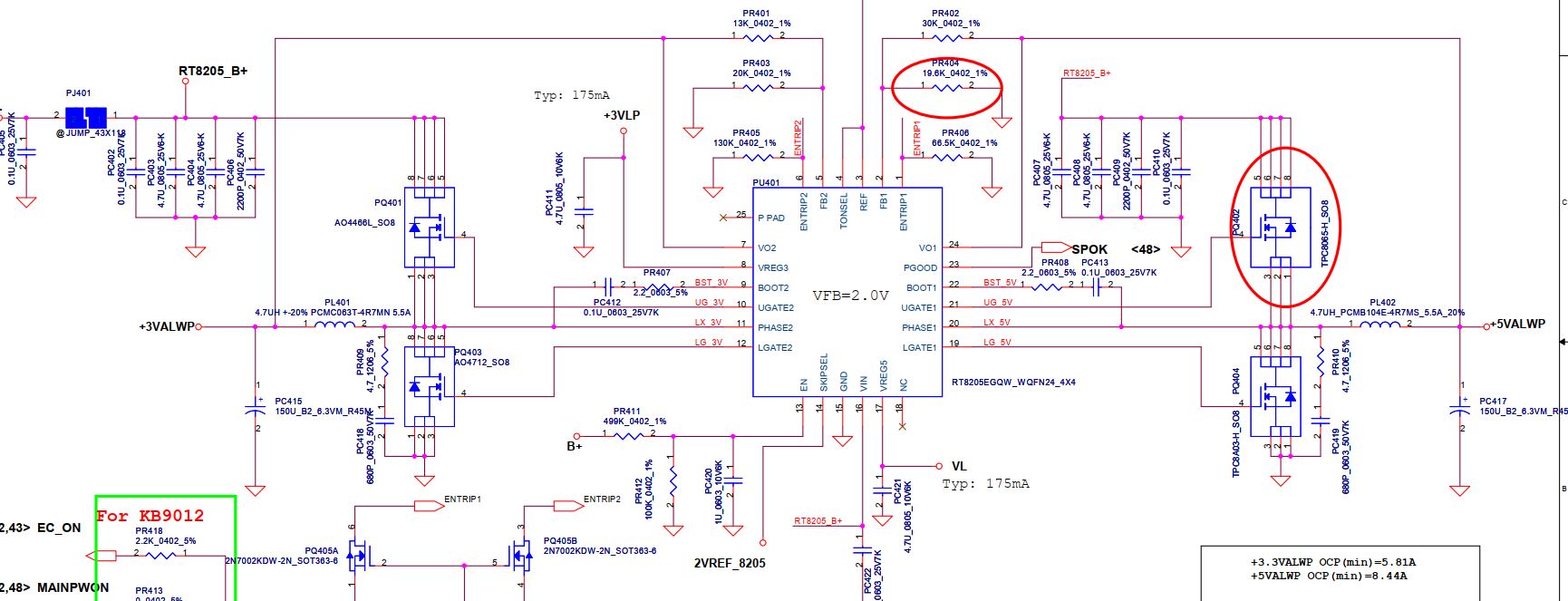

                                  There are different versions of the RT8205 part (PU401). The full part number is very important.
                                  Do you have the original part still available ?
                                  Post the pic / markings of the original part.
                                  What are the markings of the replacement part on the board ?
                                  The part number you must use is:
                                  RT8205EGQW
                                  Top markings are 'DT='

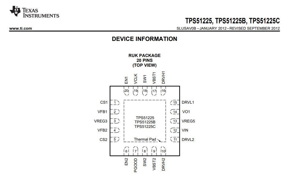

                                    I use TPS51225
                                    • mon2
                                      • Dec 2019
                                      • 14191
                                      RT8205EGQW = 24 pin device + 1 pin for the center bottom ground pin.
                                      TPS51225 = 20 pin device + 1 pin for the center bottom ground pin.
                                      Unless you have a different version of the TPS51225, they are not pin for pin compatible.
