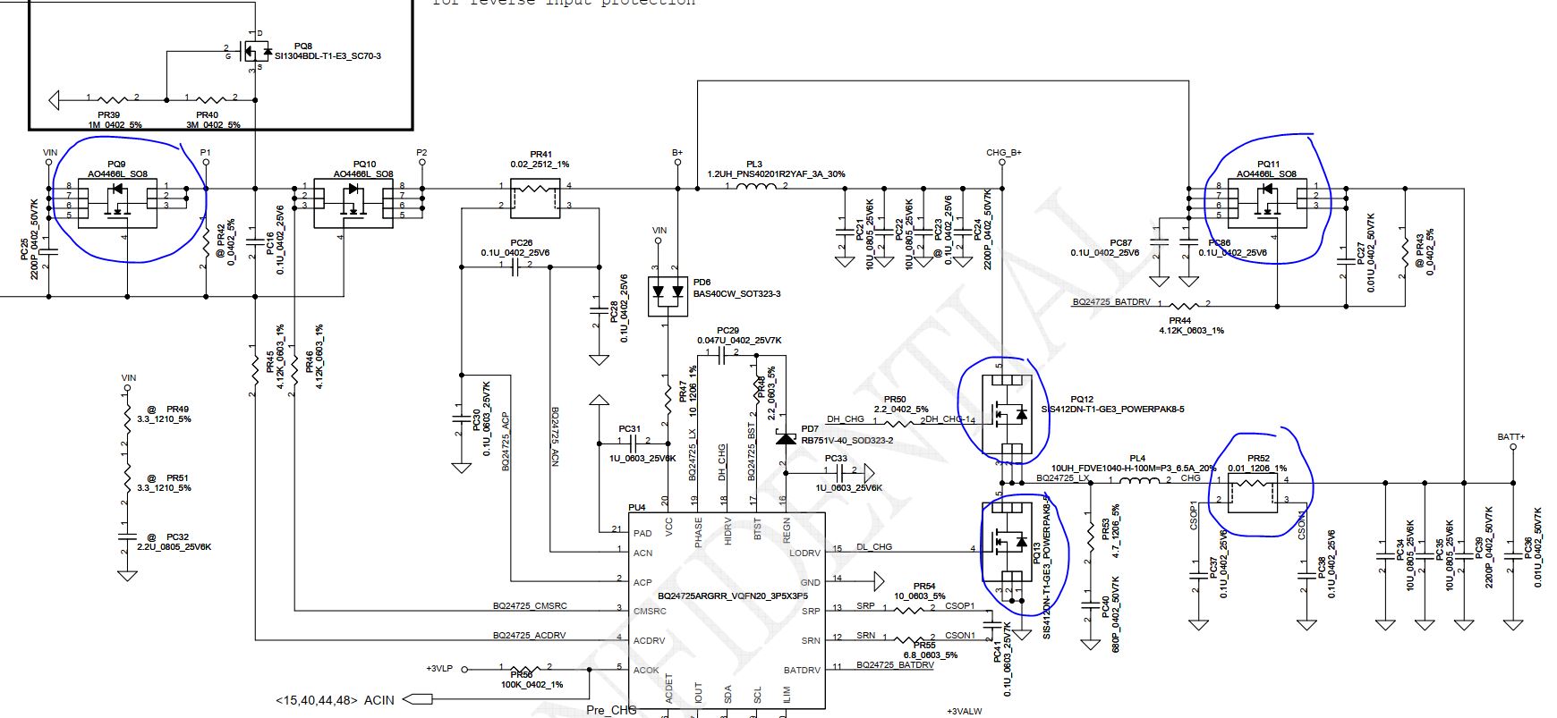

    ACER e1-531 not charging .
    hi everyone
    the laptop comes to me with water damage
    i clean it and i fix the shorted (the short not in charging circuit) .
    the laptop works fine with battery and with charger
    but when i plug in the power supply to charge the battery the voltage becomes 16 v with high amps 5A and mosfet PQ9 becomes very hot
    i change the PQ9 PQ11 and charger ic BQ25A and PR52 and pq12 pq13 witout any change .

    Remove all power. Meter in resistance mode (2k).
    Check resistance of:
    source (1-2-3) & drain (5-6-7-8)
    source (1-2-3) & gate (4)
    gate (4) & drain (5-6-7-8)
    for each mosfet. Low readings are of concern.
    Which exact mosfet was used for PQ9 ?

      PQ9 (S-D) 0 ohm (S-G) 5 ohms (G-D) 5 ohms
      PQ10 (S-D) 0 ohm (S-G) 5 ohms (G-D) 0 ohms
      PQ11 (S-D) 0 ohm (S-G) 0 ohms (G-D) 0 ohms
      PQ12 (S-D) 0 ohm (S-G) 0 ohms (G-D) 0 ohms
      PQ13 (S-D) 0 ohm (S-G) 0 ohms (G-D) 0 ohms
      PQ9 mosfet AO4496

        Wow. From the posted resistance values, each mosfet appears to be defective.
        Try the following:
        a) remove PQ9 off the logic board. Then measure the resistance again for the removed mosfet. Are the readings much different of the removed component ?
        b) with PQ9 removed - check the resistance of the PCB pads where PQ9 was soldered.
        Post the values of PQ9 (when it is not on the board) & PCB pads with PQ9 removed.
        Do not power up the logic board.
        c) Did you replace only PQ9 with the AO4496 ? No other mosfet has been replaced ?

          the problem solved
          i replace pq9 and pq10 with AO4456
          the laptop charging fine
          thank you for help .
