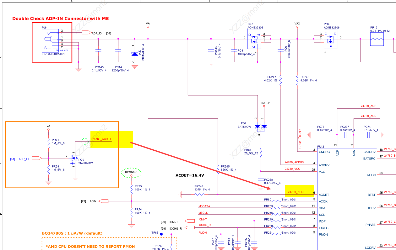

                Only if these resistor values are of the proper resistance, proceed to flux and remove the 2N7002 @ PQ9. This mosfet is shunting the ACDET pin voltage to ground and resulting in the no charge condition of your logic board.
                Continue to post your progress, either way.
                Sharing a partial schematic of a similar board by Acer.

                  mon2 it seems you missed the important info provided by OP. REGN is missing whereas VCC is present. So clearly the BQ ic is defective.
                  Another question .Was the original ic BQ24780 or BQ24780S? You need to replace with exact suffix.

                    BQ24780S is the original IC and I was replacing with BQ24780.
                    I found the exact suffix with S and replaced.
                    Laptop is fully operational.
                    Thank you very much.
